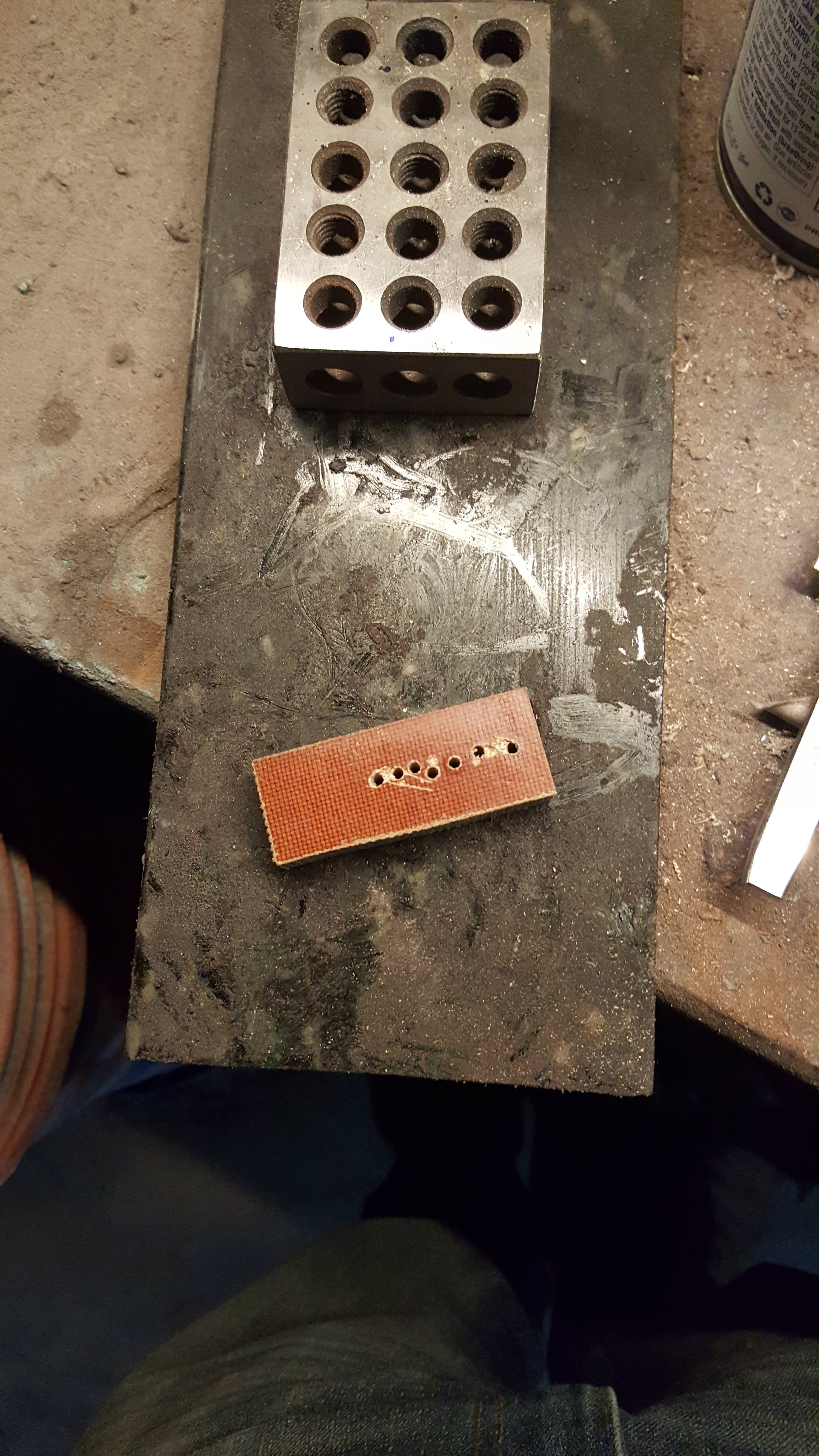

Tried drilling some holes in a line. Sounded good in theory bit I have no file small enough to remove the material in between. Scrap that.

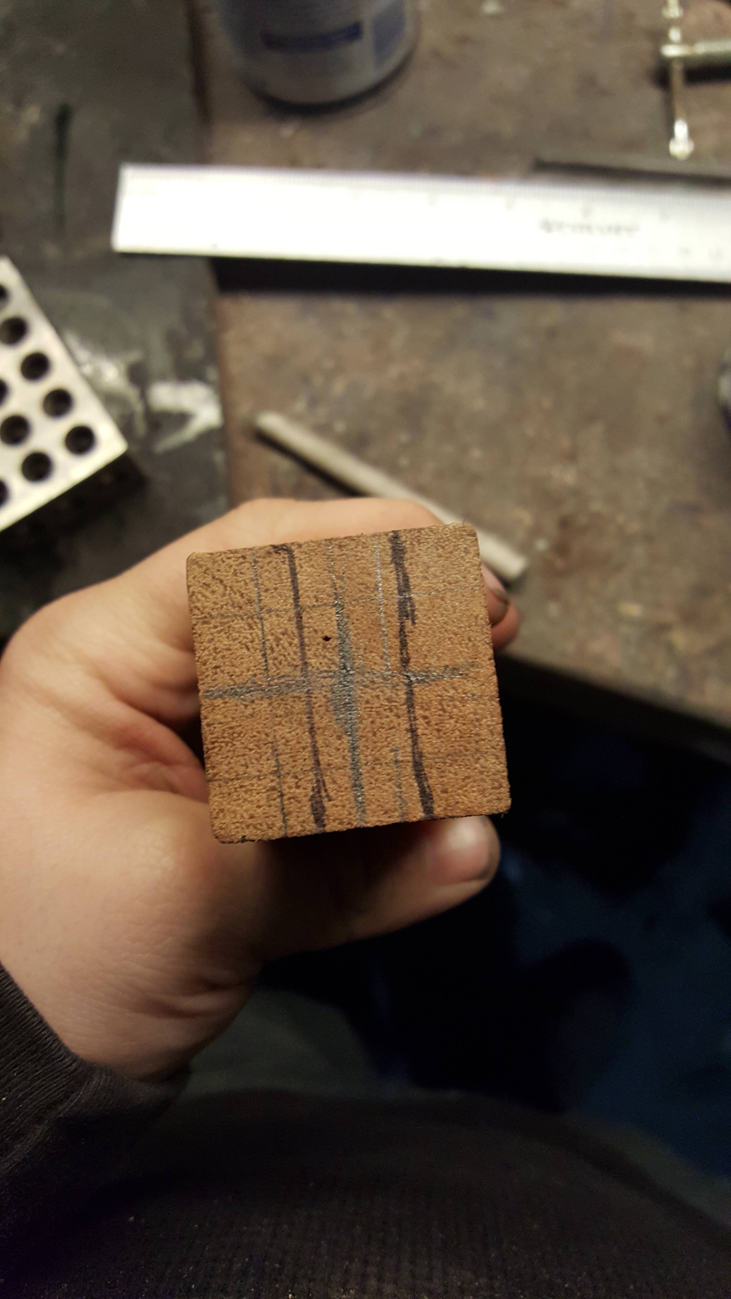

Here is the piece of wood in currently on
Marked center and the black lines are the width of the riccasso.
Don't worry about the other lines.

When I do really thin knives, like a 1/16” kitchen knife, I clamp my g-10 in my file guide and drill it with the bit resting against the guide. It helps to have 1/16” or 1/32” matching material to use as the face of the guard. Once drilled, you can use the bit as a file and connect the dots. Go from bottom to top to help prevent the bit from wandering. I’ve got a selection of needle files, and custom ground sawsall/jig saw blades as well. If you don’t have a file guide, use a hardened piece of any steel you have lying around.
If you have a mill, you can use a slitting saw to quickly cut the slot.
Glue the thin front to your guard after you file the guard open a bit oversized with Krazy glue or polyurethane glue. If the guard is black, j-b-weld will work. The joint is barely visible.
I’ll take some pics of my next fitup for the stickies. Most of the pics are gone now. With 1/8” or over, slotting with a mill is super easy. Thinner, and broken end mills are an issue unless you know what you are doing.

If you are fitting the guard, then yes, drill smaller and file it open. Do not file until the guard fits against the ricasso shoulders. File until the guard gets within 3/8 or so from the shoulders then press fit. This will cause the guard to deform around the hole and take the shape of the tang. It also raises the edges which will need to be sanded flat again. If there are any gaps you will need to carefully peen the guard face around the opening to spread material there to fill the gap. Press or hammer the guard on again and check the fit again. Repeat until you have a seamless fit around the tang. Keep in mind you'll need to put a radius on the short sides where it mates with the radiused shoulders at the ricasso. When the fit is perfect, refinish the face of your guard to remove any dimples from peening.
If you are drilling out the tang pocket in the handle, you can use a slightly oversized drill. A .125" drill is fine for a .120" tang. You want a little room for the epoxy.

Slot the guard a bit oversized, and use a thin sheet of the same material for the face of the guard. Clamp the thin sheet in a file guide, or against hardened steel to line up the holes. It’s much less time consuming to use fine files to fit 1/16” or 1/32” stock to a Press fit. Once the face is snugly fit, glue it to the front of the guard. This only works with synthetic materials, or wood. It won’t work with steel, stainless etc.
With steel or stainless, I mill the back of the guard 1/16” oversized, down to within 1/16” of the front of the guard. The front gets precision milled, or milled slightly undersized to the tang, and opened with fine files until press fit.
