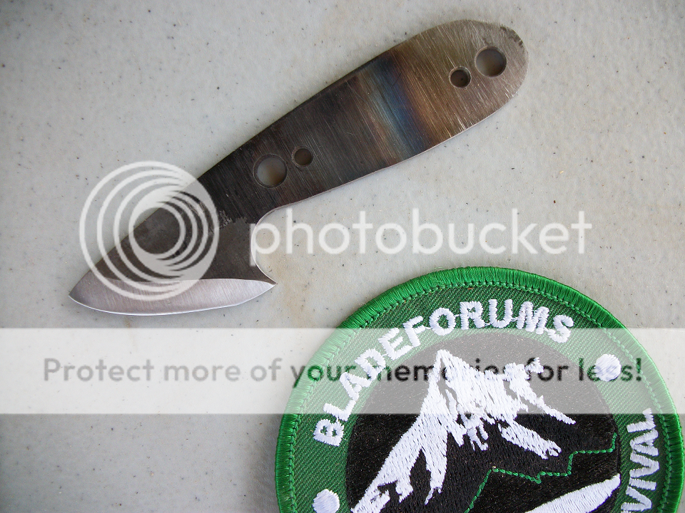

Pit, got your designed profiled out, and heat treated. I added some extra holes..... hope ya don't mind, and I made it out of 3/32 1095. Heat treat will be a hardened edge with a spring temper back.....
right on Mark.. looking forward to checking this out...:thumbup: i always loved the idea/concept of a PSK/gig/knife.. i'm sure i'll want one too....:D
here it is .....
covexed edge and grind, razor sharp... left this one a tad rough I guess, I could run it over the belt machine and make it pretty it ya want....
With the extra holes you can use screws to fasten it to a pole, or wrap with para-cord....

here it is .....
