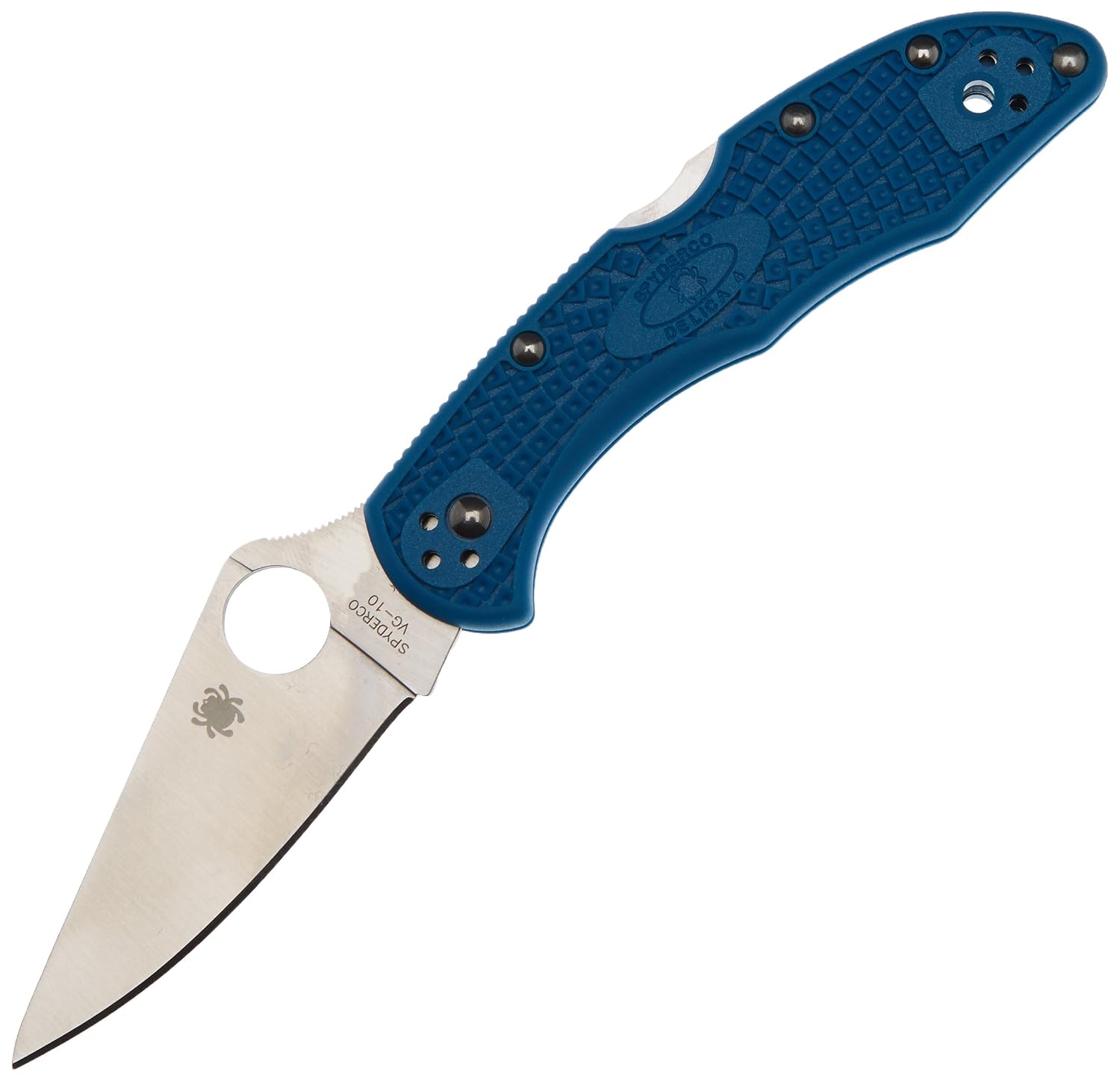

I am prolly not the first to address this topic. Anyway here is my take.
I don't know about other Spyderco blades but OOTB i don't agree with how edge and plunge line are ground, nearing the ricasso of the Paramilitary 2, Delica 4, and Endura 4 blade: that spot/area looks untidy, unclear, messy, complex, complicated to me, causing four issues A, B, C, and D. I never understood why it was ground like that:
The lack of a sharpening notch would be acceptable to me, if that problematic area had a primitive geometry. Primitive geometry is preferred if i want to resharpen every(!) millimeter of the edge conveniently and don't want to run into sharpening trouble sooner or later. In the end my concerns/efforts all boil down to preventing the development of a growing recurve section near the ricasso and not cutting into the edges (corners) of my expensive whetstones. This is can be achieved with a cleanly cut whetstone (like the Spyderco 302UF) as long as the geometry is as primitive:
On my PM2 i also added a gratuitous mini notch. For an improved sharpening experience any blade imho should have one of the three alternatives:
  1. sharpening choil (for trouble-free sharpening)
  2. primitive geometry + sharpening choil (for trouble-free sharpening)
  3. primitive geometry (for best cutting performance)
I am for sure not the first to have done this reasonable mod! There are some reasons why other PM2 owners wouldn't do a similar mod:
On the Delica4 the questionable spot is on a smaller scale:

Advantages of the mod:
  1. longer cutting edge (max possible length, no wasted millimeters!)
  2. one can "cut cardboard with the ricasso", i.e. use the ricasso as stopper and then as support when gliding (slicing) through the sheet of cardboard. this gives noticeable improved cutting performance! (well, as long as there is no sharpening choil o_O)
  3. trouble-free sharpening, no damage to the whetstone
  4. elimination of recurves, prevention of any recurve formation
  5. geometry looks clear, comprehensible, simple, beautiful
Disadvantages of the mod:
  1. creates new stress points, weakens the structural integrity because material is removed
  2. modded knife is not original mint anymore; reduced resell value

Hah :p the thread is to show that those Spyderco blades don't need sharpening choils. Since there is nothing to catch on, the blades without sharpening choils do perform better, especially if the entire edge up to the ricasso is sharpened.

The untouched knife's recurve does cut into the reactangule edges of the whetstone, so the mod was really necessary here. And if you avoid the recurved portion when sharpening, you only grow the recurved portion over time. I've experienced it.
I don't despise sharpening choils. But i do despise recurves!
