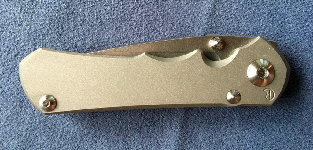

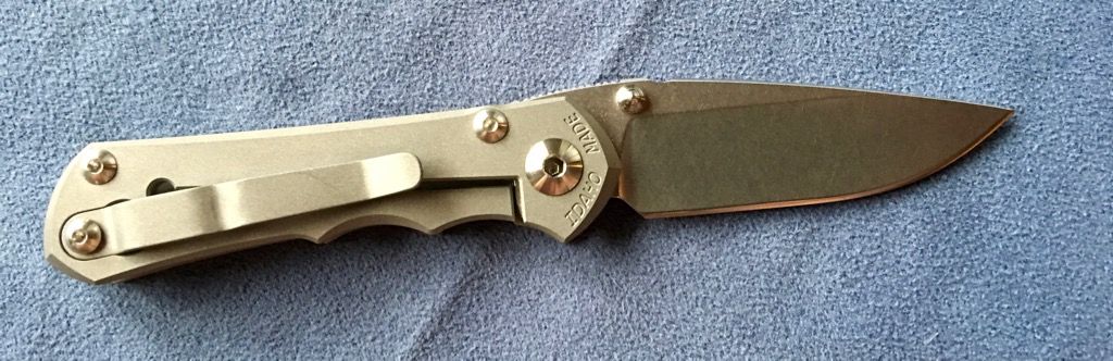

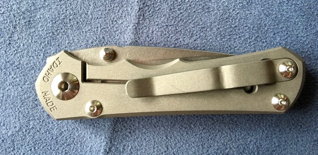

Has anyone polished their lugs silver yet? Don't think I've seen a pic of any but starting to get a wild hair to bust out the Flitz on mine. Would love to see how yours looks.
Mine has factory silver lugs. It had to go back to HQ and while it was there, I asked them to install them.
That looks sweet. May I ask why you had to send yours back?
I don't mind the blue, but I've got it on two other CRKs. A little variety is always good.
I had a sticky lock that they felt needed a blade swap. I couldn't be happier with both how fast and well they took care of it. Very happy with this knife!
Those silver lugs look great on her! That's the version I want too, just waiting for TNK to get them in, hopefully soon?
