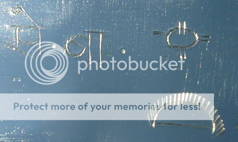

I think all the factory data and UB are all on the right side of the blade (spine up pointed away). All makers marks on the left. I believe the sun with the double marks are on the Kami "territory" of the blade. If you want to send me that Indonesian dha by Bura I promise ill give you a full unadulterated review of its origin but It might take thirty years to complete my examinationI am pretty sure the sun with double spokes represents the shop itself-- and yeah kadka blades always baffle me as they seem devoid of any clear markers ;x

I think all the factory data and UB are all on the right side of the blade (spine up pointed away). All makers marks on the left. I believe the sun with the double marks are on the Kami "territory" of the blade. If you want to send me that Indonesian dha by Bura I promise ill give you a full unadulterated review of its origin but It might take thirty years to complete my examinationIm not sure when Sgt Khadka left HI but if it was before Uncle Bills passing then I suppose there would not be any markings identifying his blades. Im just going on naming conventions and taxonomy that Ive read in history but there may be exceptions? Oh I could probably complete my investigation on a Falcata sample as well. Feel free to submit either for evaluation
sawgrass that probably means you are lucky enough to have some khadka blades as I understand it took them some time to get him to mark them? steve could chime in on this, but there have been a couple of blades like that --- I have a tiger knife that is simply marked HI with no kami mark as well, still dont know who made it![]()
There are four Devngari and one English marks on all of HI Khukuris and Swords.
I Knife maker's intinital.
2 Knife maker's personal sign. Each Knife maker has different sign.
3 Star is a mark designating Himalayan Imports Knife makers.
[Note: see photos below]
4 UB designates Uncle Bill. When Uncle Bill last visited with the Kami's he asked them to mark all the Knives with UB after he passed on.
5 HI logo is for Himalayan imports company.
KAMI SIGN AND MARKS

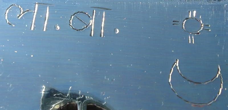

Bura - Crecent Moon
He is still working for us

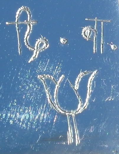

Dil - Lotus flower
He is still wrking for us
Yuvraj - Light ( Deo batti in Nepali)
Vim - Nepal flag
He works part time for us
Rajendra - OM in devengari
He is new kami in the shop he will continue to work for us
Kesar - Rising Sun ( pre 2002), Flag (Post)

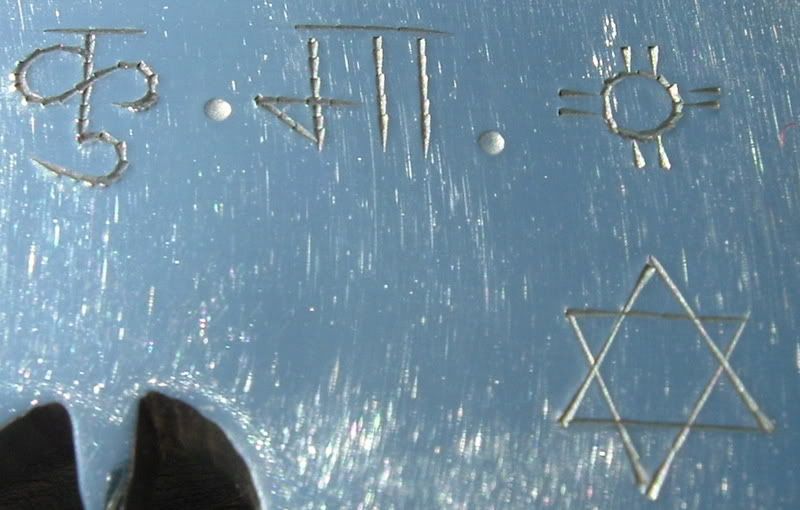

Kumar - Star of David
He does not work for us

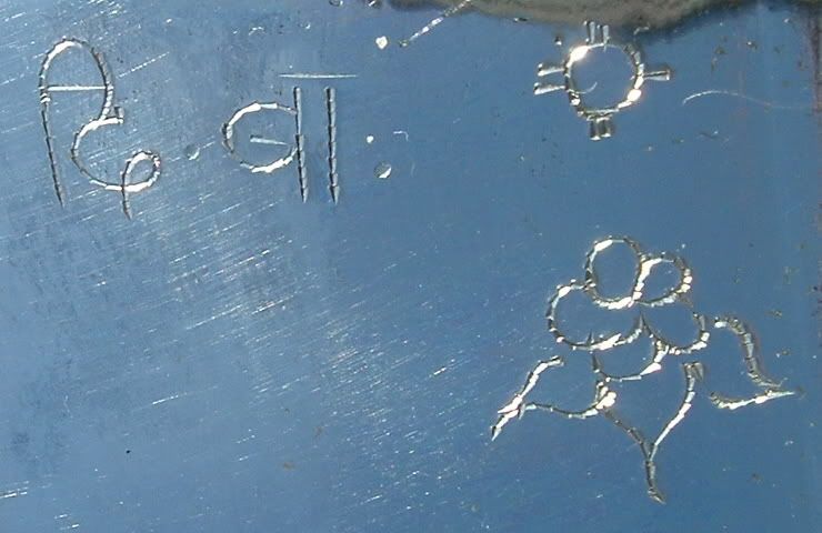

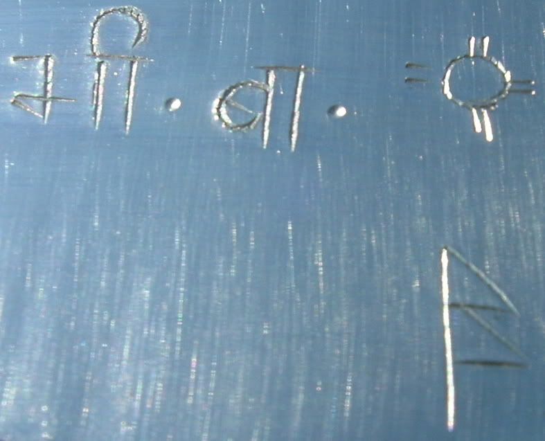

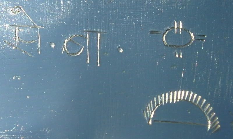

Here are a few pictures I have of mine at the moment.
Bura
Sher
Kumar
Vim
Dil (first one is his early mark)
SGT does not have a mark and does not work for HI, sometimes HI buys his kukris to sell.
