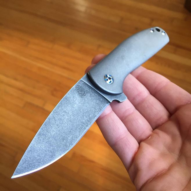

This is the knife in question, incidentally, and it's one of my favorite and most-used knives:
Increasing lock bar tension by bending the lock bar in slightly results in a stronger detent, allowing for better flipping action. My Ki423 (this is what it says on the blade, but it's also known as the ki4423) arrived with a weak detent and poor flipping action if you weren't careful. After taking it apart and increasing the bend in the lock bar slightly it has flipped like a rocket ever since. It snaps open with authority now, to the point that it annoys my wife when I idly play with it.
