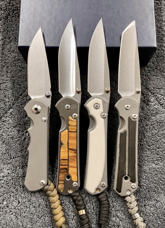

Ive found after carrying and using MagnaCut that I greatly prefer it over S45VN for sharpening, edge retention and chipping but If Im honest I still really like and maybe prefer S35VN as an all a rounder. I really like the toothy edge I get with the 35 and it never chipped on me like the 45 did, at least in CRK knives.
I was quite impressed by how readily the magnacut responded to the strop. I didn't do a whole lot of cutting when I had yours, but I did enough to have dulled out other knives.
I've not found the s45vn in my small particularly difficult to manage, and I've only chipped it once. Factory edge, cutting a bunch of landscape fabric that had gotten wrapped in the cutter head shaft of the stump grinder.
Does magnacut justify a new knife? Sure does if you want and can afford it.
This is hardly scientific, but here's some anecdotal evidence. I think the Magnacut offers a boost in edge retention when compared to s45vn and s35vn, specifically in drop point large Sebenzas. I'm aware of the CATRA charts, so we will chalk this up to heat treatment.
