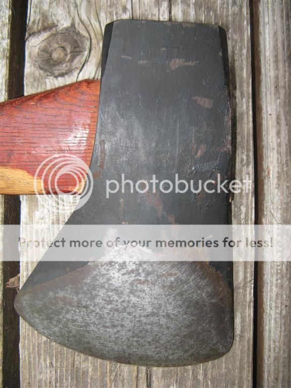

So I went to swap meet today and found a raft pattern hatchet made by plumb.
I'd call it a cedar pattern but they still have the beveled poll like rafting axes have.
From the small chips on the face I would assume that the poll is hardened and has seen heavy use. Nice hatchet!

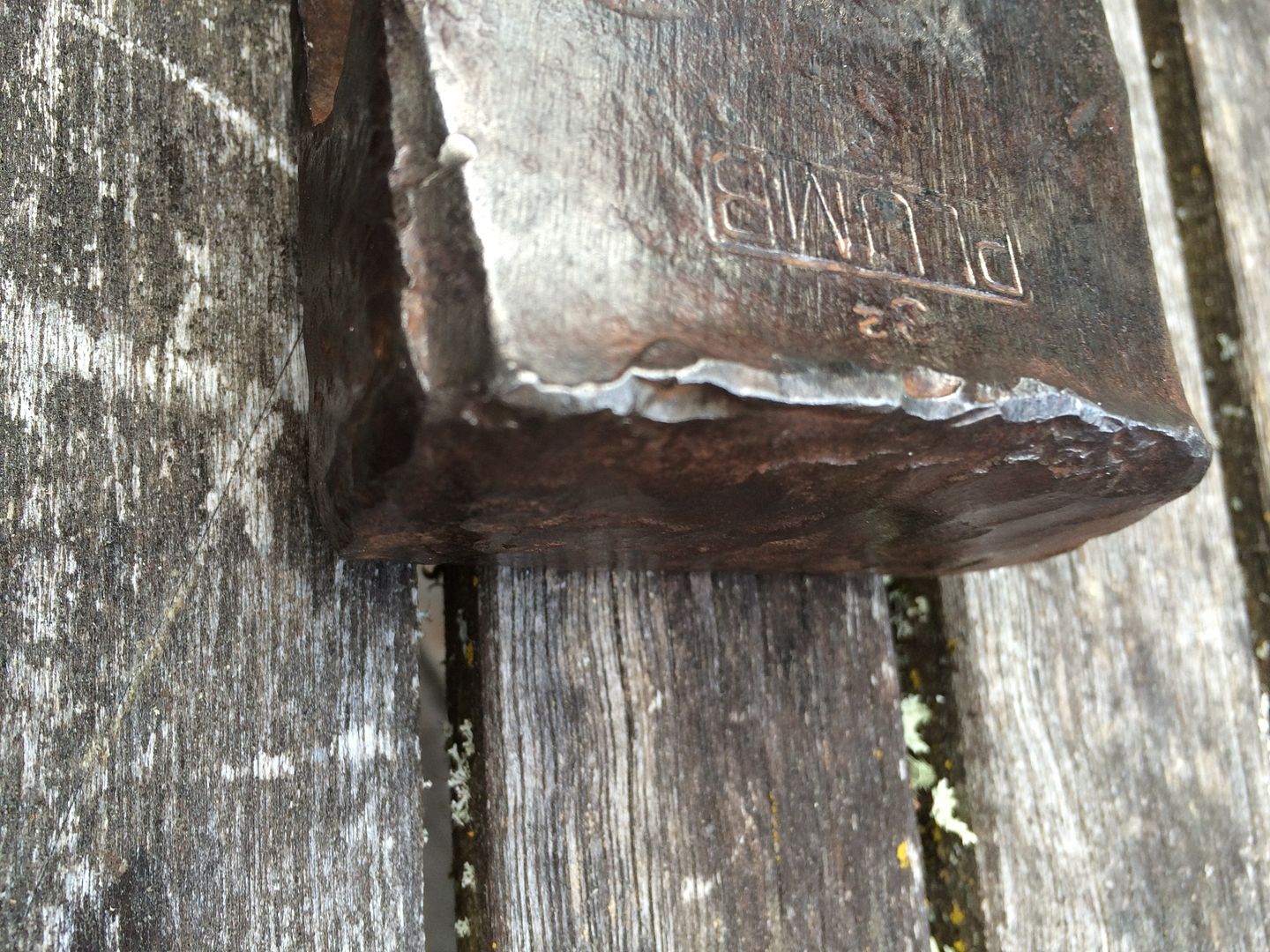

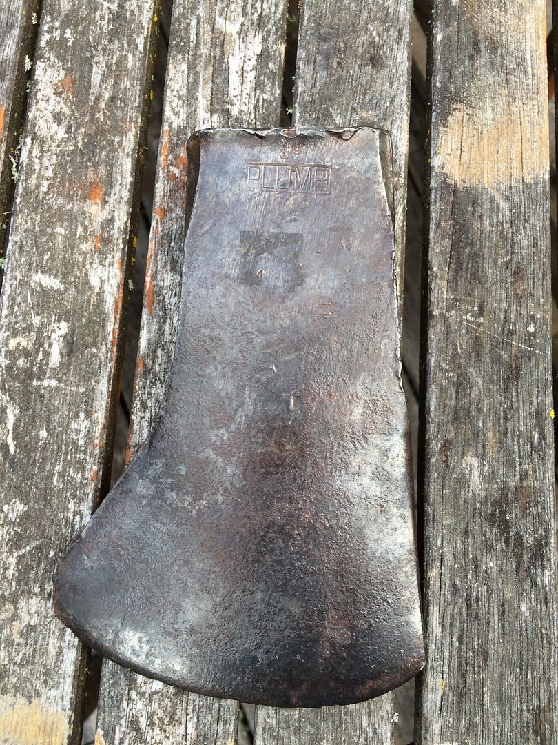

Here's a virtually un-used Cedar pattern marked 3 2 PLUMB on the unconventional right side and without a Permabond eye. In other threads Steve Tall has posted Plumb ads from vintage Boy Scout and outdoor magazines and I can't help but notice that many of the hatchets and boys axes featured in them also show bevelled corners. It would make perfect sense for Scouting-endorsed utility hatchets to have hardened polls because pounding tent pegs, amongst other things, at Scout Jamborees and camps was a routine activity.

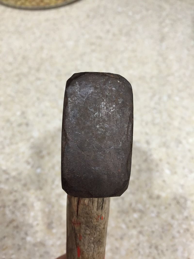

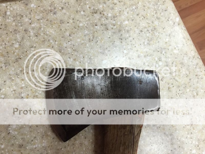

Since this is focus thread. Here is a Plumb 3.2 that I have. Like 300six’s above, this one has markings on the unconventional side. Do bevels indicate hardened polls the majority of the time?
This one looks like it was used more as a hammer than an axe. It has mushrooming and a couple of chips out of the poll. It’s also marked “11” on the eye and another “1” (possibly another number next to it)set at a right angle to the “11”.
Does it look like a “rafting” ax that got used hard or does the damage look more like an unhardened poll. Just on first look I guess – haven’t taken a file to it.

Thanks for this. That's enlightening!. I guess there's more to visual indicator cues of identifying tempered polls than meets the eye. Hardened polls aren't supposed to mushroom! Your and my axe are the exact same critter except the one I have has never really been used and the poll is still perfect. A file bites on a corner but no different than it does at the blade end. Square_Peg's pictured rafting Walters exhibits deformation; I wonder if this sort of thing is from half century of constant use (my 45 year old Estwing hammer doesn't have an unspoiled face anymore either) or whether the degree of hardness might have been relaxed somewhat at poll ends.
By the way on mine the factory black paint is rather thick and even the 3 2 and PLUMB is hard to read so if there are cryptic numbers elsewhere they are obscured enough that I haven't found them.
