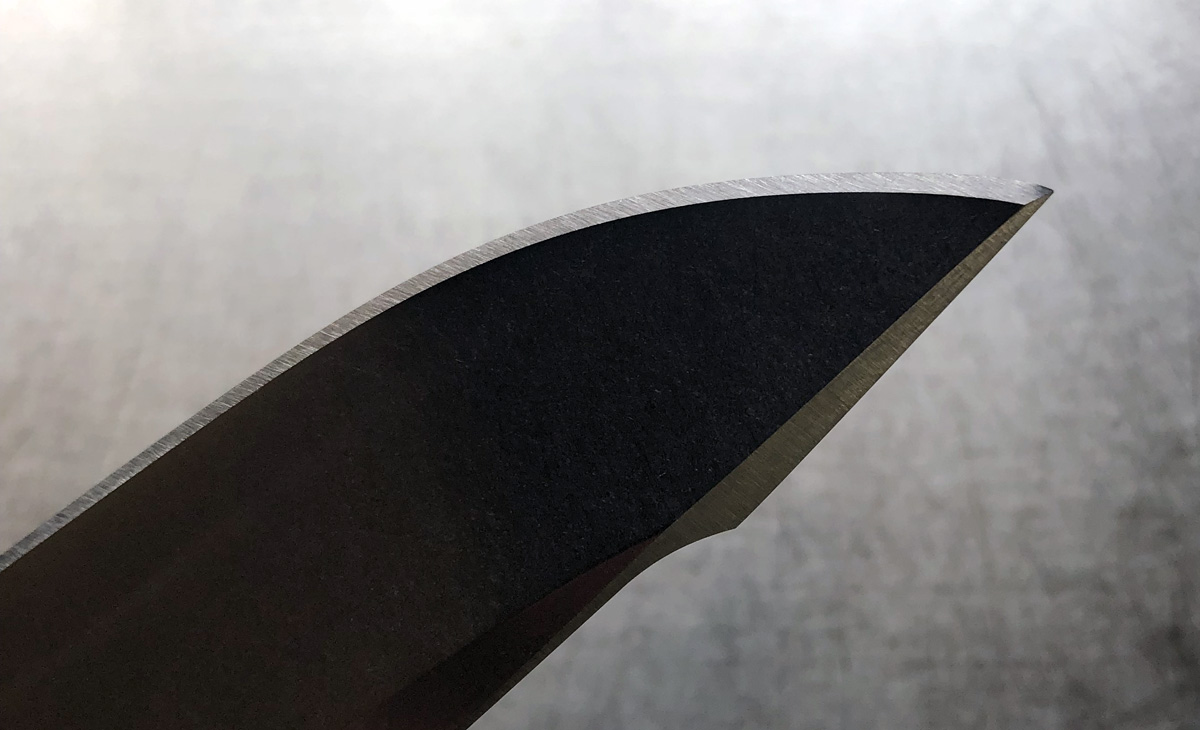

My procedure is very similar to Laurence's. After grinding the secondary bevel with a 120 grit belt I move to a 220 silicone carbide belt. After the 220 belt I move to the buffer with green scratch remover compound to remove the burr and polish the very apex of the edge. Just a couple light passes each side, thats it. Sharpening is the last step on each batch of knives that I do besides a final wipe down by hand. I expect each knife to slice paper cleanly without drag, three times. If one fails I go back to the 220 belt again and then the buffer again too.
Outside at the grinder:
Testing:
Sharpened and ready for the wipe down:

But outside of leather work I really like a toothy edge. For kitchen work I kinda split the difference. Kitchen knives I take to 400 grit and then hit the buffer:
Sharp enough to make the onions cry.
