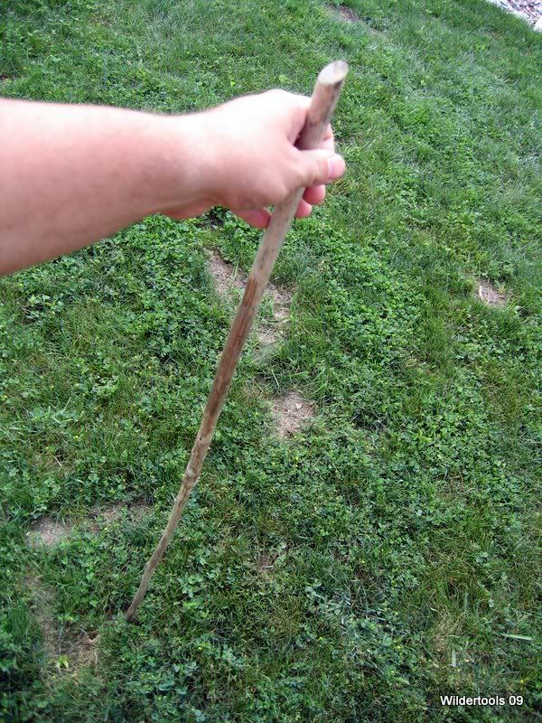

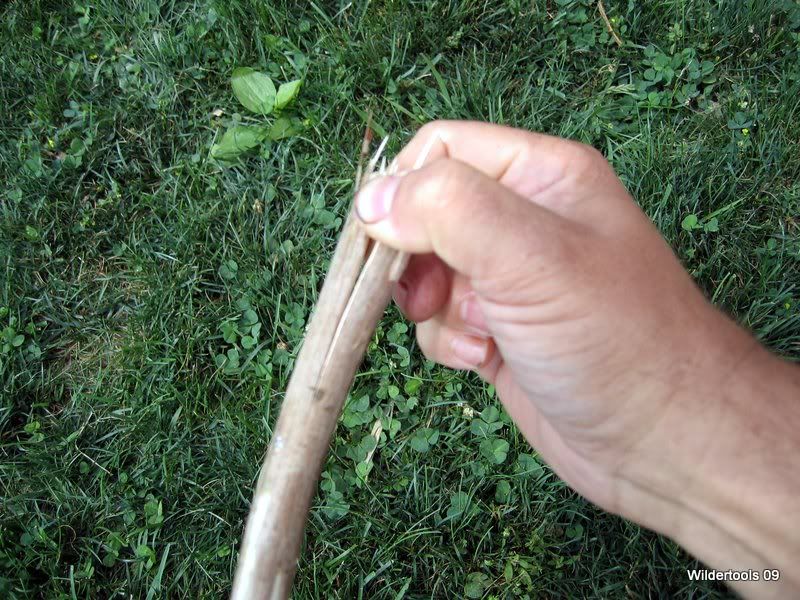

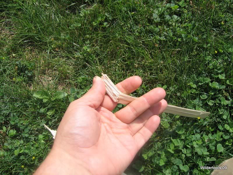

Here is the walking stick. About 4’tall, index finger dia at its thickest… poplar, I think.

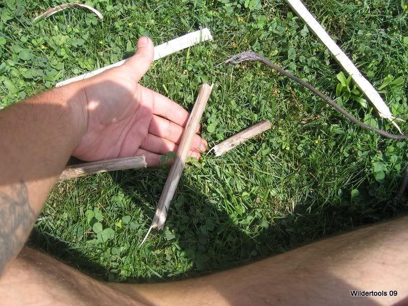

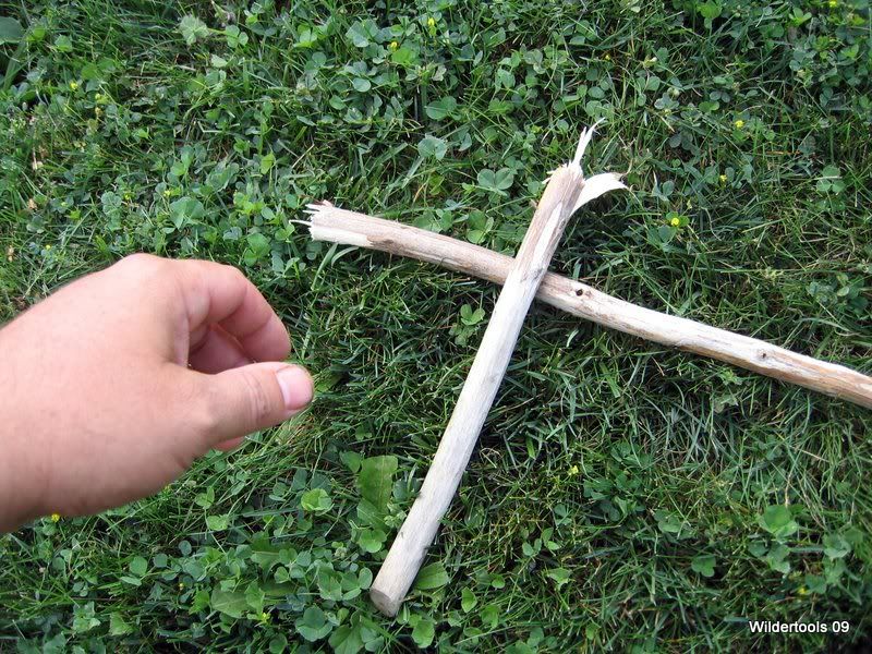

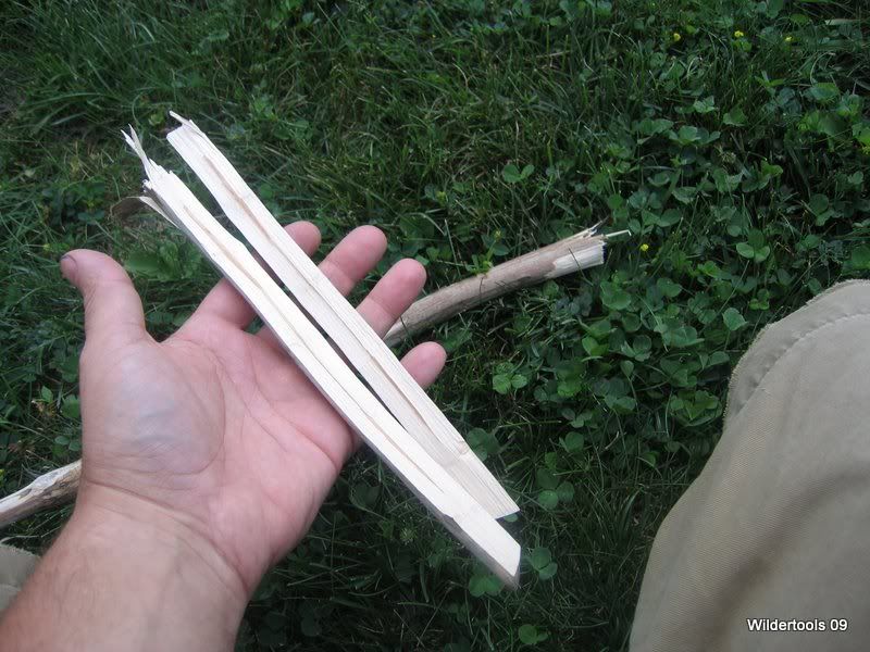

I snapped the first bit off that was to be the hearth. I split it in two and was going to bind it together for the 2stick fireboard method.

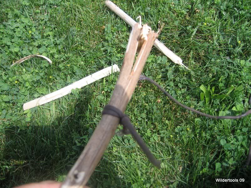

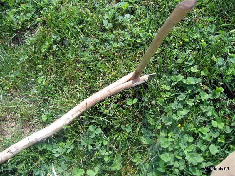

But then I noticed the split in the walking stick and thought. “Hey, what if I wedged something in there to simulate the notch?”… cooool. I made a wedge from one of the halves and slid it in the split. I would have to bind the staff to keep it from splitting all the way down. This would also use less cordage than binding the 2stick fireboard.

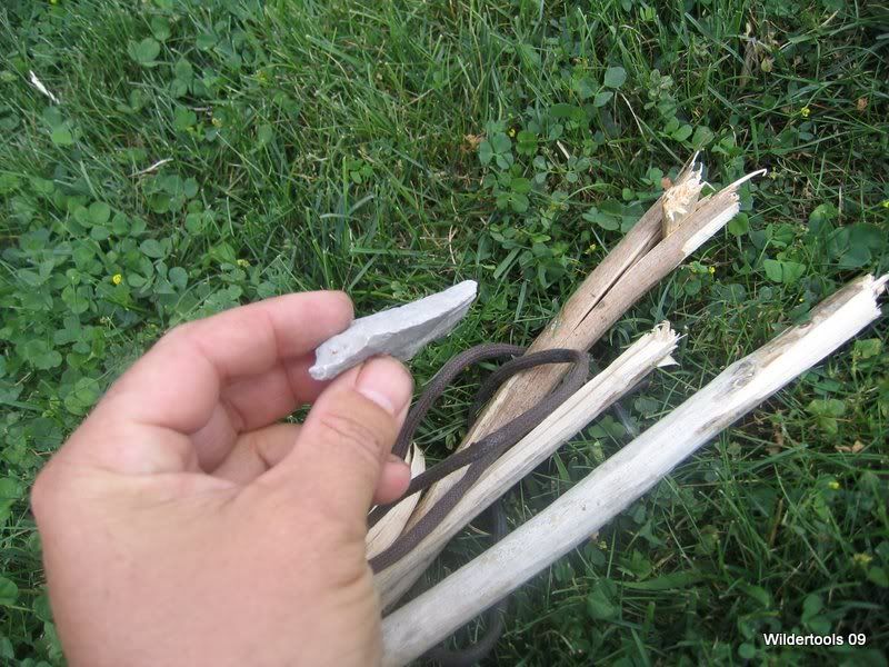

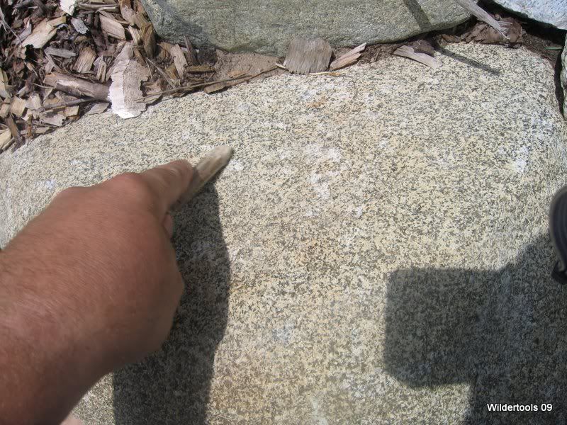

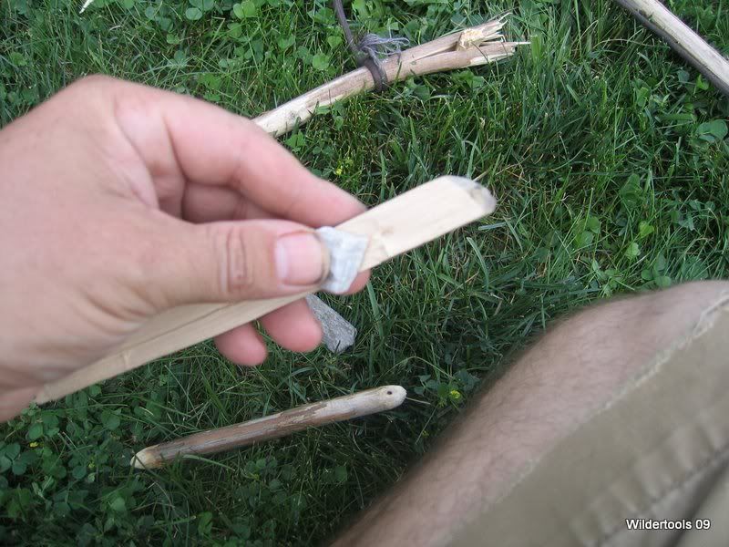

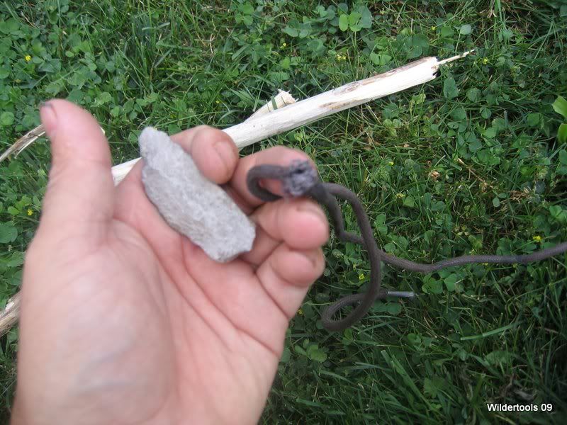

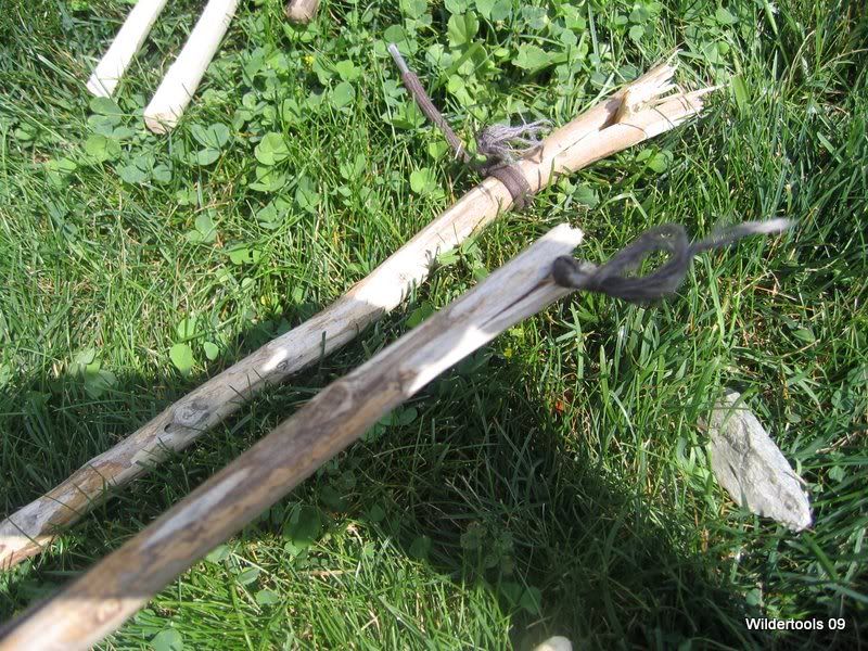

Okay, I cheated and used my shoelace instead of natural cordage… I was feeling lazy. I needed to cut it so I grabbed a piece of gravel from the driveway.

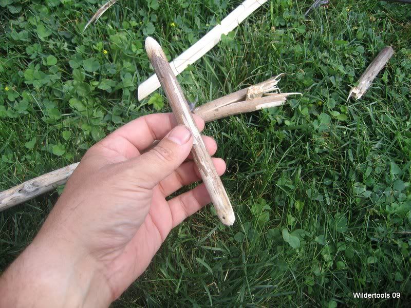

I snapped a piece out that would be my spindle. How do you sharpen a spindle without a knife? Well you could find a rock and sand it down instead. Not exactly a naturally occurring rock formation but you get the idea.

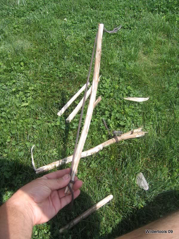

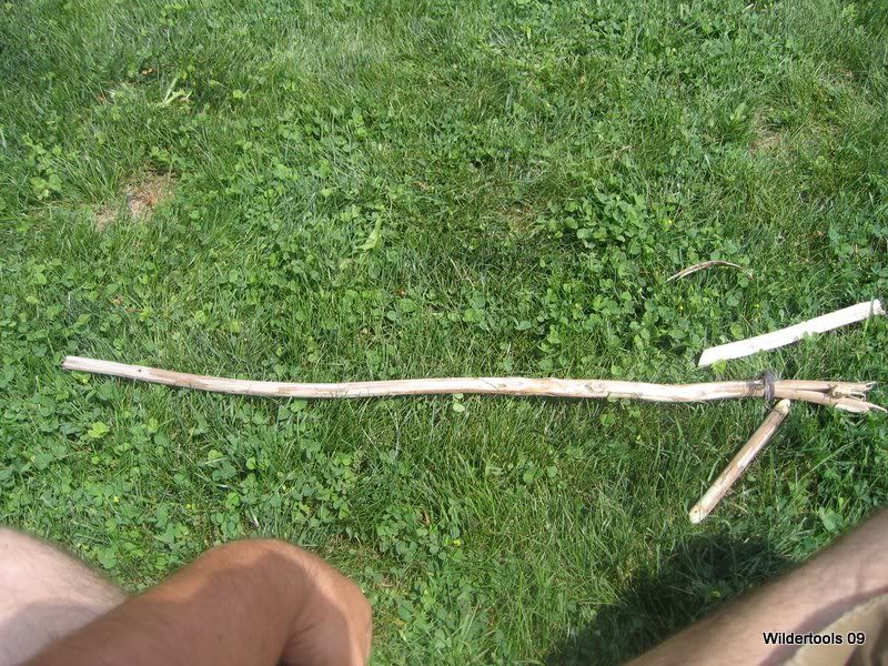

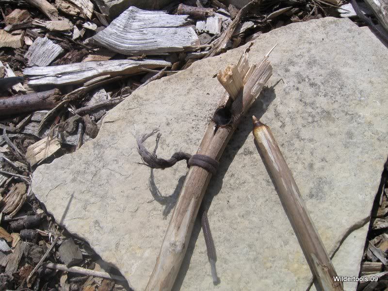

This is what I had left of the staff and I still needed a bow and bearing block.

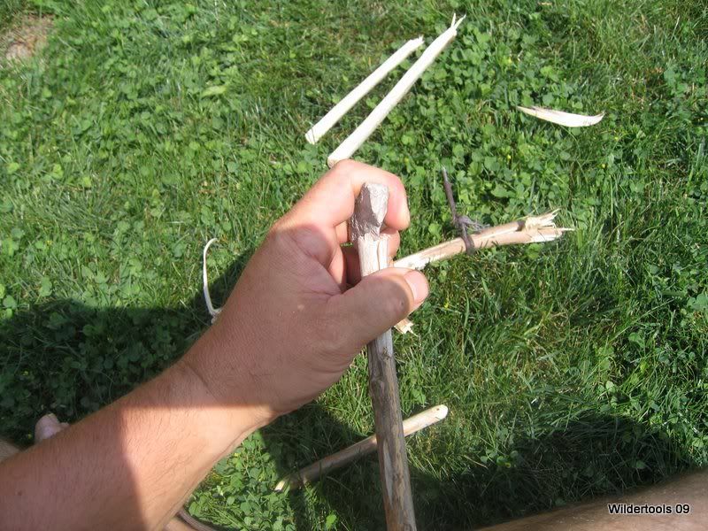

A couple snaps later, I had my bow. I decided to use one of the other pieces as the bearing block.

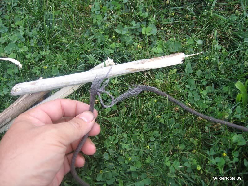

I needed to string the bow with my remaining cordage. I split the end, knotted the shoelace and attached it.

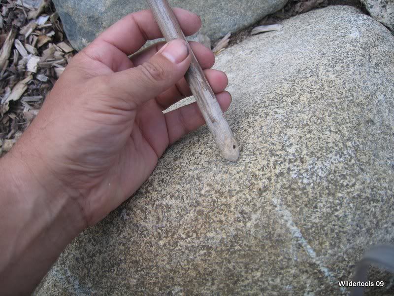

The bottom of the spindle would seat itself in the fireboard split but I needed to carv a divot in the bearing block. Back to the driveway for tools!

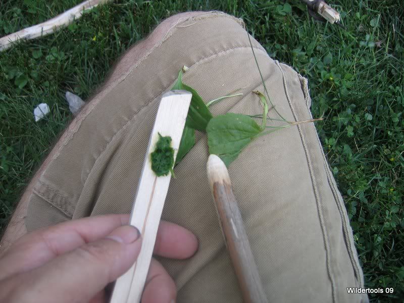

I chewed up a couple leaves of plantain to serve as lubricant for the bearing.

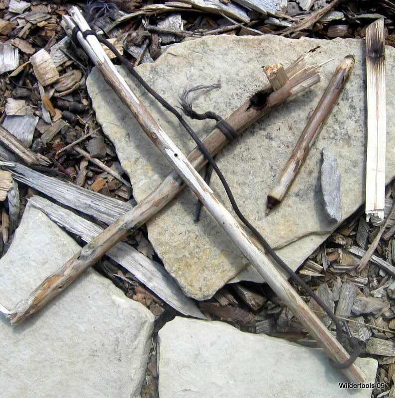

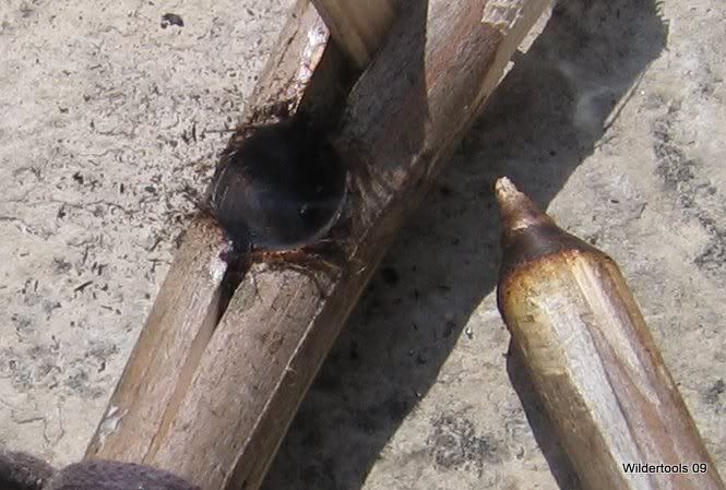

And away we go!!.....
My daughter agreed to take one picture of me using the set, then ran back into the house to watch “Indiana Jones”.
About 10mins later I had a coal. It’s hard to see, but there’s smoke in that thar hole!
I had a lot of fun doing this… it was about an hour from start to finish.

Actually, I three uped ya.... I don't use a knife... I make everything from the same stick. Bow, bearing and all. (smaller I might add)... AND I have pictures to prove I'm not a big bald liar!:grumpy:
Oh yeah.... its been broughten!!:p
