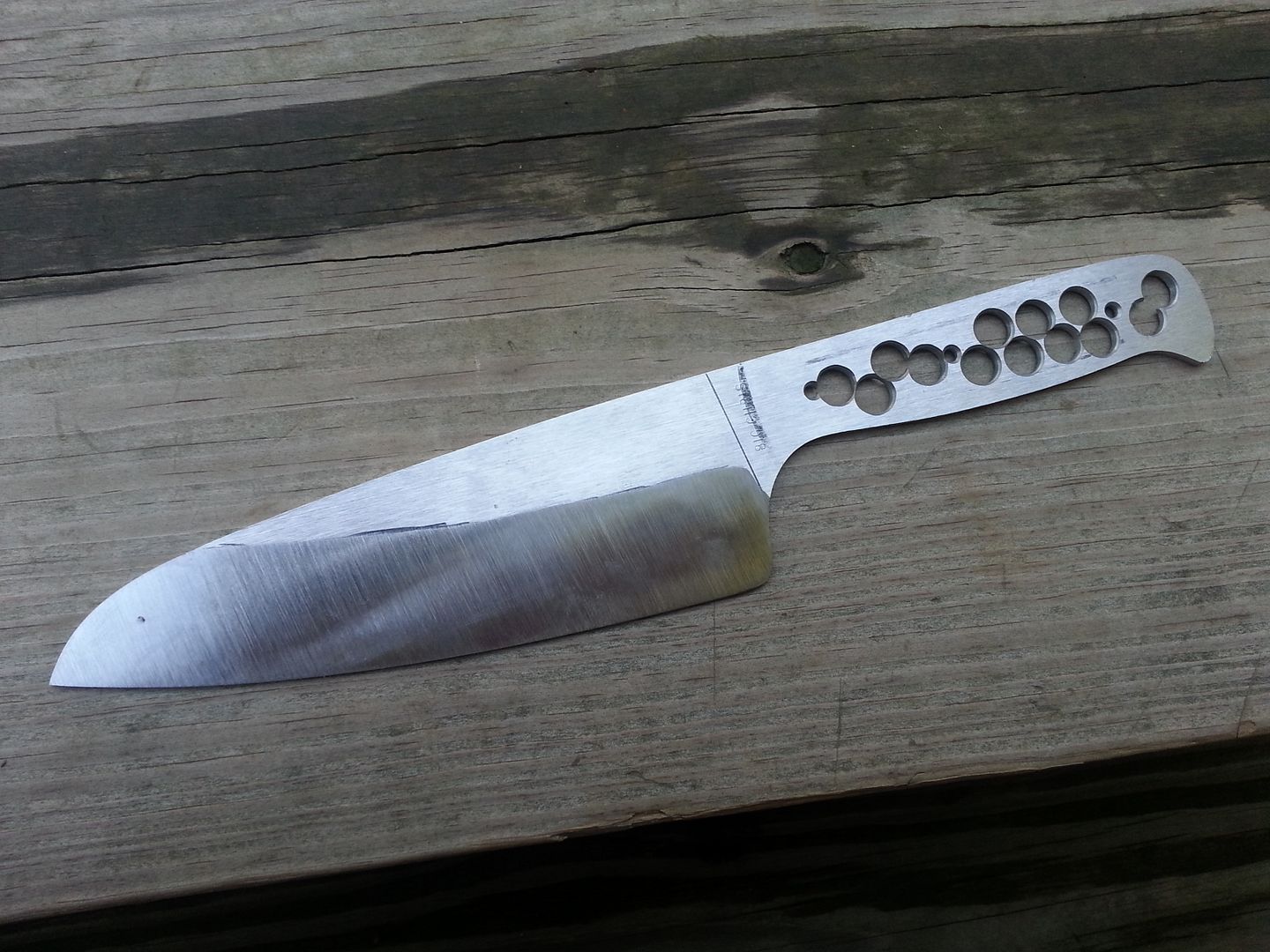

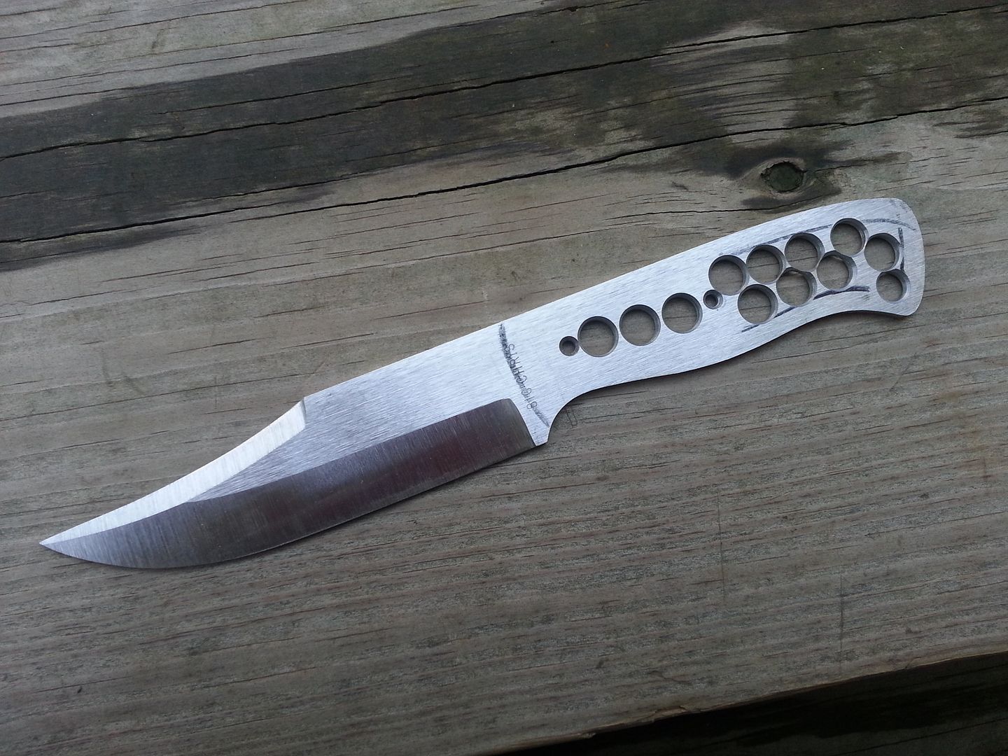

Let me start off by saying that even with new Blaze ceramic belts, this has to be the most difficult steel I have ever worked with. While drilling the holes in the tangs, it continually work hardened itself, and grinding is by far the most difficult steel I have ever ground in the annealed state. I am aiming for a 63 Rc hardness. These are going to be ground for extreme slicing efficiency.
All of the pictures are from a cell phone so they are not very good quality.

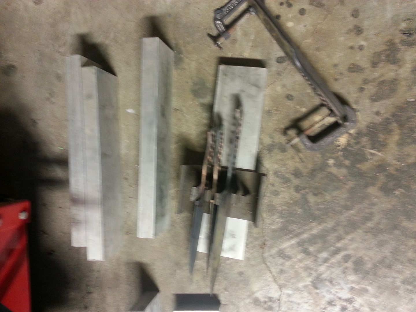

As delivered from Niagara, surface ground and well packaged. Ready for the laborious working process.

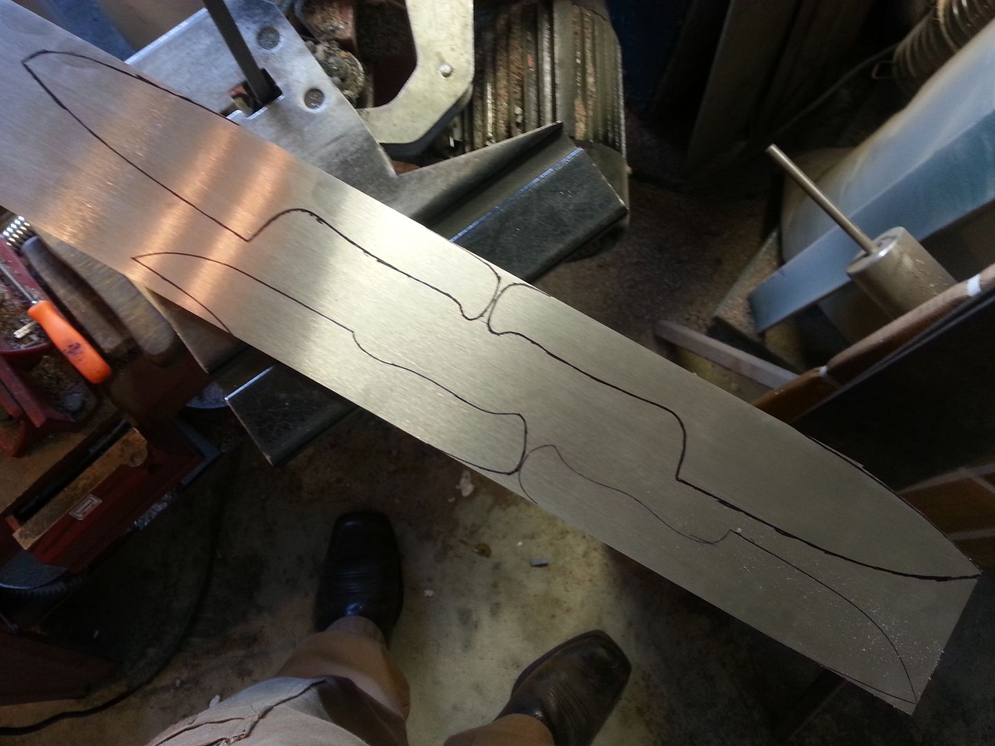

Here are the sketches drawn on the steel, ready to be sawed.

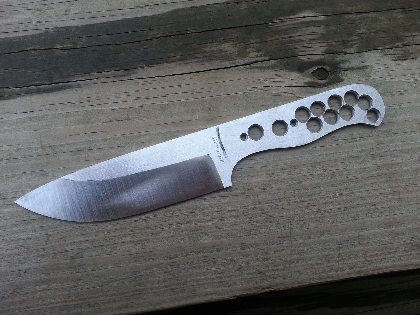

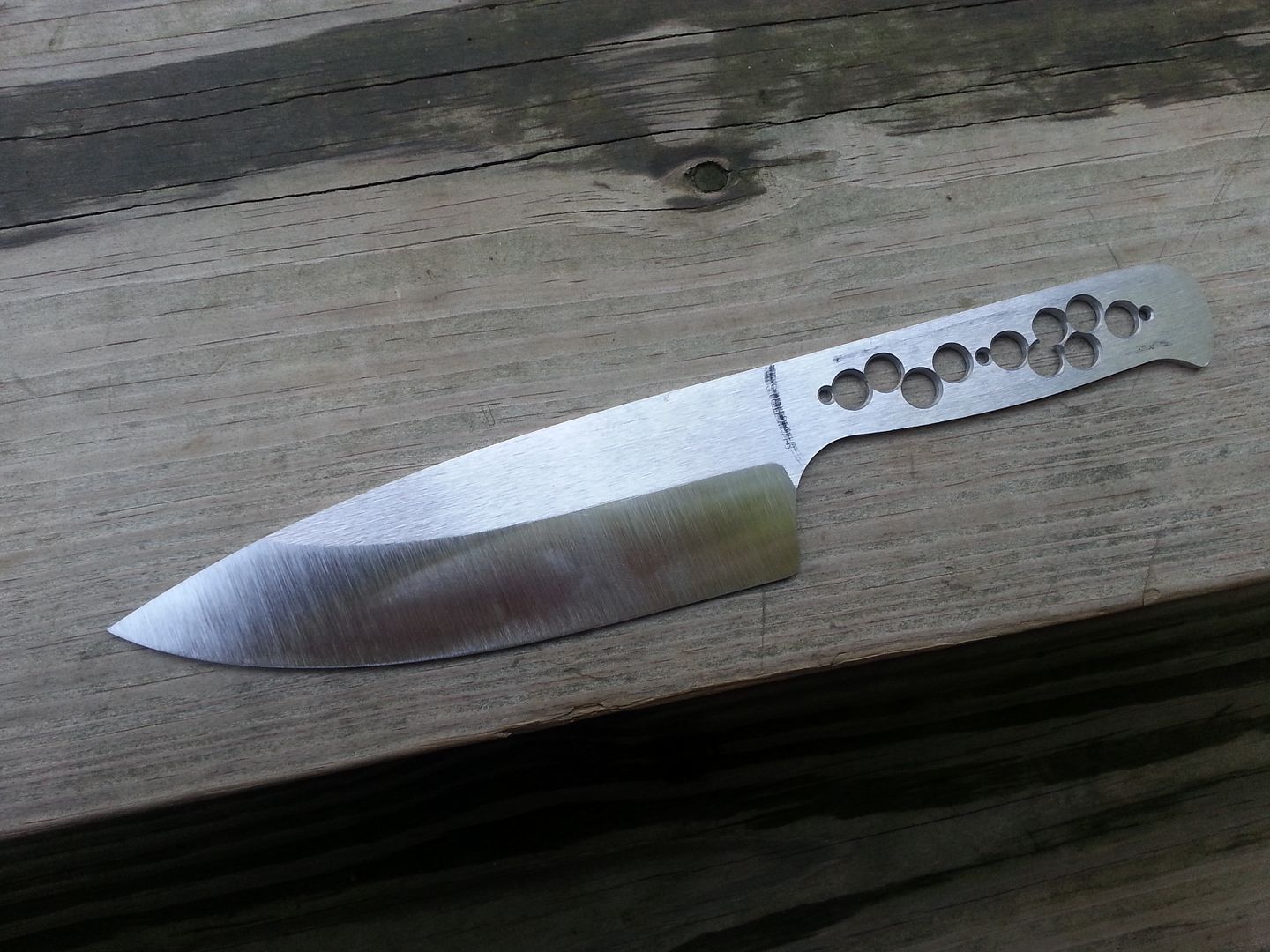

Pre heat treat photos of the four knives

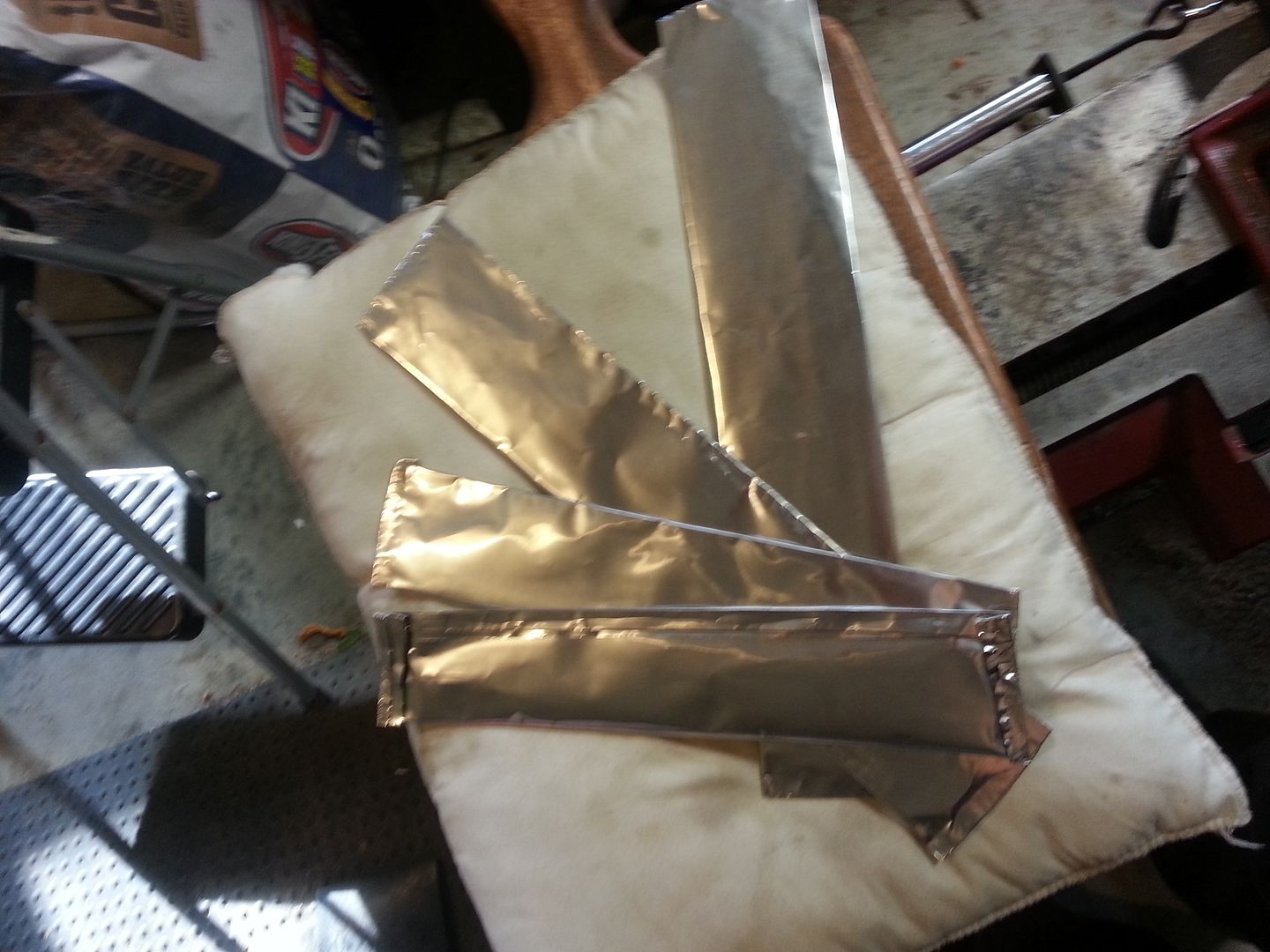

Here is a picture of them wrapped, ready to be put into the oven.
I did the heat treat from 10pm until 3am so no pictures of the oven or the quenching process due to sleep deprivation. Plus you all don't want to see me in my jammies. The knives are getting their third and final temper as this is being typed. After an 11:00 run for dry ice last night, the blades have had two cryo cycles and if I am lucky I may be able to pull a 64 Rc out of them.
Here is a picture between the second and third temper. As you can see, there is always one blade that wants to be a pain and can't quench straight.

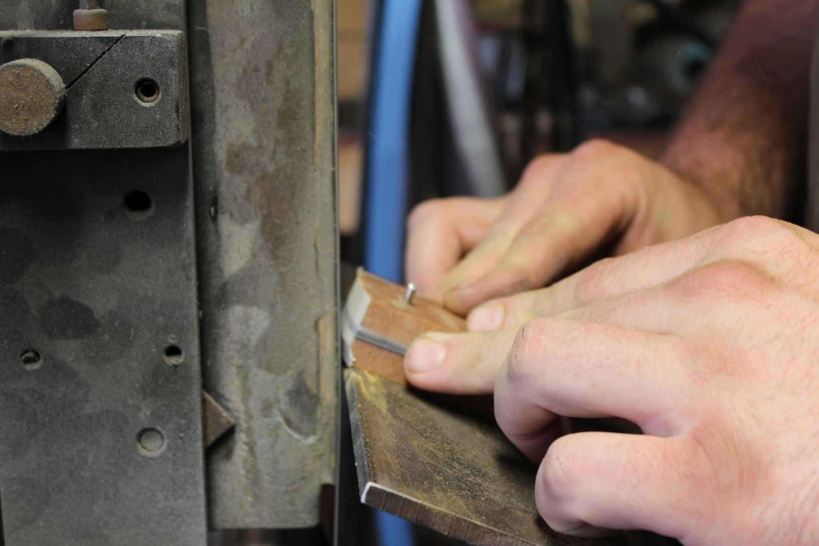

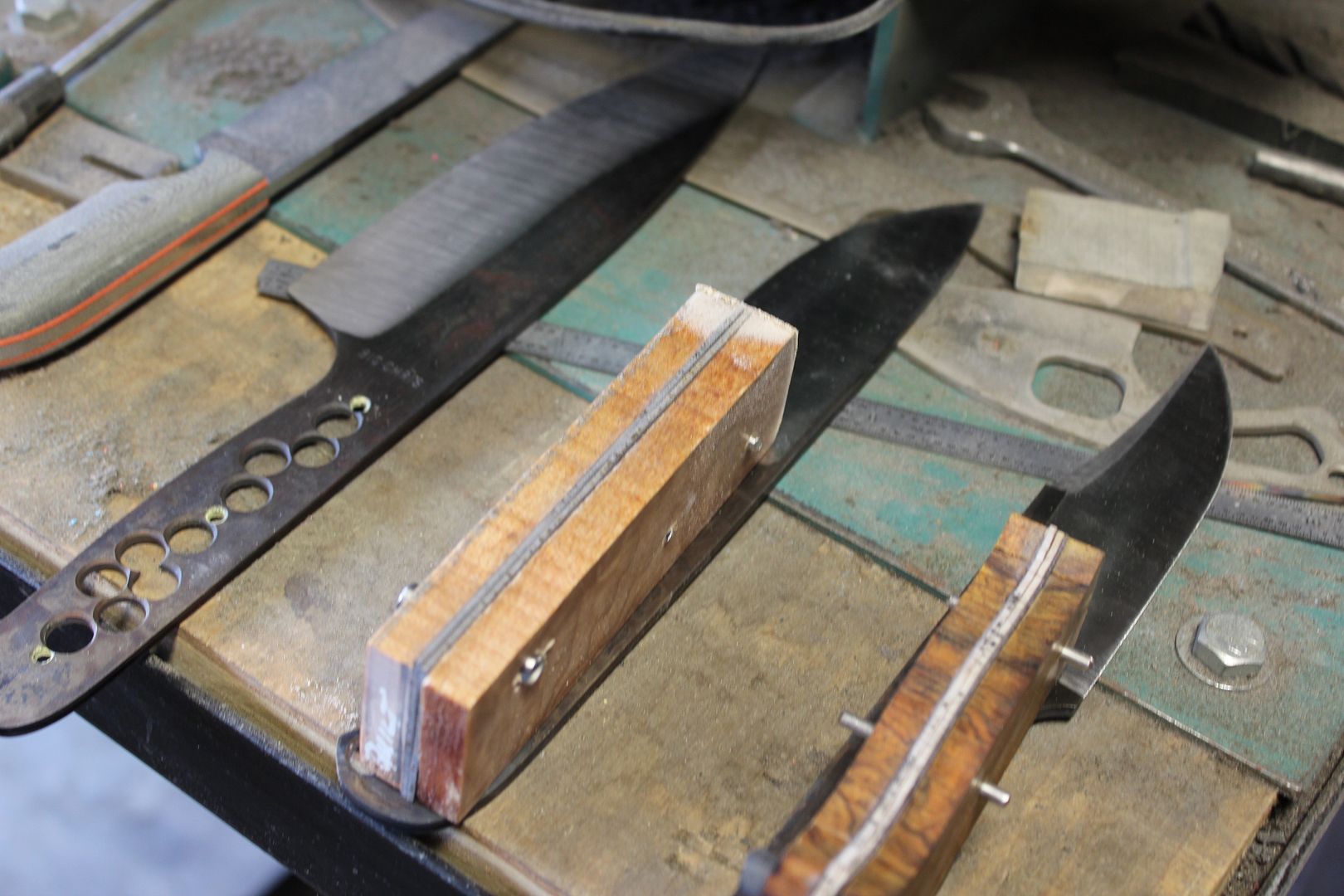

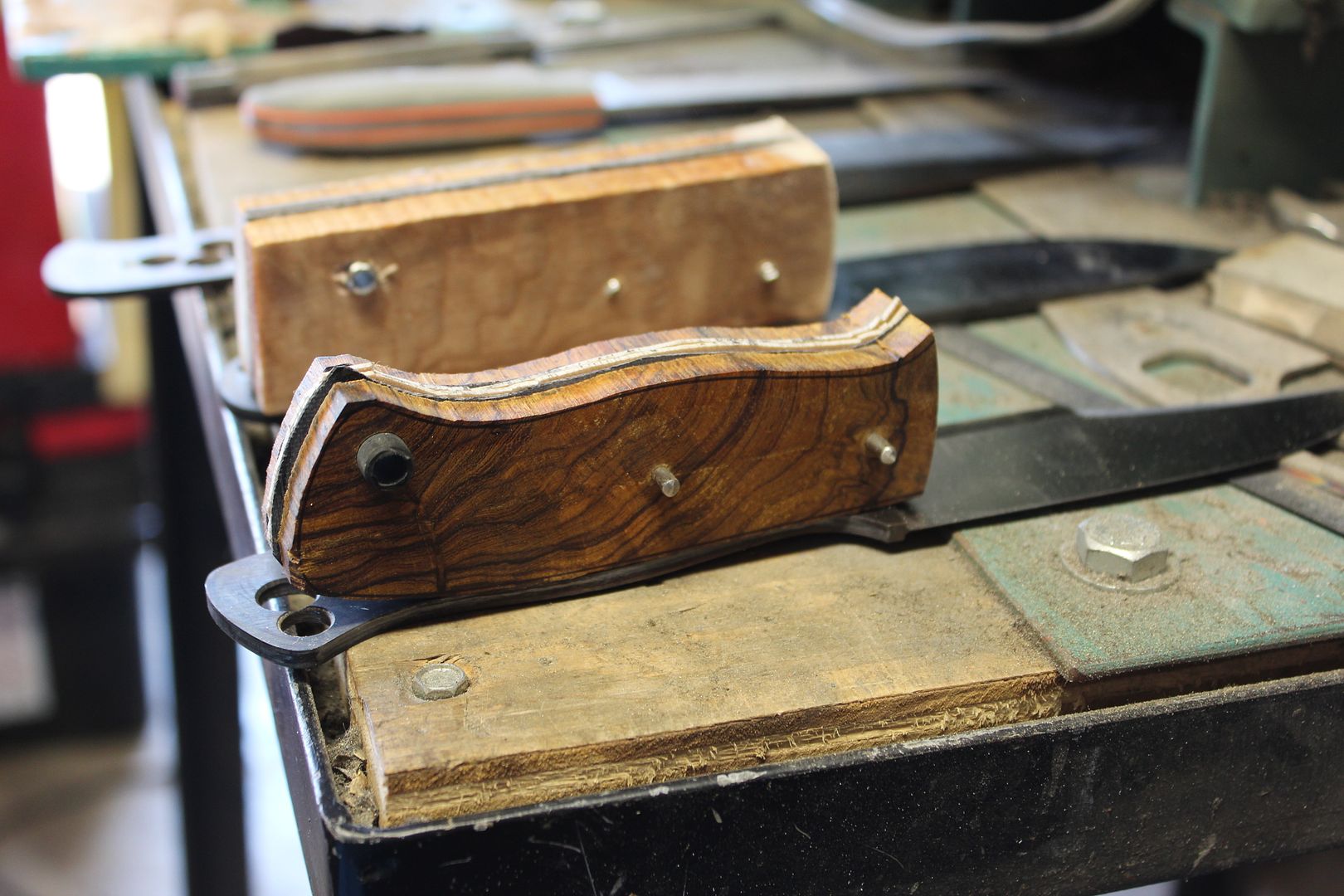

Shaping the Fronts of the Scales
Scales Lined up Waiting for the Ends to get Beveled

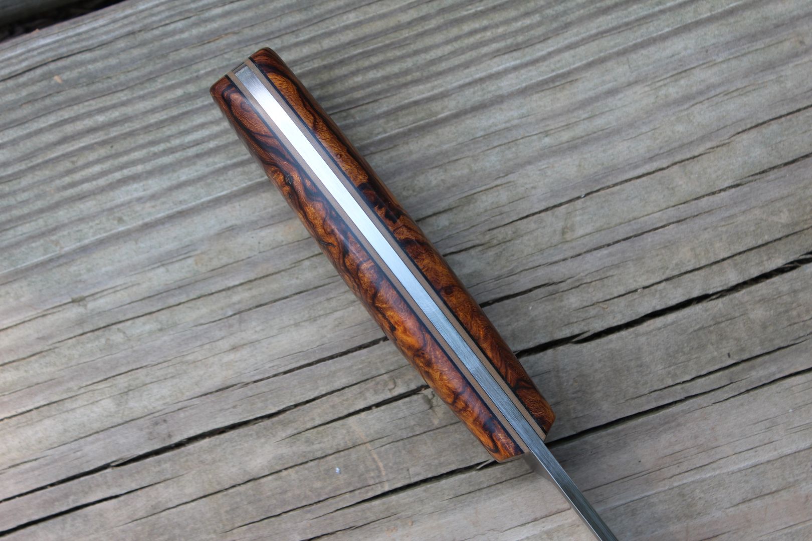

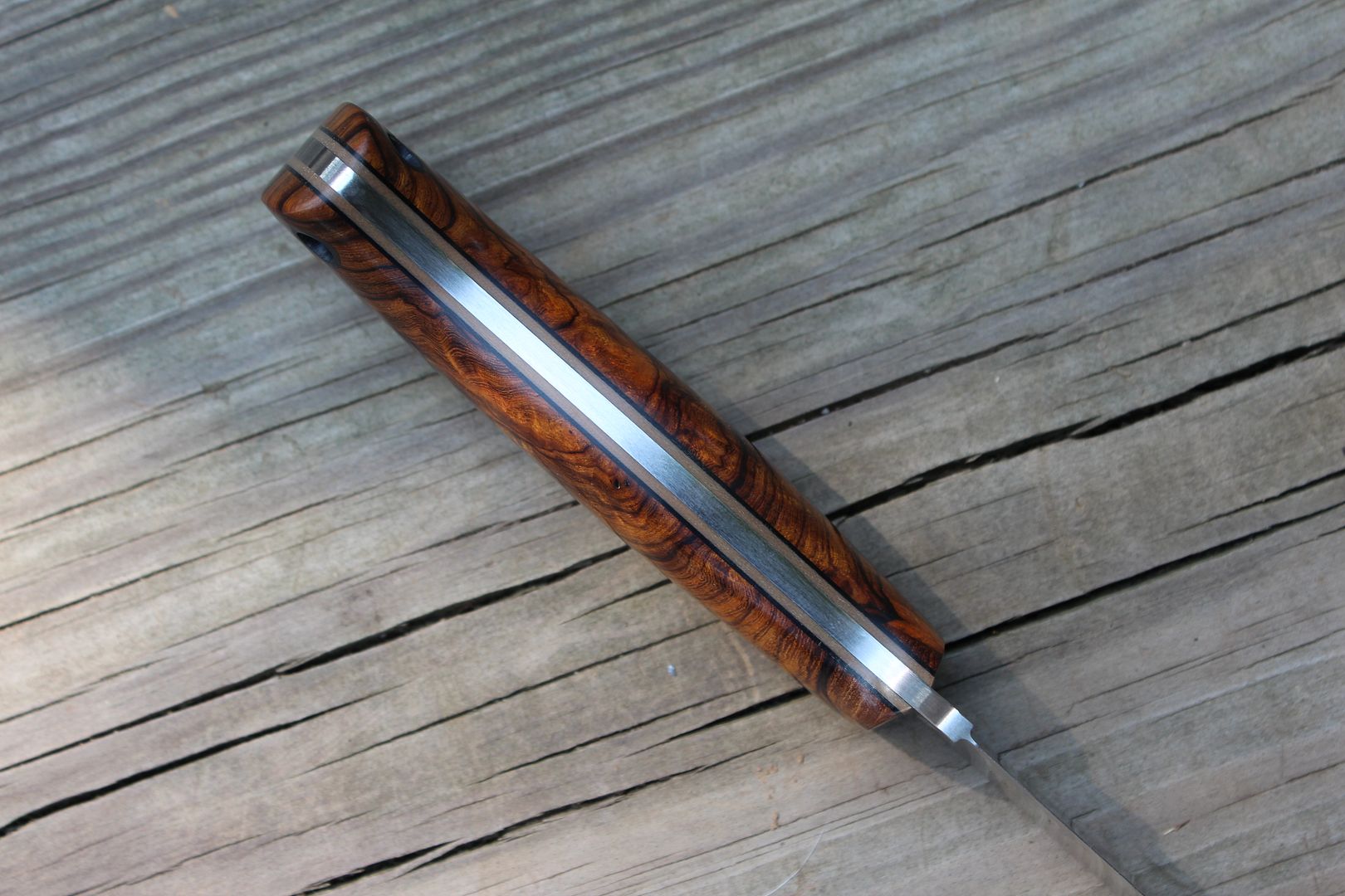

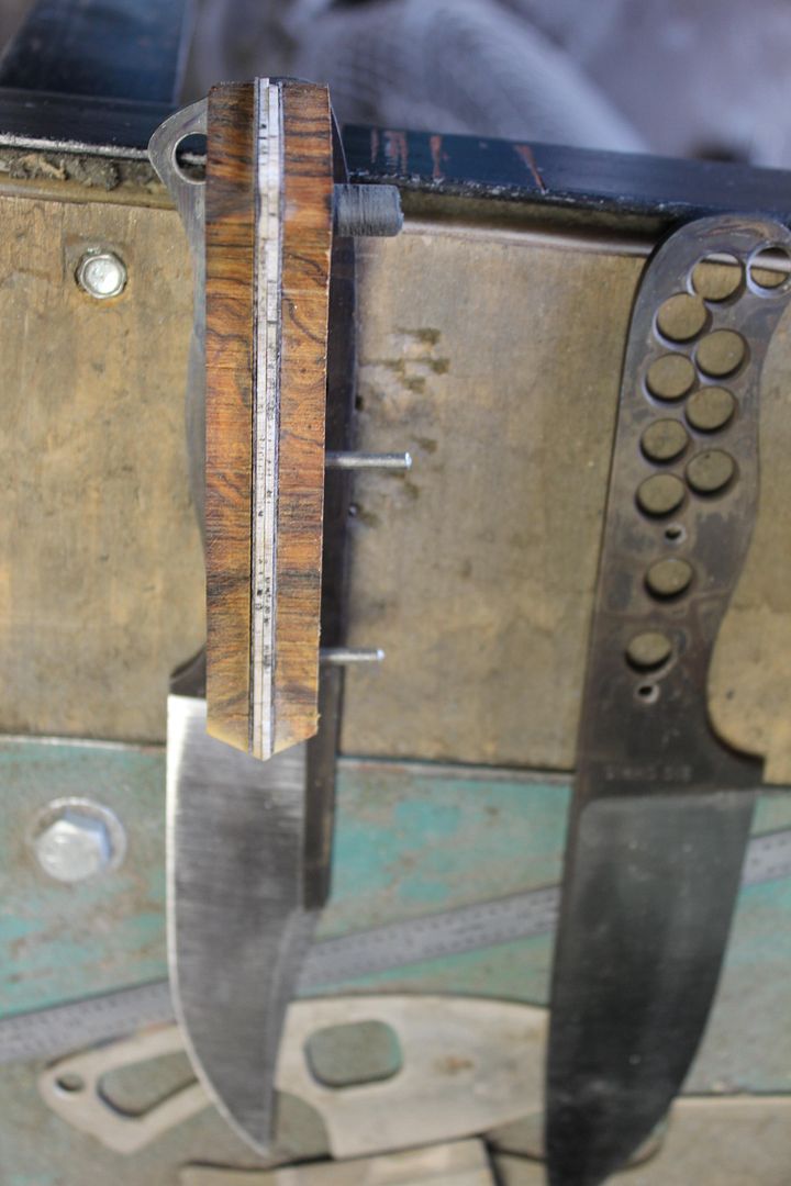

Ends Beveled on the Desert Ironwood
Beveling Setup

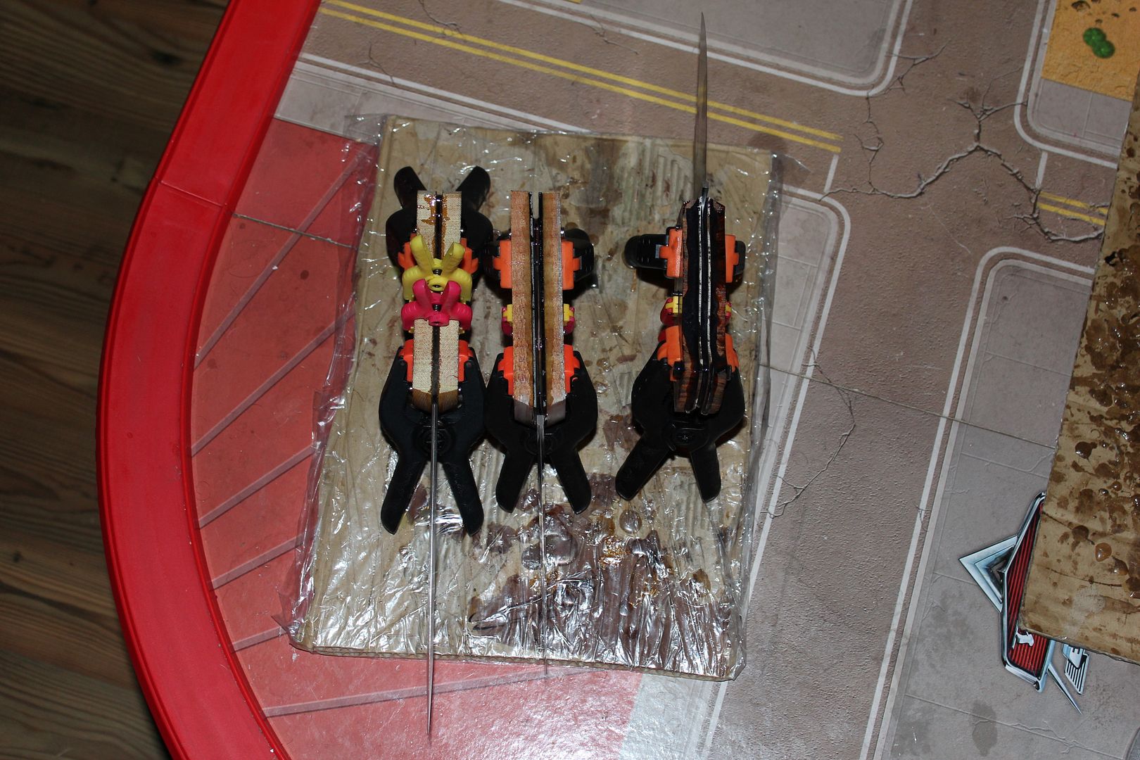

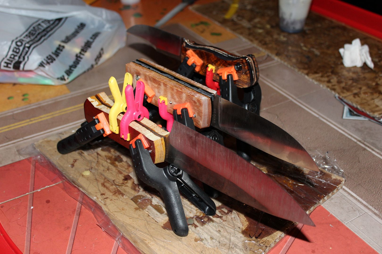

Glued Up

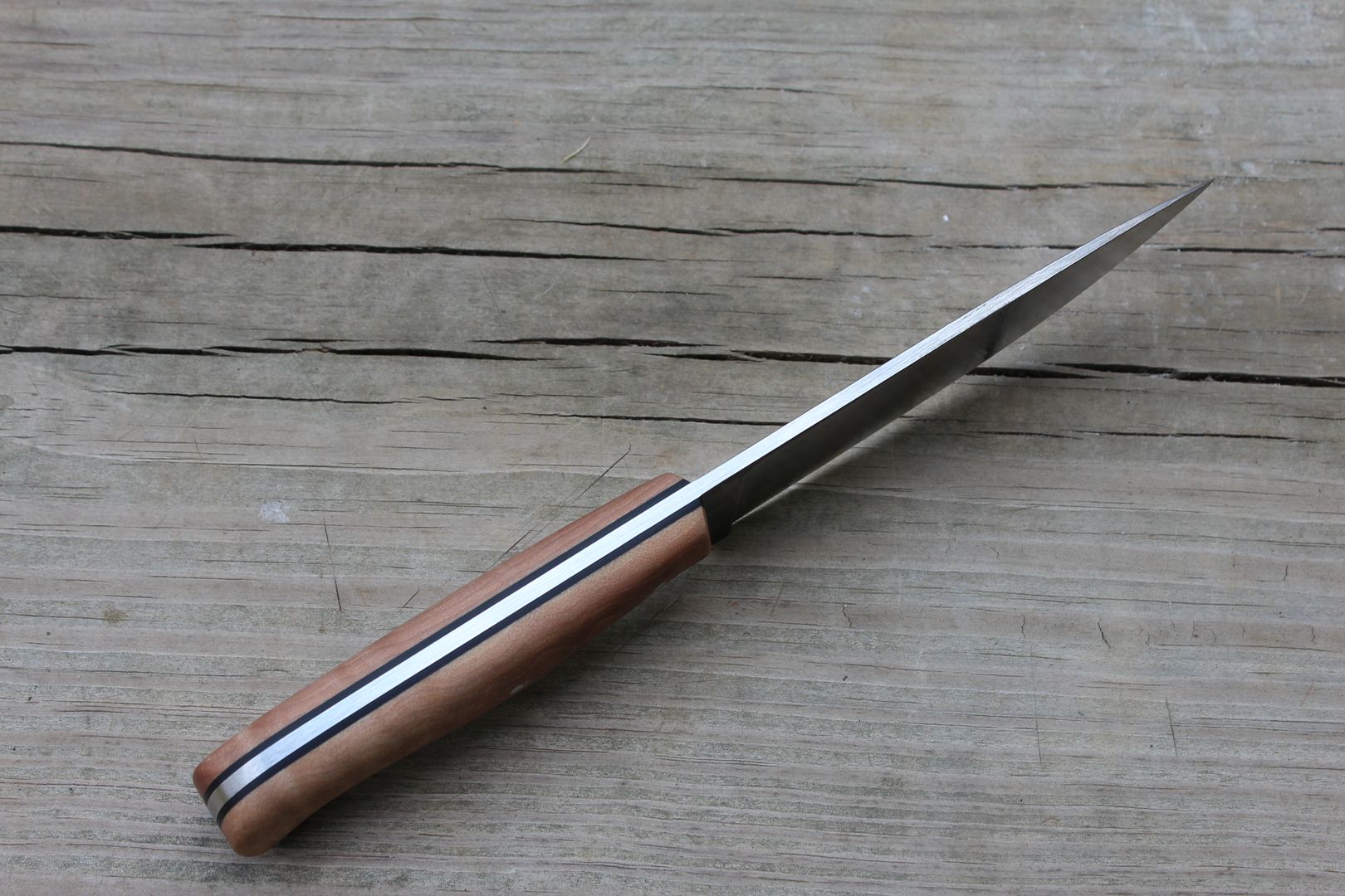

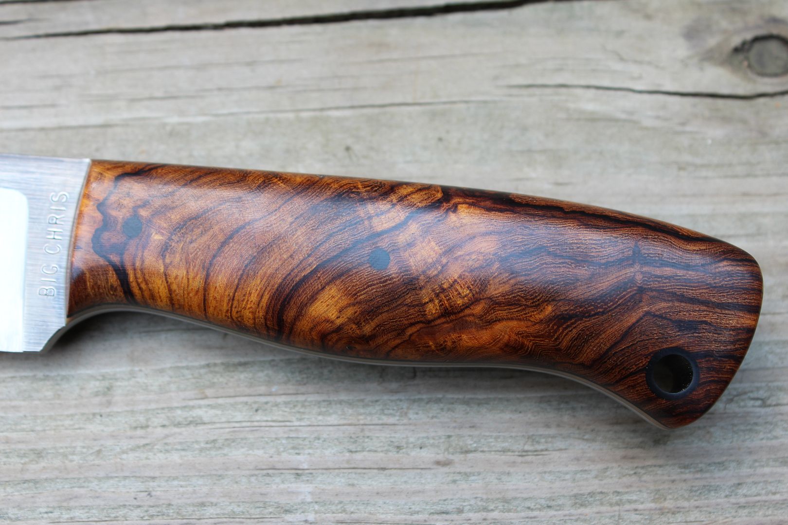

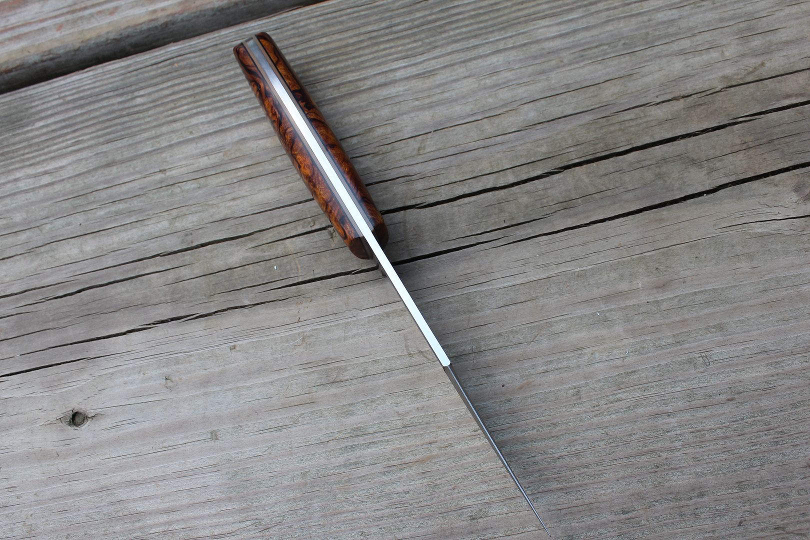

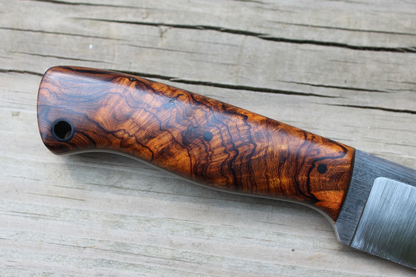

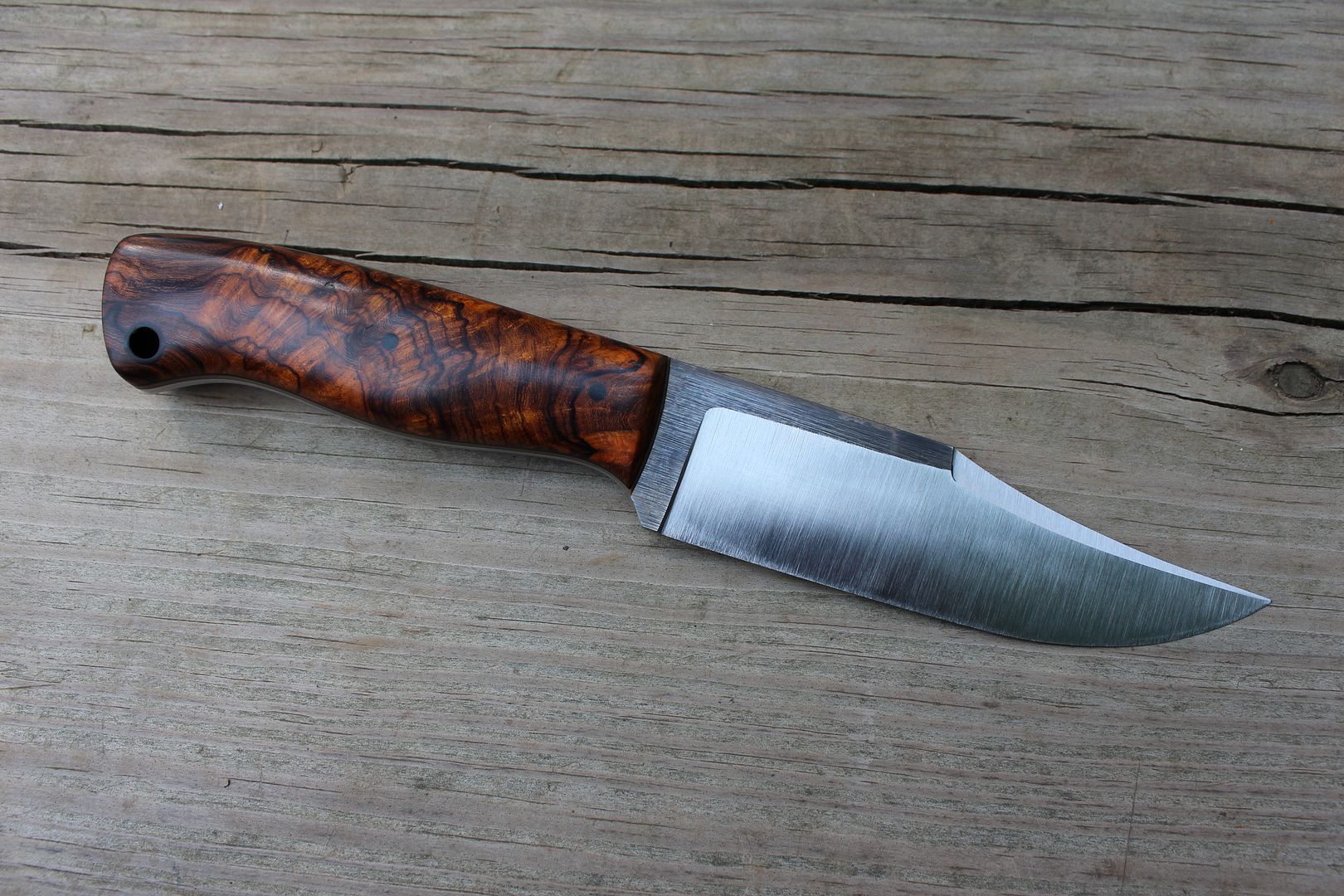

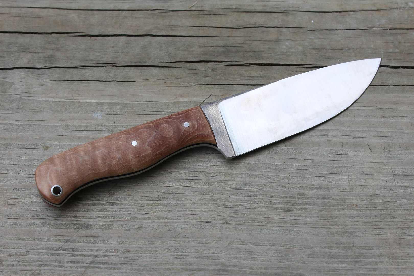

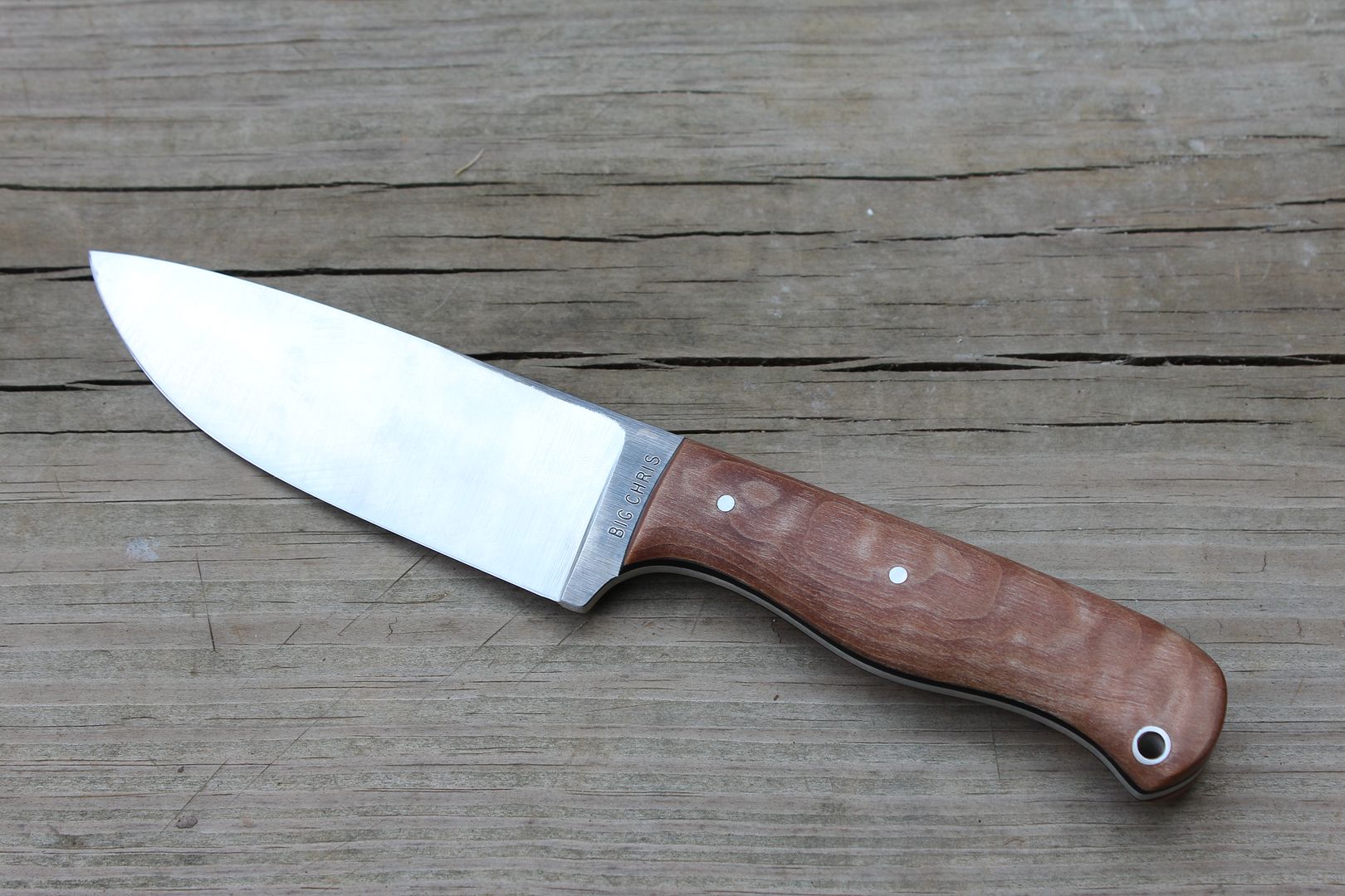

My Bowie EDC and the Jack Knife are done.
Bowie
Jack Knife
