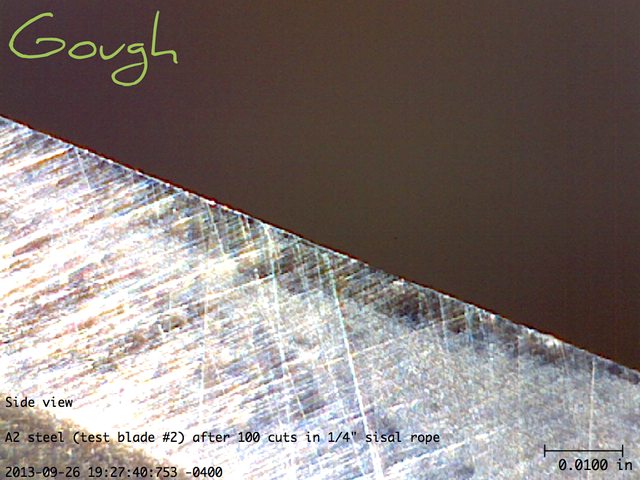

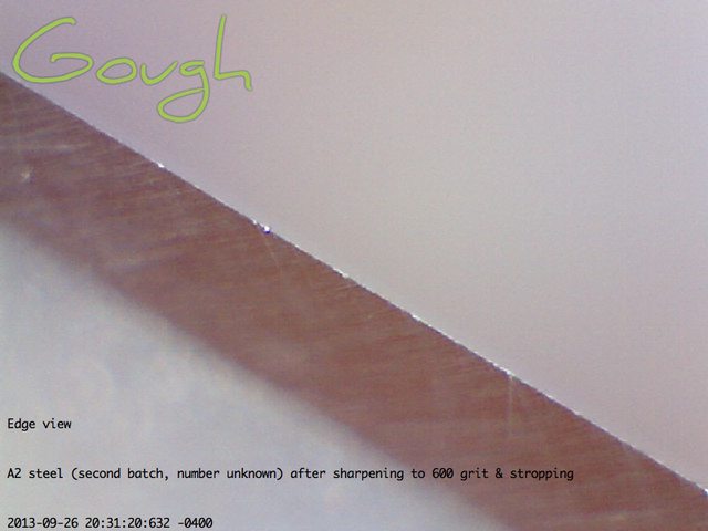

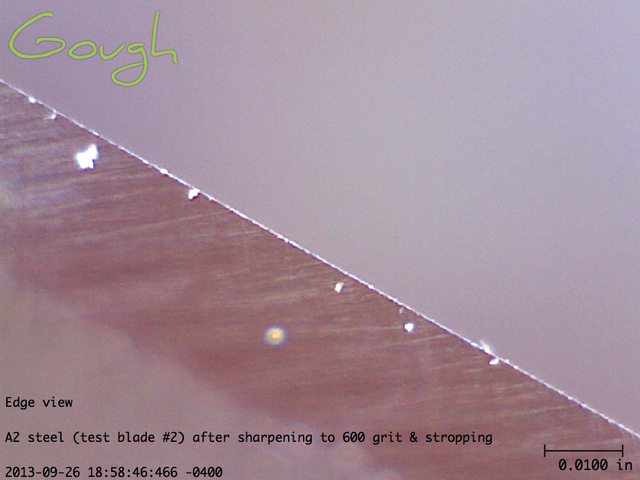

Ok! So first batch of images from the microscope. Not the sharpest images ever, but they serve the purpose!
Here is the A2 blade from the first batch after sharpening and stropping:
Here is the A2 blade from the second batch after the same sharpening and stropping regime:
You can see that the blade from the second batch with the modified heat treat definitely took a finer edge.

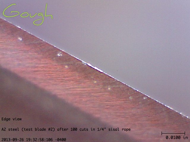

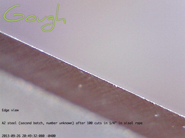

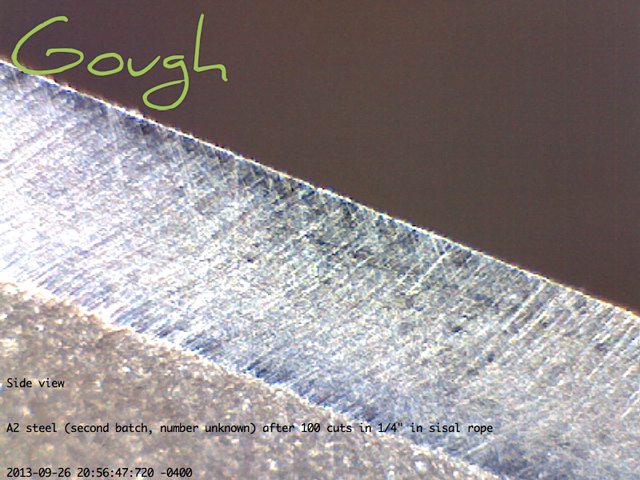

Here is the A2 blade from the first batch after doing 100 cuts through 1/4" sisal rope (edge):
Here is the A2 blade from the second batch after 100 cuts through 1/4" sisal rope (edge):
You can see that the edge on the second blade has deteriorated a little more, although it's done so more consistently.
Here is the A2 blade from the first batch after doing 100 cuts through 1/4" sisal rope (side):
^ Note the slight deformation in the edge
Here is the A2 blade from the second batch after 100 cuts through 1/4" sisal rope (view):
^ No noticeable deformation

1. There seem to be burr on batch1 edge.
These sizable burr probably get sheared off by sisal.
2. Batch2 edge has a wire-edge.
Sisal first rolled the edge, then subsequence impacts flattened the apex. I don't see many holes (micro-chip) on the edge but a lot of reflection, which indicate rounded apex.
A quick test for wire-edge: slice newsprint (even printer paper), after 5+ slices, if the edge catches - voi'la wire-edge.
please bluntly tell/correct me if I goof :foot:
Honestly I don't really have enough information to say exactly what the failure mechanism was in the second blade. The first one is clearly starting to roll/tear.
I will say though that I viewed the edge on both blades from both sides and I didn't see any real folds or rolling apart from the small ones apparent in the photos of the first blade. I don't think a wire edge was the culprit, but I simply don't have the magnification to say that definitively unfortunately...

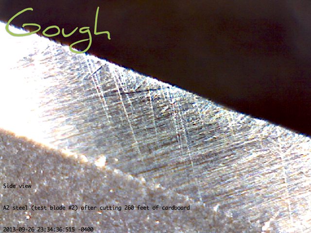

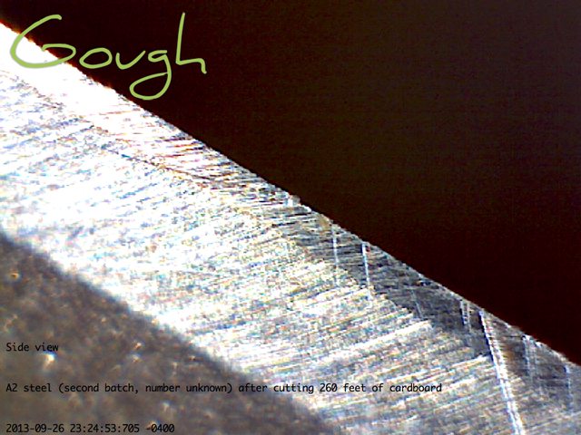

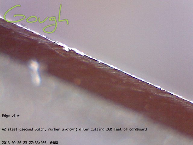

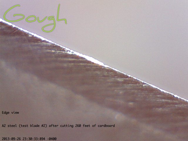

So, I just finished cutting up over 500 feet of cardboard with the two blades in question.
A2 batch 1 (test blade #2) after cutting 260' of cardboard (side):
A2 batch 2 after cutting 260' of cardboard (side):
A2 batch 1 (test blade #2) after cutting 260' of cardboard (edge):
A2 batch 2 after cutting 260' of cardboard (edge):
After the test I would consider both blades to be extremely dull. Neither were capable of cleanly cutting notebook paper, let alone shaving. During the test I didn't really notice any difference in terms of how fast they broke down...
I tried stropping both blades (all my stropping is done without abrasives btw) to see if either edge would bounce back. Neither one di though, they're both in dire need of resharpening.
Given the results so far I would probably take the blade from batch #1 personally, as it holds a fine edge a bit longer than the blade from batch #2.
You probably right, I am just exploring...
It could be batch2 stropped edge was too fine/delicate for sisal cutting. Ankerson's manila rope cutting shown that coarse edge performed much better than highly refined edge. http://www.bladeforums.com/forums/s...based-on-Edge-Retention-cutting-5-8-quot-rope
If you don't mind, please test batch2 edge off 600 grit without stropping.
btw - clean 600 grit & stropped edge micrographs (see post #122, then #119) http://www.bladeforums.com/forums/showthread.php/1036649-A-balanced-strop?p=12608140#post12608140. Highly refined edges off post #119 won't do well in sisal rope cut test.
edit: thanks for clarified stropping w/o compound. lol - lurk mode, I'll go...

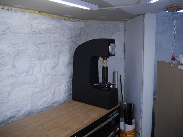

Well, the new toy is in the shop. Now I just have to get it all setup, hopefully that won't take too long (though the not exactly stellar manual won't be much help!)
So today I got the hardness tester setup and managed to test all the blades! It was very illuminating in at least one case, you'll see why shortly.
First, a disclaimer about these numbers: the hardness tester I just bought is consistently reading 2.5 points low. I tested it with high and medium hardness HRC standards that it came with and the result was about the same on each, 2.5 points low. I haven't worked out quite how to calibrate this error out yet (big surprise that the manual is no help) so I've done all the tests with the tester as-is. The numbers below are the numbers from the tester PLUS 2.5 POINTS to approximately calibrate it with what it should be reading. The actual numbers straight from the tester are included in parentheses next to each result. I know this is not ideal, I'll work out how to calibrate it and re-do this shortly, in the meantime it at least gives us a comparison between the blades.
Each blade was tested on the tang, as close to the ricasso as I could get. The tang of each blade was ground to 120 grit on the belt-grinder before running the tests to make sure the surface finish and decarb did not cause problems. Each blade was tested 4 times, each test was about 1/8" apart. The first result was thrown out, then the other 3 results were averaged to give the numbers below:
