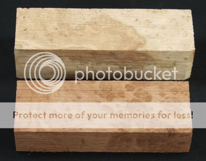

The first two photos show a couple blocks of some scrap material I am using for this guide. The first shows the blocks dry and the second with the blocks misted with water. You will see a big difference that you can compare to the photos of the finished pieces at the end of this guide.
Dry Photo unfinished blocks
Wet Photo unfinished blocks

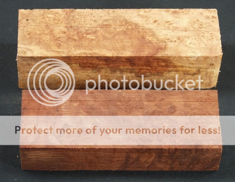

We mix our own oil (1/3 linseed, 1/3 paint thinner, 1/3 varnish) but you could just purchase a can of danish oil for similar results. I use a brush and apply a very liberal coat of oil to the wood. After it sits for about 10 or 15 minutes I apply a second coat. Depending on whether I am in a hurry or not I let it sit for about an hour and then wipe it down with an old t-shirt.
Next with the compressor and air nozzle I blow out any excess oil that can accumulate in checks, voids and open grain. This step is important, otherwise that excess will bleed out resulting in an uneven finish.
Next photo shows the blocks after they have been oiled.
Oiled blocks photo

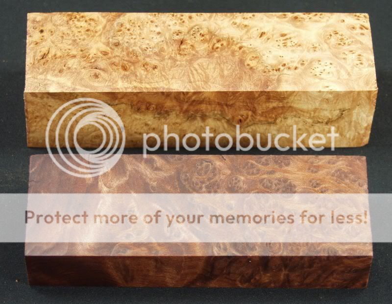

Going back to the lacquer spray a couple more coats then rub down again with the steel wool. Repeat this until the finish is good and even and you like how it looks. After your last coat, rub down one last time lightly.
This photo shows after last coat.
Last coat photo
Finally to finish the whole process use some furniture paste wax or polish and hand buff with an old t-shirt.
Last photo finished blocks
It is hard to see the differences in these photos but it will be really obvious when you see how the wood progresses in person.
