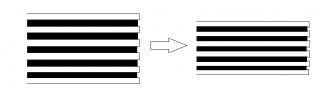

In your sketch on the right side the sketch shows what is almost an open space where the ends are folding over. That illustrates my experience - if a stack has "dips" between layers it's really easy for a shunt in the weld to happen. Perhaps not every time, but sometimes. I find it better to use a smooth ground flats so there is no space between layers.
