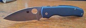

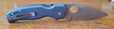

where do you buy those? looks infinitely easier than tapping 2-56 screw holesNot a huge mod, but an easy one something I wanted to share with everybody. I've had really good luck with these as far as working with micarta and G10. I've done it a few times now and they work really well. And it's as easy as it looks. Place clip, mark holes, drill holes, put in brass inserts, put screw in insert. The screw expands the insert into the handle material. Just an fyi.
Can't remember, but I'm sure you could look up ez lok and find them. You just need 2-56 internal thread for Spyderco clip screws.where do you buy those? looks infinitely easier than tapping 2-56 screw holes

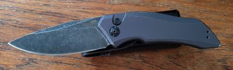

I was shooting for a worn weathered look, might have gone a bit too far
