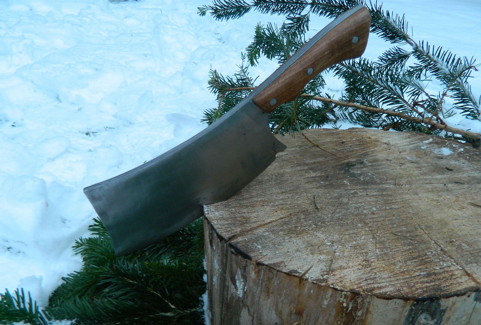

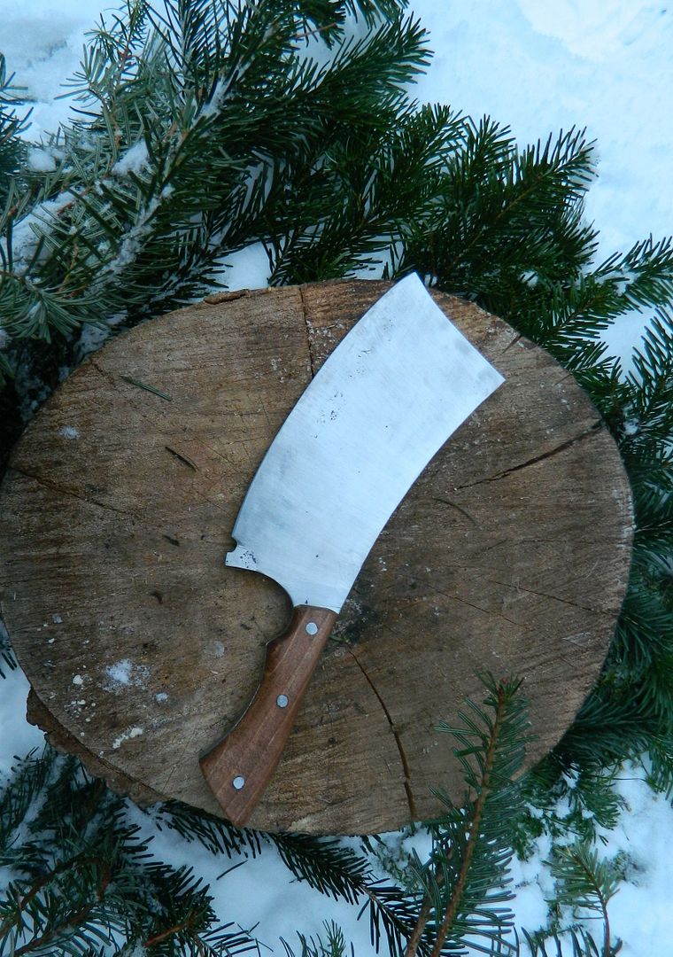

A couple of big wood chopping meat cleavers that I was commissioned to forge recently:
This one was from a sketch the customer sent me. We're both pleased with how closely I was able to match what he drew. The top edge is for chopping dead branches right next to the trunk, and is shaving sharp. The blade is 13 1/2" of 5160, the handle is two layers of marine epoxy-impregnated paracord over a foundation of neoprene.

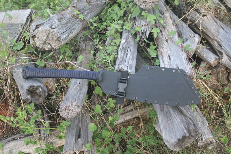

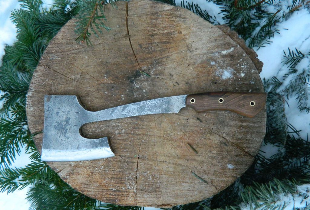

He also commissioned a Benghazi Warfighter knife from me with matching wrap. To give a sense of scale:
And a big two-handed carcass splitter with a blade 17 1/2" long, also of 5160, with a single layer of marine epoxy-impregnated paracord over neoprene. The handle is about 21".

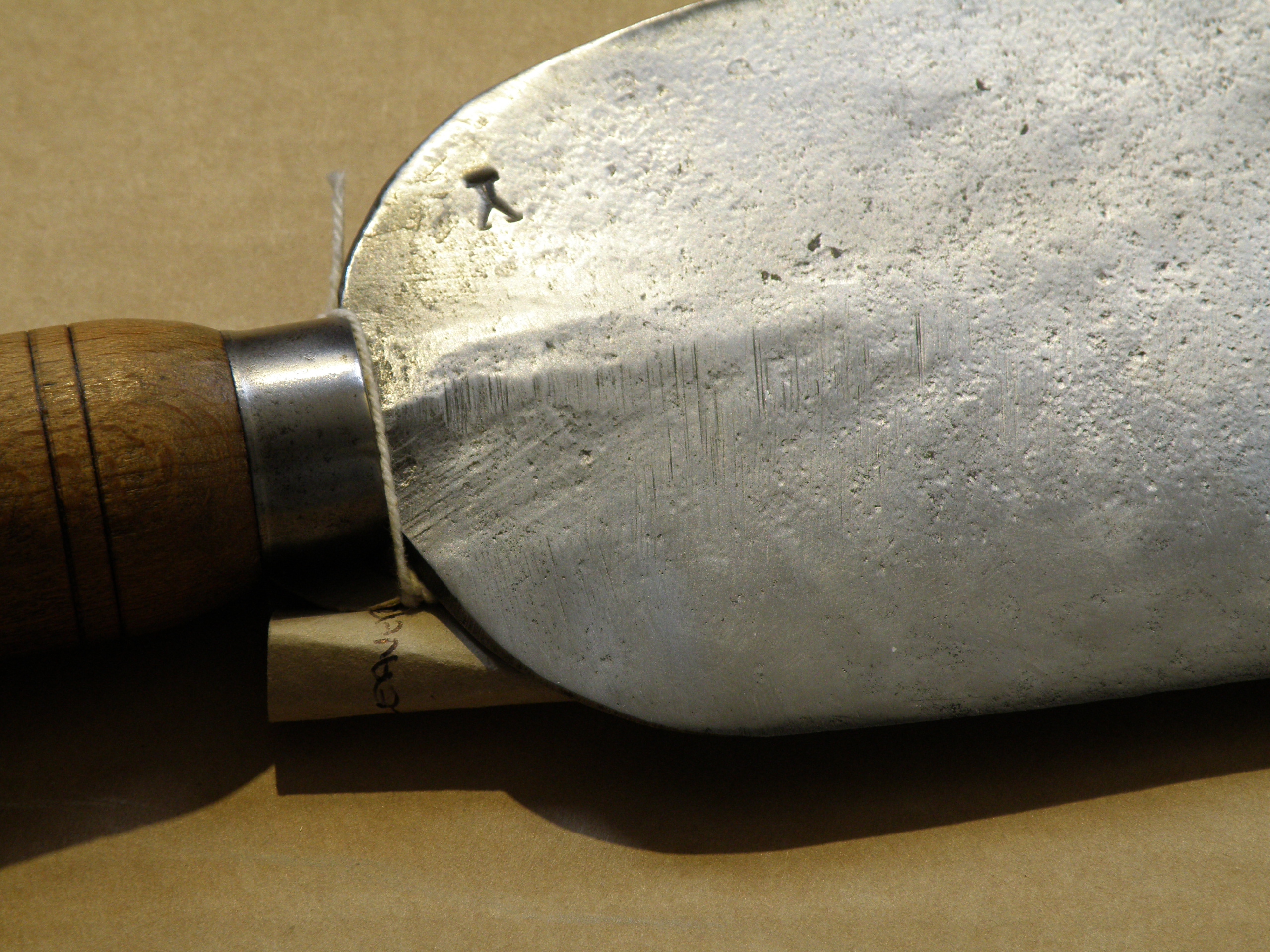

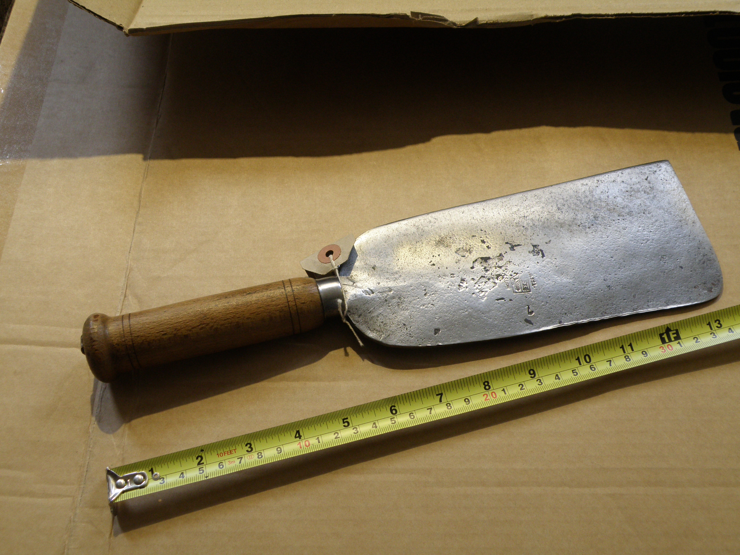

Hi guys. I bought this French cleaver at the Newark Antiques fair in Nottinghamshire, UK. The maker's mark (only partially made) has a picture of a shield with a castle on one half and what looks like a fern or a tree on the other. The first word of the text looks like trempé to me, which means tempered.
I don't think it's for using against a chopping block because the blade is not curved. I think it's a butcher's splitter, but maybe it's for cutting tree branches.
I got it for £20 and I think it's really great; check out how pristine the handle is.
