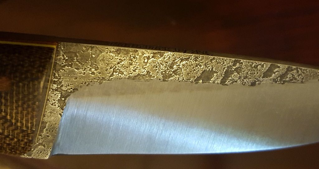

Ok, here's a report back with my first attempt at removing patina. So far so good :-)
The blade spalting was taped off and I did not get meticulous with exactly matching the curve of the spalting so I covered the spalting plus some of the area with patina. I figured I'd take baby steps, take my time and revisit the rest later.
I followed the directions of washing and drying the blade (prior to tape), and then used the folded paper town and Mother's polish method, wiping in the correct direction and did that for about 3 to 4 minutes each side. There was still some deeper/darker patina left behind.
Next, I reread the directions of using a strop with either pink or green material. I have a strop with green loaded but wanted to be more conservative with level of abrasion so I pulled out the DMT Dia-paste Honing Compound and again, went the least abrasive with the 1 micron paste. I stuck with the paper towel method rather than using a strop. The results were quite a bit better and immediate with patina removal. The shine came out, patina was removed and none of the grind lines were impacted. I removed the tape to compare the before and after areas and was happy with the results.
I haven't yet had time to go back and meticulously apply the tape more exactly just on the spalted area but thought I'd share my results so far. The 1 micron Dia-paste seems like a valid approach although it almost seems like taking the easy way out because it worked so well. I'd appreciate feedback regarding the Dia-paste for patina removal to hear if there are any cons.
Unfortunately I don't have a full patina before picture but this shows the patina that was hiding under the tape compared to the cleaned area below. Prior to cleaning, the blade wasn't terribly dark but was fairly dark (referring to the Embrace the Gray thread for examples)
Again, feedback on use of the Dia-paste would be welcome.
Thanks
Awesome work!! The Dia paste is great; I didn't mention it in the OP only because it isn't readily available for everyone. As you can see, the results speak for themselves!
Good job :thumbup:

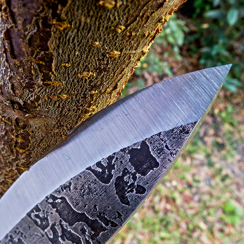

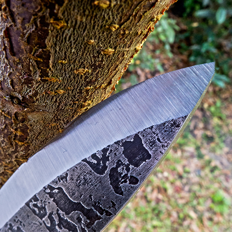

Knife Tip Field Repair, Part I
You are out on a trip, working with your tools and your hands and mind. At the end of the day, you are cleaning your blade around a fire. You look down, and the tip of the knife is gone! Maybe you can just barely see it, because it is still sharp up there, almost jagged. Maybe a large chunk of steel is missing. You need a fix.
The purpose of this post is not to offer professional restoration of a knife tip, although the knife can appear like new if you do it right.
Have time to ship a knife, to get it to the spa, to pay someone to do it? They will probably do a great job. This is the scrappy DIY version.
Presenting the KE Bushie, tip intact:
The tip of the KE Bushie slopes down gradually from the spine, terminating in a very fine drop-point.
In my experience, tip damage becomes obvious under a 10x or 20x loupe. Rarely, it can be seen with the naked eye. For the purpose of this post, I have digitally changed the image to show moderate to severe tip damage.
The tip of this KE Bushie has been broken off and blunted.
There are three choices when approaching tip repair. Repair from the edge side, repair from the spine side, or work on both sides.
I prefer not to regrind the edge. With this method, repair is focused on the spine of the knife.
Any coarse stone would work, or even a coarse rock. You could even try it on a concrete sidewalk. I prefer the Fallkniven DC4 pocket whetstone. It comes in a leather protective sheath, has a small profile, and has two working surfaces. One side is diamond, and the other side is ceramic. The diamond side is very coarse and can remove metal rapidly. The ceramic side is finer and can be used to hone a knife, align the edge, or set a microbevel (all outside the scope of this post). One final piece of equipment I use is a small strop loaded with Bark River's black honing compound.
To begin, you flip the knife so that the spine is resting on the stone. You raise the handle up and align the spine of the knife on the stone, near the tip, at approximately a 75 degree angle.
emaze.com said:
For this to work right, you'll want the spine side of the broken tip touching the stone, as well as a small portion of the spine. You will push and pull the knife at this angle along the diamond stone until the spine and tip share the same angle.
If the knife is very hard or the tip damage very severe, use only a pulling motion on the stone. Get too aggressive here, and you may break the tip a second time.
The result will look something like this:
Metal has been ground off the spine at a 75 degree angle to restore tip geometry.
In general, the tip damage and repair will be much more subtle than presented here.
In the field, you could stop here, but let's go a step further.
