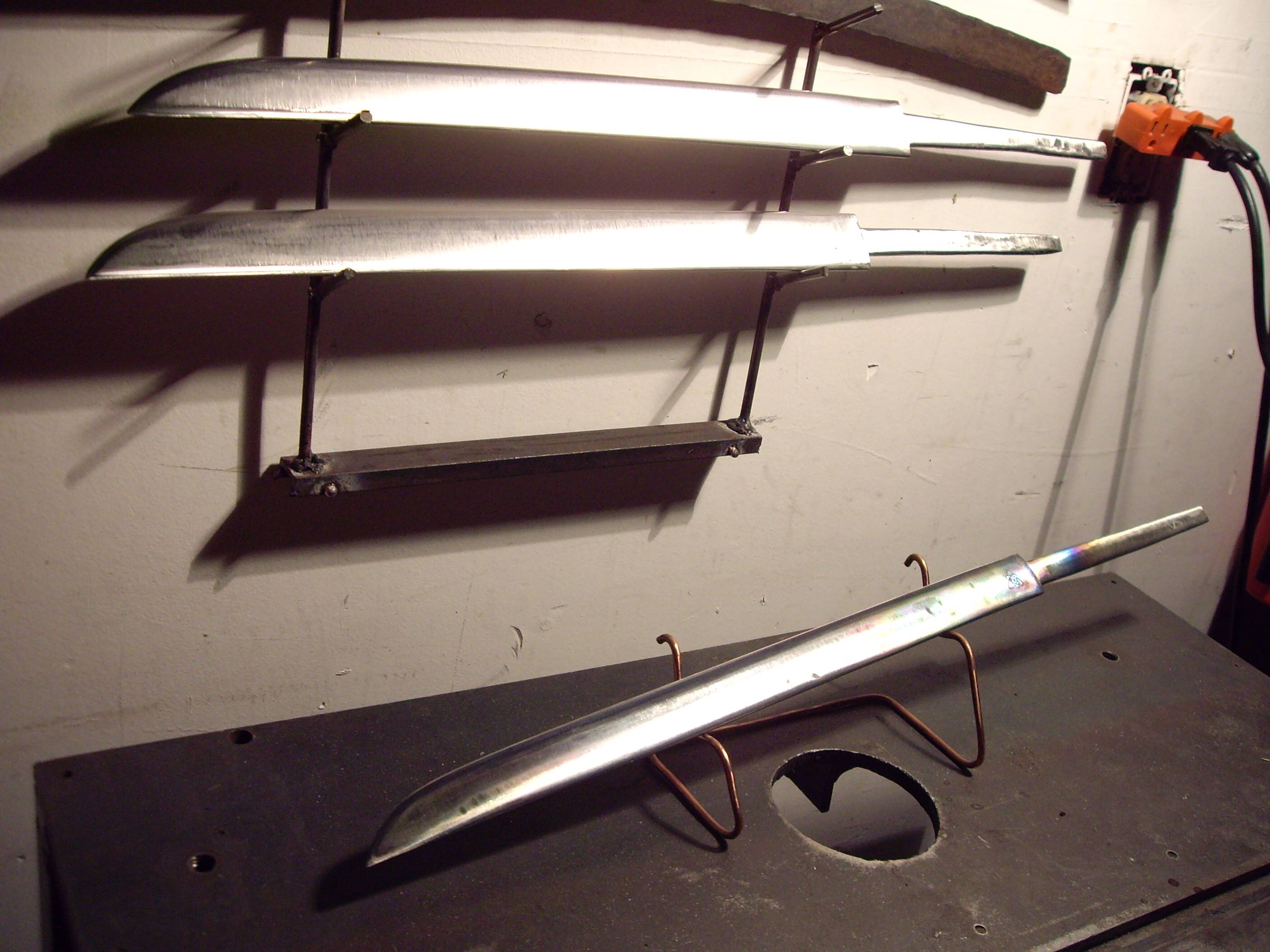

Hello folks,
Been working on several titanium knives and swords, including finishing some grade 5 experimental swords, so there should be be new photos coming along.
Here is a wakizashi-sized beta alloy blade, ready for quench-hardening! When it gets quenched, it will curve like a Japanese katana and gain tension within itself. It weighs 7.5 ounces. The blade is 17 inches, 24 inches overall.
-Mecha

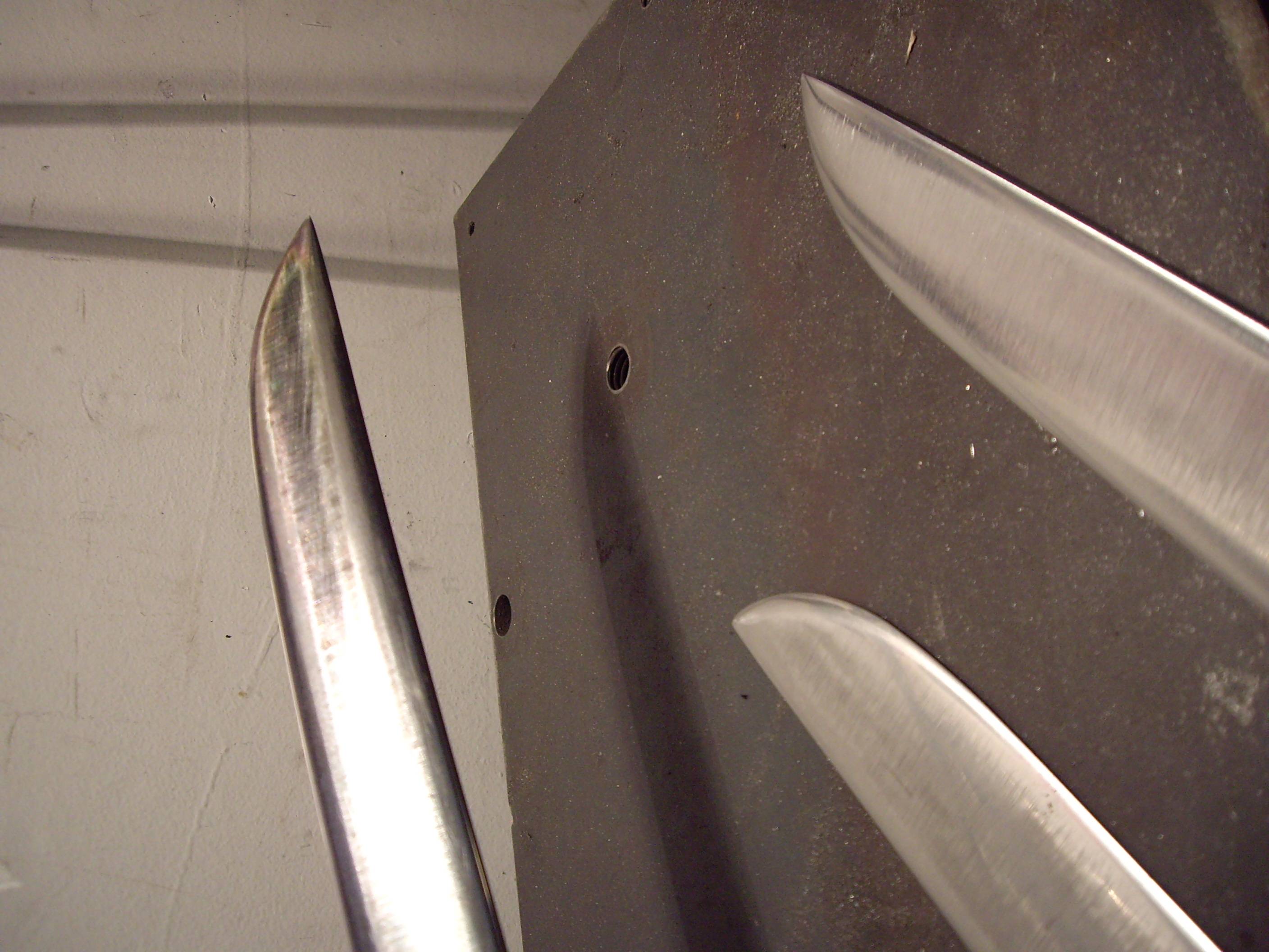

Don't worry Lycosa, there is plenty of blade work to do because I'll be at the 39th annual Oregon Knife Show in Eugene, Or, April 12-13, and will bring an array of Mad Science titanium swords and knives. I'll also bring in the S.A.M. hammer for display!
Below is the little wakizashi, after heat-treatment. The two larger blades are the time-lapse katanas from the forging video posted earlier. They also have been quenched, and are straight, ninja-style. These three (will the grinding NEVER end!?!) will be at the knife show, as well as a few others swords.
