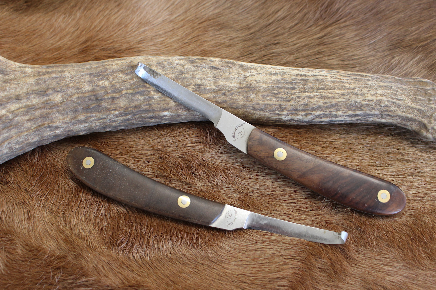

AEB-L @63 RC, 1/8" stock.
Made these two hoof knives for our local Vet Aug of last year. He uses them for digging out abccesses in horse hooves. He's estimated he's used them ever day at least once and more than once often. Come home from the ranch the other day and now Oct of 16 they finally need resharpening. Real world stuff.

That's interesting..so what would be the hardest thing that blade has to endure. I'm taking it he doesn't scrape bones or cut through anything overly hard but I could be way off?
