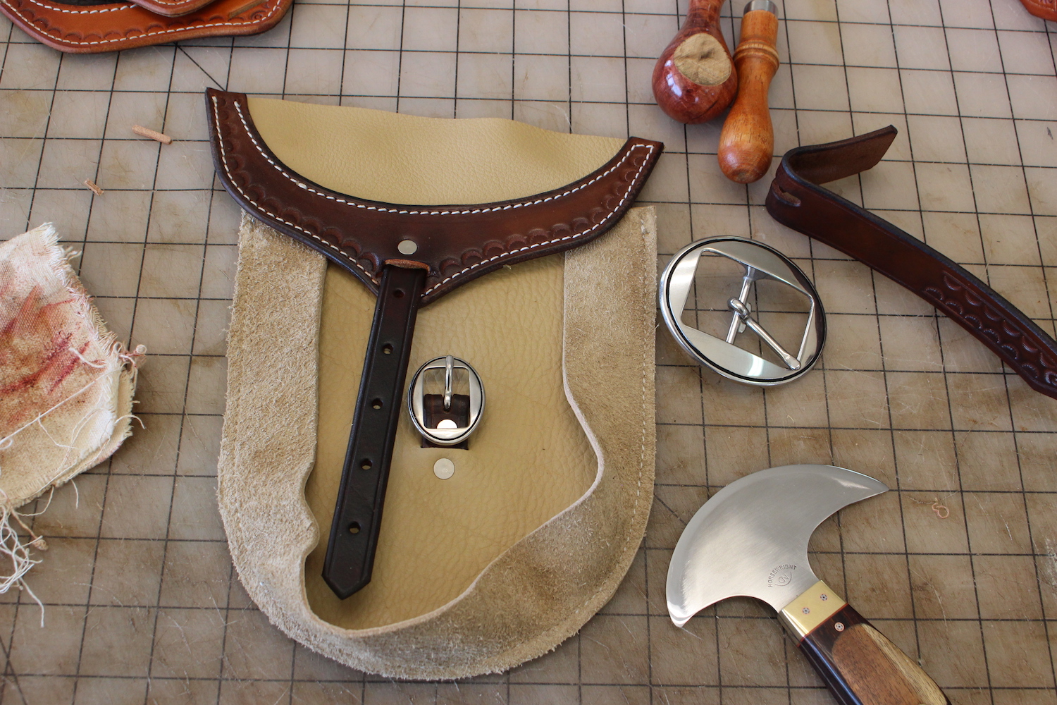

The roundknife in the pic below I made. Its my own personal one. Its job is to cut leather by the hour, sometimes all day long and its used daily. It too is AEB-L @63 RC. It sees a stone maybe every 6 months. It will get stropped quickly 3-4 times in a day of cutting. It cuts heavy leather for a living.

That's impressive sounds like it's much more wear resistant then id have thought. Hell I don't even think my 154cm iv had came close in edge retention.

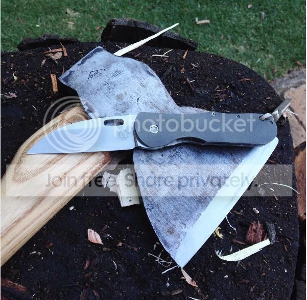

Here is my grandfathers carpenters axe with a 20-25 degrees inclusive (70 year old axe head). I replaced the handle. It was used in gold mining and I have only maintained the edge at that angle. Recently split around 40-50 pre-cut logs containing nots with some blunting through rolling, but no fractures of the edge etc.
