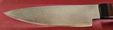

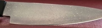

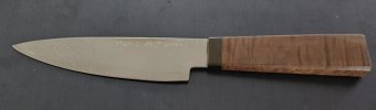

Got this kitchen knife done for the show this weekend. Dragon Skin Damascus by Delbert Ealy with ringed Gidgee/ebony wa handle. Hard to get a good shot of the pattern in the dining room light. I sand to 400 grit and then use a Scotch-Bright belt for a vertical texture finish. Then I buff well to make the nickel shine and leave just a trace of te brush finish to make the scaled look. The vertical brush lines are not nearly as obvious as the blown-up photo makes it look.

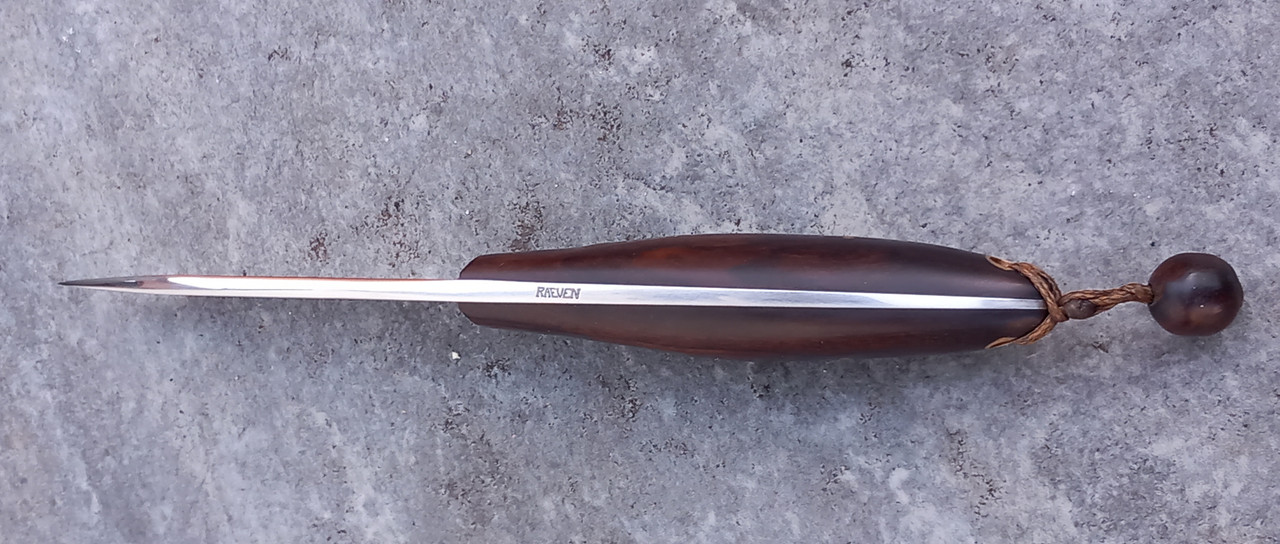

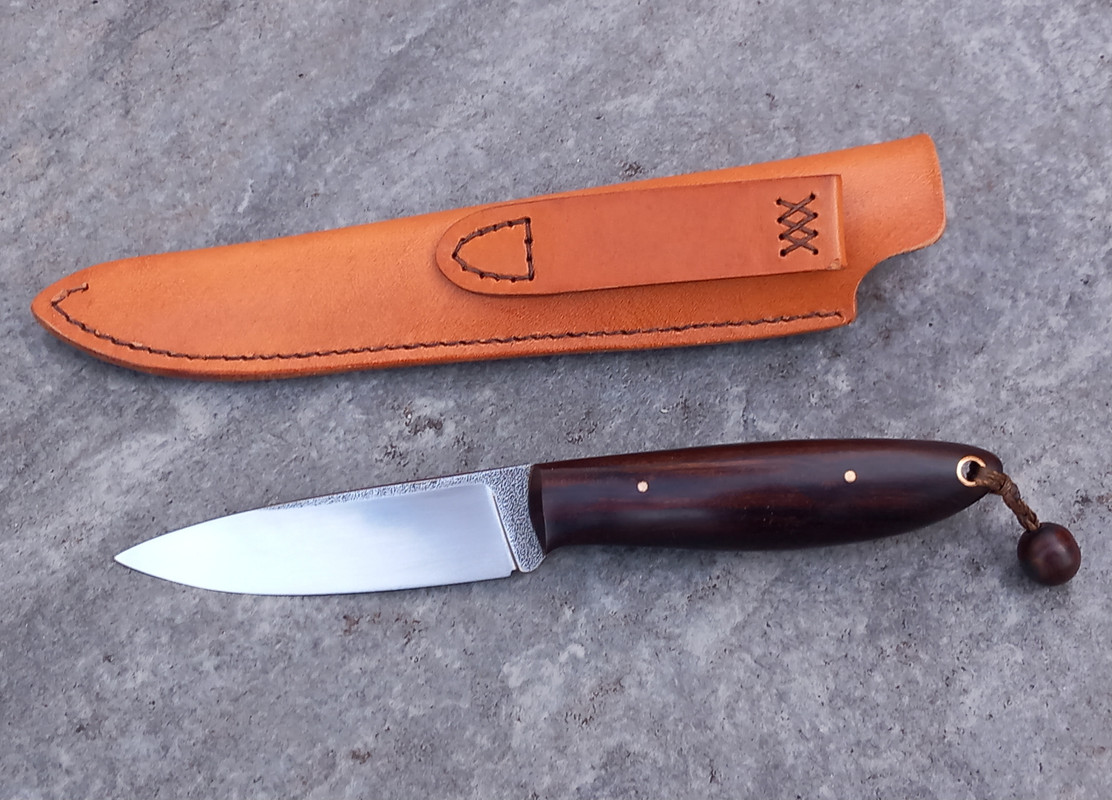

it's tough for me to not attend to all the little details, so I'm proud of myself for letting this knife go- scabs and all. Still has layout lines! It's going to a friend, and although he deserves a nicely finished knife, I want him to use this one without fear of fucking it up. I got it finished up yesterday.

Your leatherwork is equally amazing.
