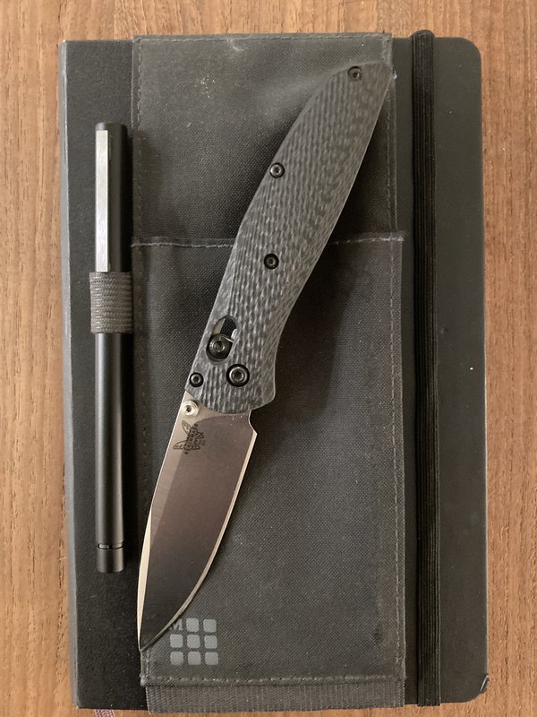

Many thanks for your detailed info on your beauty.- REK 940 Reblade in Vanax 37
- Benchmade 940-2 donor knife
- All hardware and screws are bronze TI from xxxadrenalinxxx
- Liners and clip are Cerakote Midnight Bronze with 25% Cosmic clear.
- Scales are FatCarbon CF with Far Carbon Raindrop copper cross cut inlays and pivot collar from DOAT (Deathgrips or Deathofallthings)
The action is butter with stiff lock up in all directions. Blade is perfectly centered with no tweaking to force a centering of the blade.
Sharpened to 8000 on Edge Pro with Shapton Glass stones. Cuts like a lazer!
Build took some time to acquire all the right parts and I had a failure/setback trying to use some TI scales that were found to be out of spec in front of the pivot.
Only negative is the TI lock bar has a galling feel just at the detent on close. Running some black marks-o-lot to lubricate for now. My Bugout eventually broke-in this way. Oil is not your friend with TI on steel. Graphite (lead pencil works), permanent marker or wax is suitable and easily acquired.
