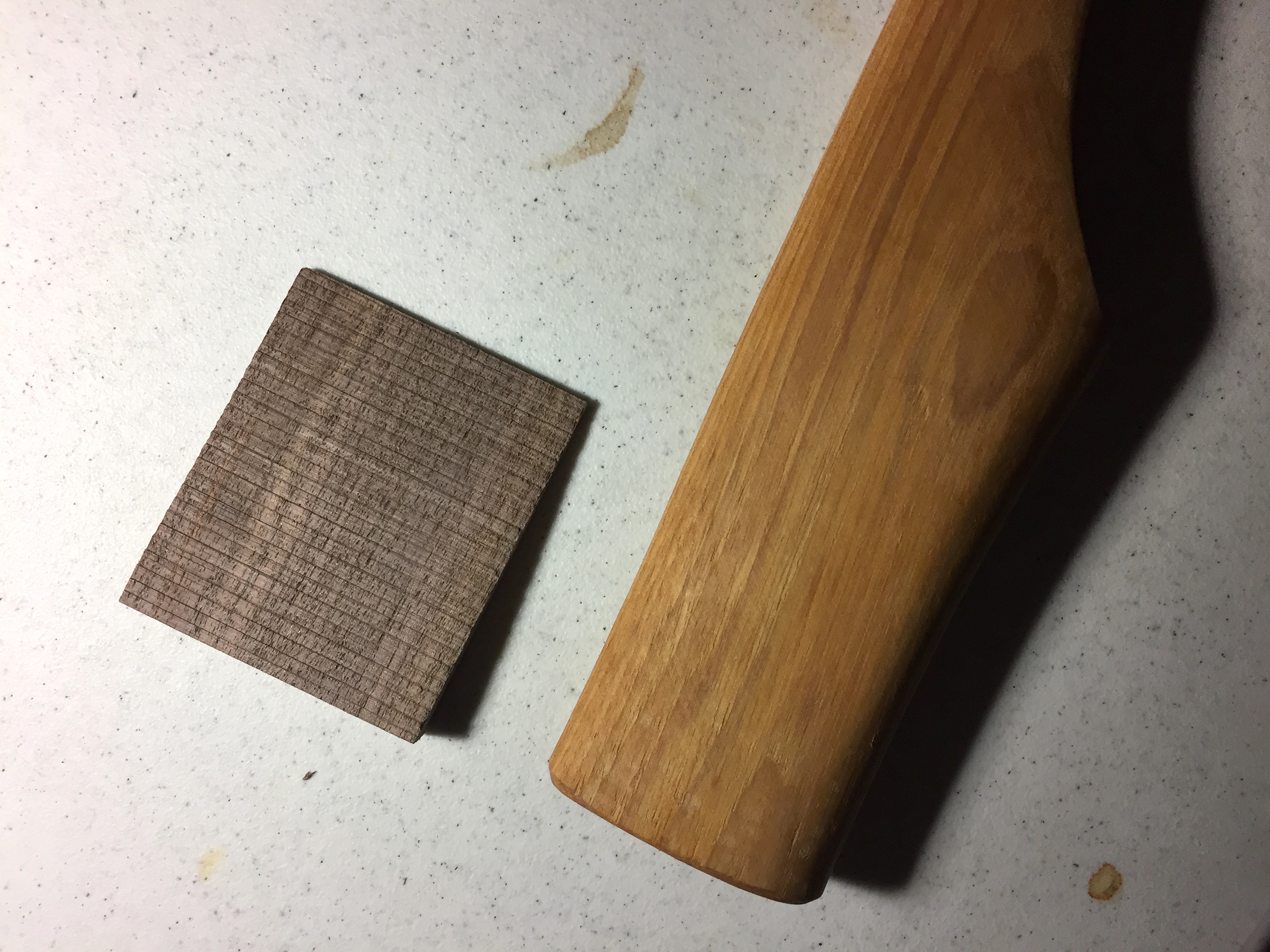

I haven't made my own yet but if I did, I would use my local hickory most likely (cuz I got tons of it). I generally use the wedge that comes with the hafts I buy. Usually poplar. But the Hoffman haft I used recently came with a lovely walnut wedge which is a pretty nice touch on top of a nice haft.

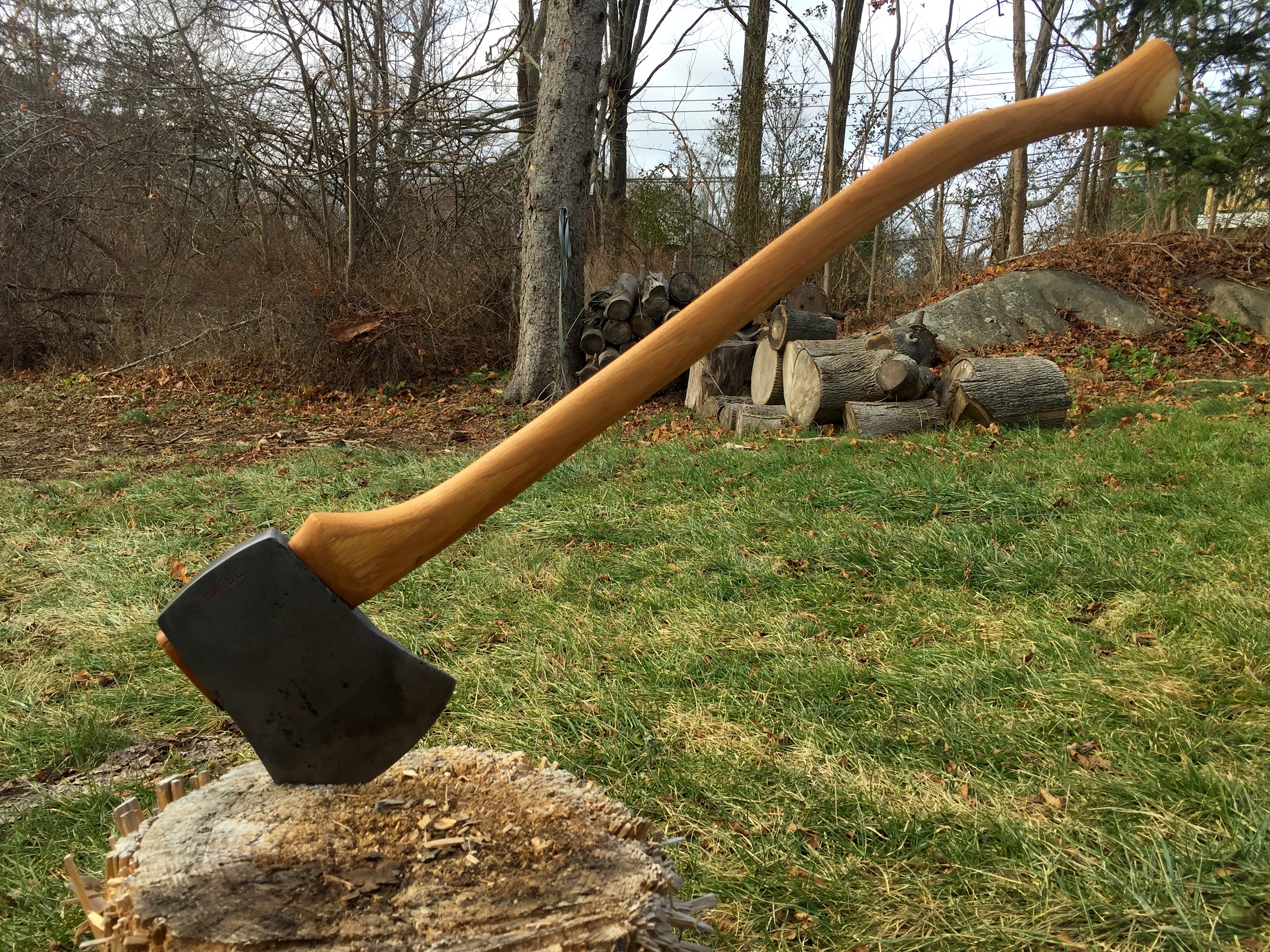

ok, wow, a couple things
1. great hang - looks good
2. how is that hoffman handle?? please post pictures!!! where did you get it? and how much was it if you don't mind telling.
3. what pattern head is that? it has almost zero poll and flat cheeks - reminds me of the tasmanian axes we've been talking about in the it followed me home thread

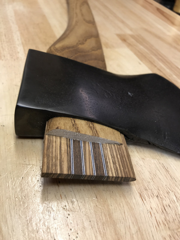

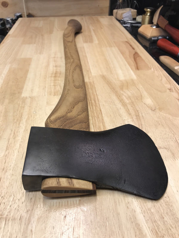

Thank you again. The haft is 32" and about as close to perfect grain as I have seen. Very slender. I'll see how it holds up but I expect good things. I am picky about the grain in the hafts I select and I could find nothing I liked locally. I hate ordering hafts on line as I am frequently disappointed by what I get.
Good eye (haha) on the axe. It is indeed a Tassie, shipped to me from Australia a few months back. An Elwell 4 1/2lb, made in England. The head was a good deal, shipping was a few dollars less than the head. So another $45 spend on the haft brings the total package to right around $150. I reckon it's cheaper than a Hults Bruk Arvika 5 star that I frequently lust after. I think this axe looks better and may even be a better axe.
I've only put a few swings in with it so far. I like it a lot. The overall shape of the haft is pretty different from my other axes, but it actually feels easier on the wrists. Come spring it will start to see some heavy use. I'll be able to make a better assessment of the haft after it gets a work out. In any case, I could babble about this build, but the pictures say the rest better than I can.
THanks! Very cool axe! That is a beautiful handle, and with a pretty serious bend at the grip. I love that it has a proper swell at the end - something that I really want on my handles. The head looks to be in good shape also. I'll be interested to hear a full assessment after you put it to work this spring!

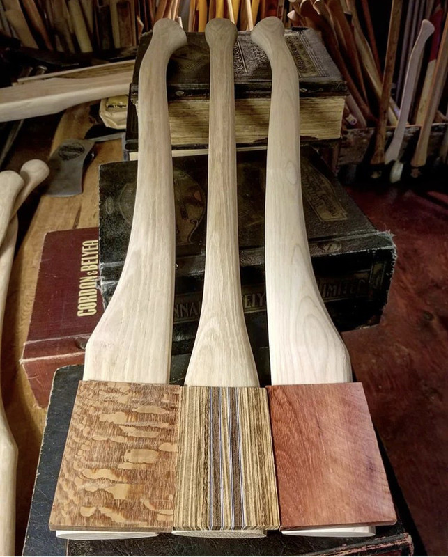

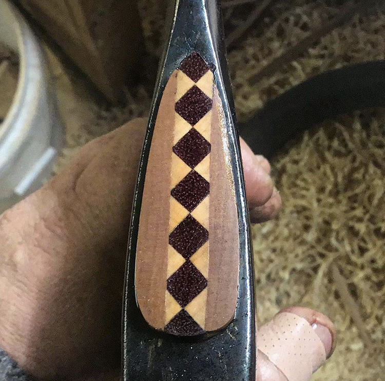

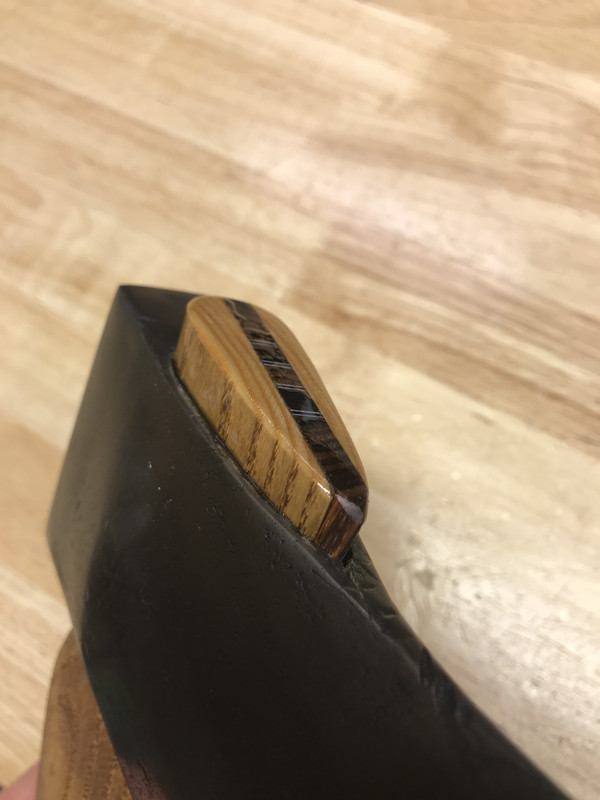

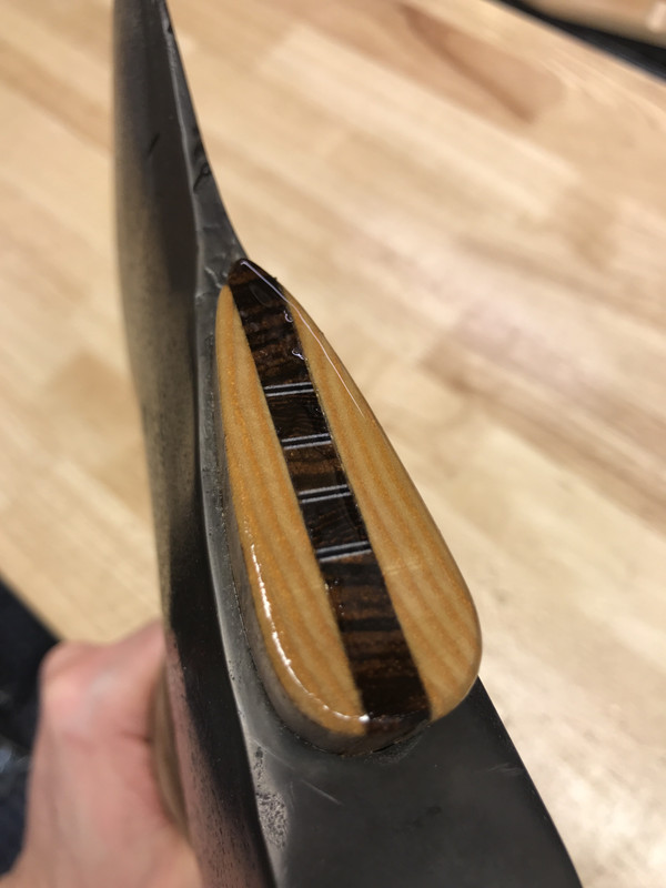

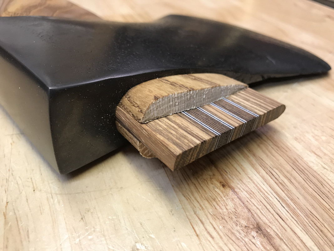

Trying to step up my wedge game a bit with some wicked wedges that Colby from Owen’s hooked me up with!
Bloodwood, leopard wood, and a laminated one that has subtle detail.
