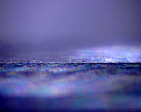

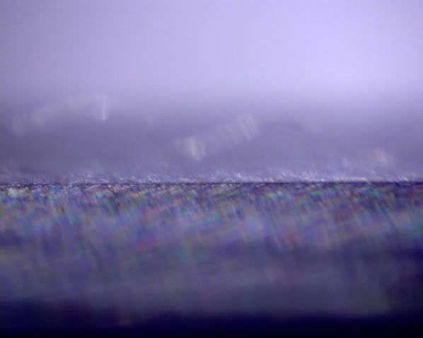

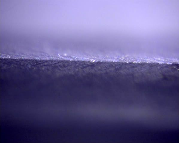

Nothing gives a better understanding than pictures :D
I used my JYD (CPM-D2 edge) as my test subject for the following photos. Starting the the DMT fine stone and finishing with 1 micron diamond compound you can see what is happening with each stone. These pics are of the cutting edge looking almost stright down. All pics are taken at 200x :eek: unless otherwise stated.
DMT fine
DMT X-fine
DMT XX-fine
DMT XX-fine at 400x
At this point the edge will effortlessly whittle hair, pushcut papper, and start to tree top hairs. This edge was also done by hand using the soap and water method on the stones.
Hope these pic's help in some way.
