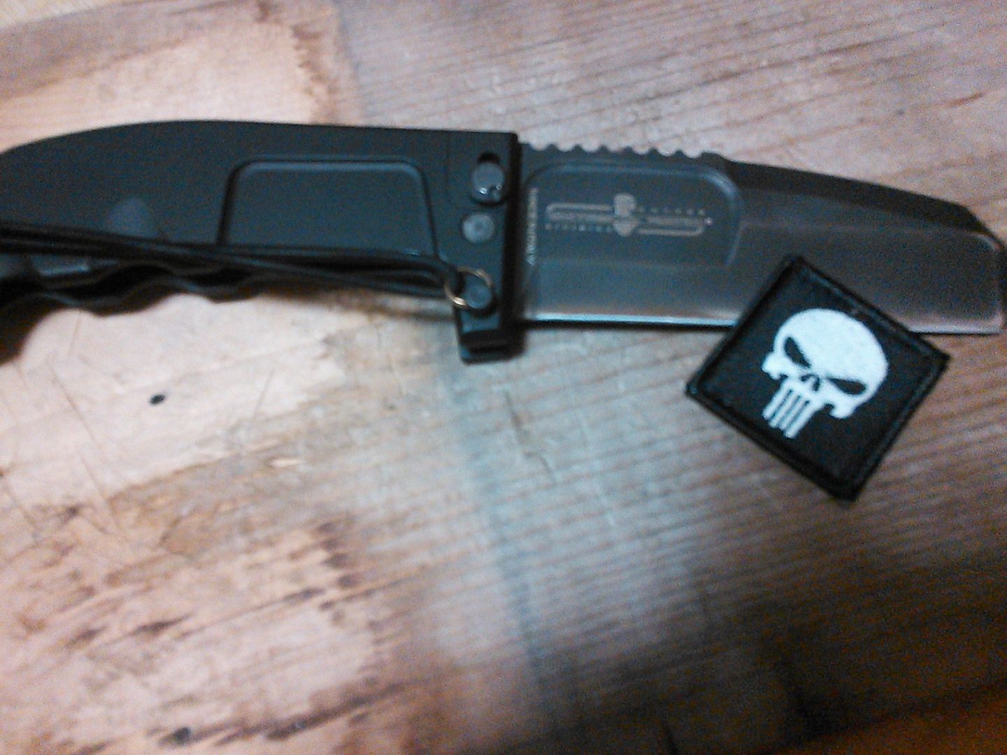

The Rao will lose. The soft aluminum will bend/fail if you spine whack it. Even with the additional pin what happens is the stupid soft aluminum that is also stupid thin (not referring to handle scale thickness) deforms if you spine whack it. Blade play is huge after spine whacking.
I know cause I f-ed up my Rao and another ER folder (pin in the backlock lockbar sheared off after low level spine whacking). Henceforth, no more Extrema Ratio for me. What a waste of cash, it ain't cheap.
However I firmly agree with you here, the aluminum is likely to shear on the RAO before anything else.
