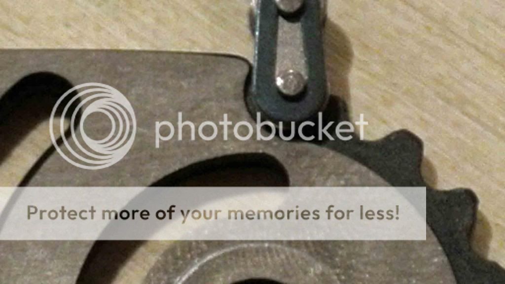

The red circles indicate the only metal keeping the blade from flying out of the handle, metal that functions as a focal point for lateral (side) loading of the blade, metal that shares the vertical strain of use (stretching) as the tang cut-out rests against the stop-pin. Did you mention whether the handles were steel or aluminum?
What concerns me: This is obviously meant to be a knife that can handle a LOT of stress, but its design is inherently weaker than most I have ever seen! Every lateral & vertical load or impact threatens to break the blade from the thin tang-arms that hold it to the handle, not to mention the stop pin resting in aluminum rather than steel, making it lighter but also more easily deformed against the stresses described above.
Perhaps these concerns are unfounded in practice, but theoretically this may be among the worst designs I've come across in terms of strength. A knife is only as strong as its weakest point. The rest is just 'gimmickry' - very neat, but meaningless if the blade snaps off from the handle.

Your circles are quite misleading, and I hope this just an oversight and not intentional. They and the wording of your post seem to indicate that the metal in those areas is limited to that which is brushed, ignoring the metal that is finished in black Guncote. Ironically, your lower circle does not even indicate the narrowest place on the spine, which is at the very bottom of the stop pin slot.
Here are better photos of those two areas, the smaller of which mics at 0.120" wide by 0.150" thick:
Additionally, the stop pin only bears stress until the button is released. The steel button then wedges into the gap between the fourth and fifth teeth, providing 100% of the lockup against opening and closing forces.
These areas are likely the weakest points of the knife, but they aren't as wafer thin as you are suggesting, and they have not proven to be a failure point for any of the knives used in testing over the course of three years.

No intentional oversight, I am glad to see there is a tiny bit more metal than the brushed area, and thank you for the close-up shots, though I still do not see any irony or where i missed anything... did you mean on the belly where it meets the stop-pin? I could have circled that spot as well but as it is housed within the handle it is less likely to become a fulcrum-point for side-loads against the blade than the spot I indicated under the choil.
Thank you especially for the measurements that indicate just how much metal supports the structural integrity of this blade, namely two arms ~1/8 x 1/8". That is the entire strength of the blade... basically two prongs on a fork. How difficult is it to cause a fracture there? Please demonstrate the strength of "the world's strongest auto knife". I am glad to hear that you haven't experienced failure in your testing and even noted that my concerns may be "unfounded in practice", but this design remains inherently weaker than almost every other design out there as a simple matter of material strength.
Now if you really think that the other thin spot in the tang is weaker than what I've indicated, that isn't exactly good news, but it is again a simple matter to test and demonstrate.
Regarding the lock-button bearing stress rather than the stop-pin, that wasn't even my criticism - the handle is aluminum, isn't it? With no steel liners? Heavy use will deform the aluminum faster than it would deform steel, another inherent weakness but an asset in reducing weight. The lock-button functioning as stop-pin is great, though it must share the stress with the internal stop-pin, yes? That would be a good thing if the tang-track was so machined. But again, the little tang-arms supporting the blade share the stress of use as well (as does the pivot).
Another thing i do not understand about this design - if you don't need the stop-pin to lock the blade open and endure stress, why even have one??? The lock-button can act as both stop-pin and blade-lock and blade-stop when the knife is closed, you don't need that internal stop-pin and routed tang at all... ?
My apologies if you have taken offense, but the flaws in this design are too glaringly obvious for it to go un-commented upon, especially with the claim of "strongest" in your first post. I have no axe to grind and intend no personal offense. I also do not see why you cannot easily improve the design and keep the chain-drive gimmick to sell it as unique. (I avoided mentioning the risk of debris and corrosion impairing chain flexibility because I assumed that issue had already been addressed prior to production... then again, perhaps it has not been)

I don't understand the criticism of the knife and why the red circles? How is that the weakest point of the knife? I'm no engineer but the areas don't look like stress areas to me when the knife is closed or opened. And it looks to me like they are machined into the steel that is gun coated too. The knives are expensive but I am finding out more and more you get what you pay for. I agree with the shovelhead comment too. My primary chain doesn't seem much affected by much of anything as long as the tension is correct. And then it effects shifting more than anything else. Beats me folks but opening and closing a knife close to a half million times before failure is pretty good in my book. keepem sharp
If a knife fails from simply opening and closing, there is a problem. Spring-failure is the usual cause of this as that is the ONLY place where the tool is being stressed. This design uses very long springs to try and reduce the wear, makes sense ... IF that is the only thing you use the tool for, opening and closing.
But a knife's primary purpose is cutting. This knife is quite thick, reducing cutting performance substantially, but that thickness is obviously there for a reason, namely strength and toughness - both vertical AND lateral. The length and thickness of the blade demand increased force from the user, and all of that force will end up concentrated at the juncture between blade and handle, where the support metal is reduced to two meager prongs of hardened steel, each ~1/8" x 1/8". On top of this is the lack of material strength supporting the lock-button/stop-pin, etc. since the scales appear to be linerless aluminum, prone to plastic deformation with hard or extended use.
A tool is only as strong as its weakest link.
If this is simply a Yo-Yo, meant to be opened and closed but nothing more, then indeed it will last quite long because of the springs.:thumbup:
But if it is meant to be used as a knife, it appears to have all the strength of an Opinel without the impressive cutting geometry. Repeated impacts (e.g. batoning, chopping, a spine-whack) may soon result in deformation of the aluminum around the lock-button if not failure of those little steel arms and loss of the blade :eek: Lateral stress (i.e. prying) will bend a thinner blade, maybe result in a broken tip, but that won't happen here because the blade is so thick... instead, the blade is likely to snap right out of the handle at those little arms.
The design is like a badly made rat-tail tang on a fixed blade - insufficient support for all but the most meager tasks for which a thinner, lighter knife which be much more appropriate. So what is the point of this design? Either it is a mistake or the knife is simply intended as an expensive display/conversation piece or a Yo-Yo. In either case, it is hardly "designed to be the world's strongest auto knife."
And again, I intend no offense to anyone in this, and I would LOVE a video demonstration of just how much stress this knife can handle, but from the images alone I'd have more confidence in the strength of a Buck 110 (to use a random example).
If the tang-track milled for the internal stop-pin where eliminated from the design, and steel support placed around the pivot and lock-button, THEN the design might compete for strength with other knives of similar size. It's great that their springs take so long to wear out.
