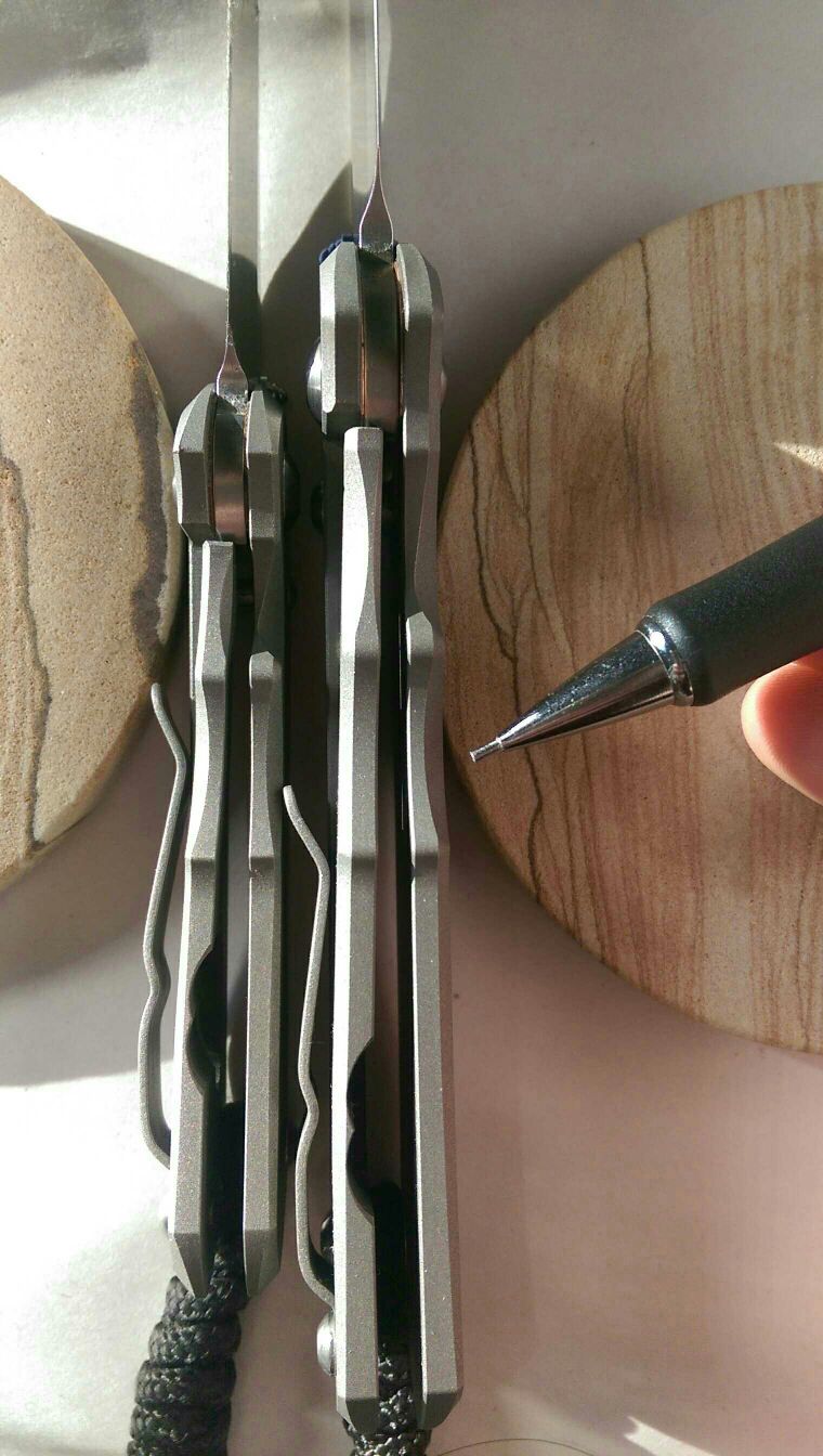

However, the one thing that really bugs me is the second finger groove chamfering on the lock side doesn't match the show side. It makes it look unfinished to me. I hate it. Lol
Here's what I mean... small Inkosi on the left, large Inkosi on the right.

I'm sorry to hear of your shattered dreams. That tends to happen when we create things in our mind in the image of our ideals.
On the bright side, it's a good problem to have!

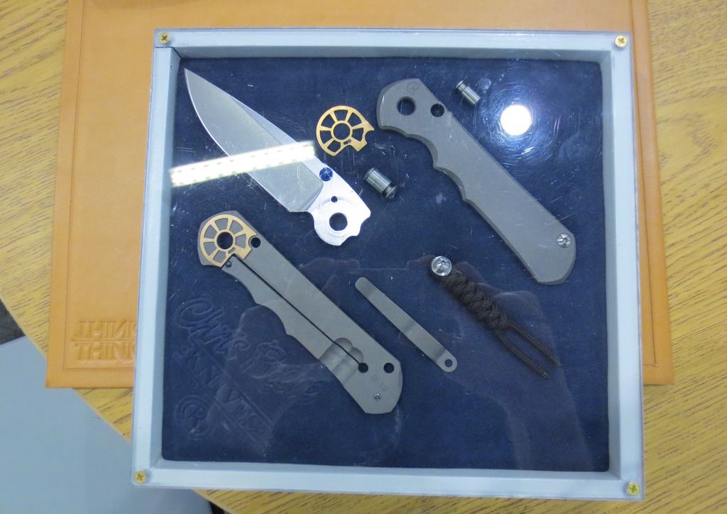

The washers on the small Inkosi seem to be different so they don't leave spaces to collect gunk
If the first version of the large has that problem, maybe they will just make new washers that close up the top two holes a little

In regards to Large Inkosi washers.......ahem......total fail CRK people!!!! You got the concept perfect on the small inkosi, with the occluded holes when the knife is closed. That was a major, major win. What the heck????? Why abandon the idea on the large. Sheesh......its two steps forward and one step back. Fix that goof-up before these go into mass production. Do it for the people!!
Yeah. The washers and the missing finger groove chamfer should be addressed asap!
Otherwise I love the surface area from the oversized washers. Super cool. Can't wait to try one.

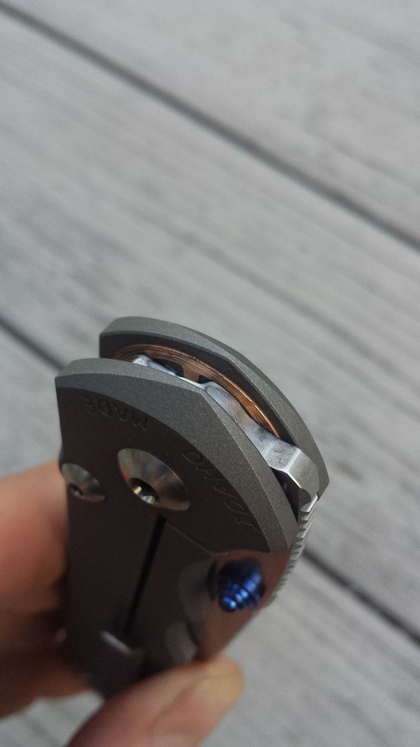

The first change that immediately stands out, and arguably the most important physical change is the angled pocket clip.
Hopefully this moves the clip ever so slightly, in that people who can comfortably hold the 25 now, can continue to use the Inkosi, while allowing those who found the clip was a hot spot to find a suitable grip. We need some measurements here, hopefully those will come soon.
Here is a pic by BF member Shayjoshi, used with permission:

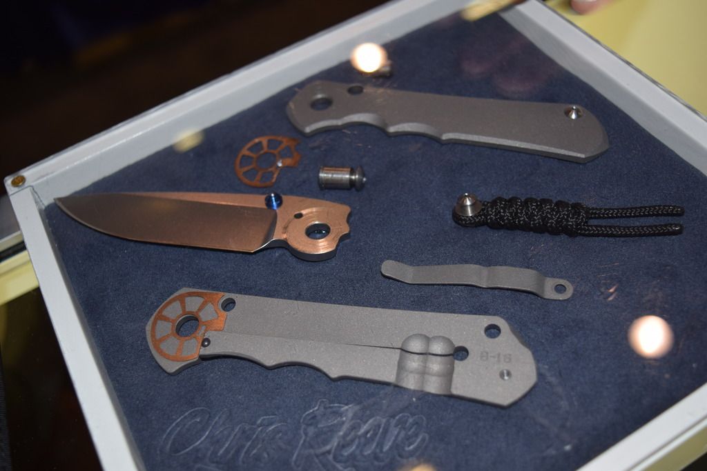

Next up is the stop pin which has been replaced by a floating stop pin. The pin is also larger in diameter. I can't make out the details completely but the pin is secured into the lock side scale with a single fastener, then sits in a corresponding hole in the presentation side. Again, please chime in with measurements or more pics.
Here is a pic from this thread:
Next up:

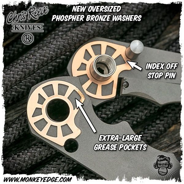

New washers, twin washers in fact. The first thing one will notice, is the positioning tab from the 25 washer is gone. These are probably a necessary change as it will allow equal support on both sides of the blade, as the lanyard pin is the the only part of the knife firmly securing both scales together. The washers butt against and are indexed off the stop pin, easy for maintenance. I think that is correct. Important to note, the large Inkosi, unlike the small does not have sealed washer pockets. They are actually quite open. I speculate that these will foul much faster than the 25 when carried in the pocket.
Pic by BF member 91bravo, used with permission:

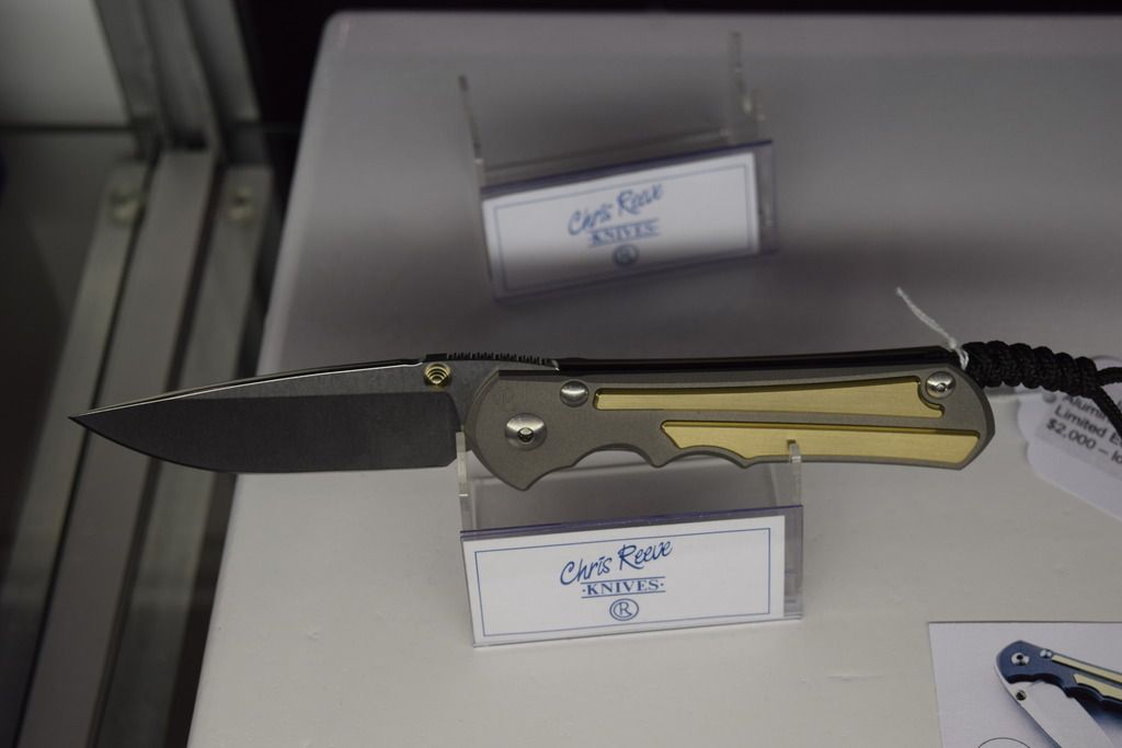

Inlays have a new shape, waiting for a straight down pic, and a pic of the back.
