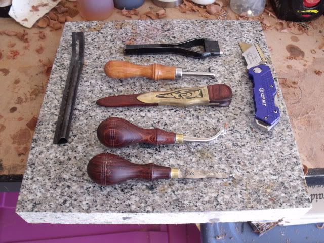

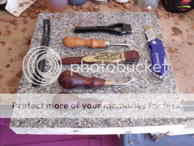

Here are the tools I use most.
The tool on the left is a safety skiver, it is used for thinning down or Skiving leather.
On the right is a regular utility knife with replaceable blades. There are many options for cutting leather, but I like these utility knives because they are cheap and the blades are replaceable.
From top to bottom in the middle are:
Bag Punch- These are used to cut slots in leather. They come in various sizes depending on the size of the slot you need.
Stitch Groover- These are used to cut a groove in leather fro laying out the stitch line. By cutting a groove you are able to lay out you line for stitching and the stitching sits in the grove below the surface of the leather, which reduced wear on the thread.
Slicker/Bone Folder- These are used for forming, molding and burnishing leather. Bone folders can be made of many materials; bone, plastic, or in this case hardwood.
Overstitch Wheel- These are used for marking stitch placement and cleaning up lines of stitching.
Edger- These are used to round off the edges of leather.

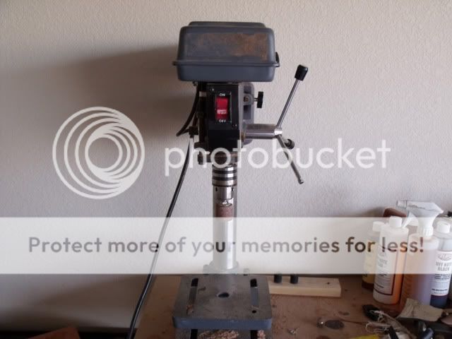

Drill Press- A drill press is one of the handiest things to have for leather working. A drill press can be used for making holes, sanding, and as a press to install rivets and snaps. I use mine constantly.

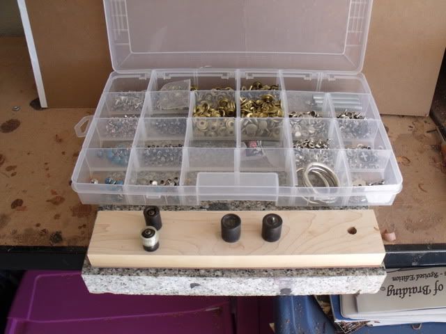

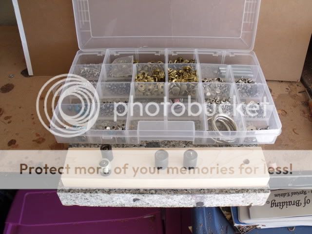

Snaps and dies- Snaps are of course used for a variety of purposes on sheaths. The dies are used to install the snaps and rivets, instead of a press I use my drill press.

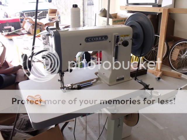

Sewing Machine- In order to sew sheaths you need a heavy duty sewing machine. My machine is a Class III harness machine capable of sewing over 3/4" of leather. Having a sewing machine like this saves a lot of time and effort.

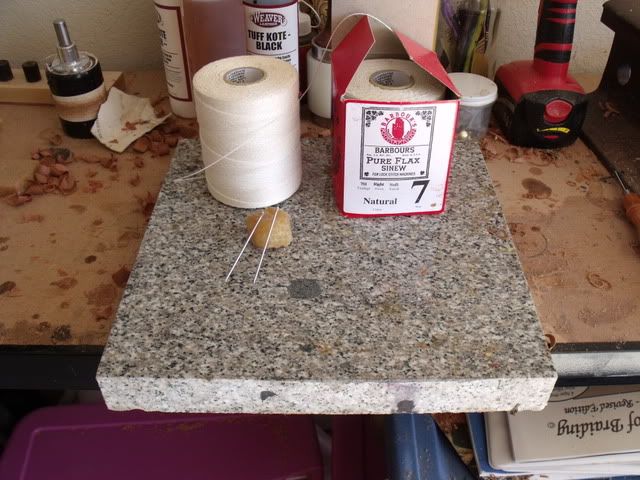

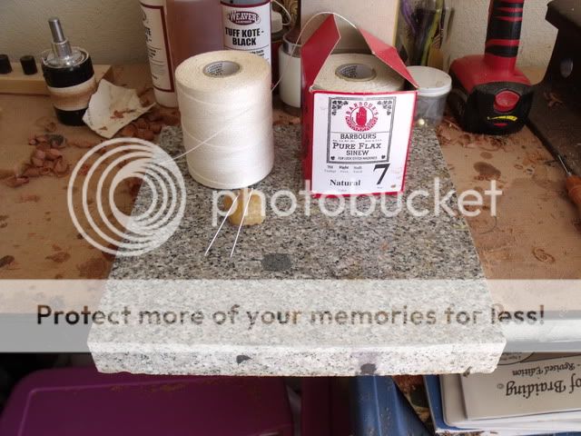

Needles and Thread- Hand-sewing is the best method for stitching leather but is more time and labor intensive. For hand-stitching you need 2 harness needles, wax, and thread. Regular needles will not do the job, harness needles are designed for sewing heavy leather. For thread I use Barbour's linen thread and wax it my self with bees wax.

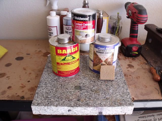

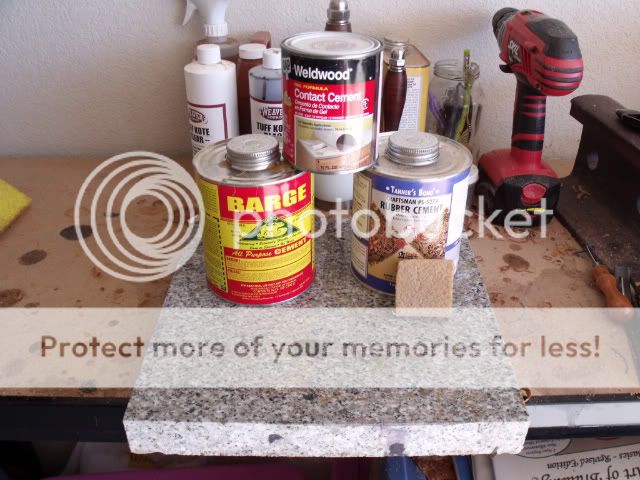

Adhesives- For permanently bonding leather Barge Cement is the glue of choice. DAP Weldwood contact cement also works very well and is widely available in home improvement stores. Rubber cement is used for temporarily gluing things together or where a less secure bond is acceptable.

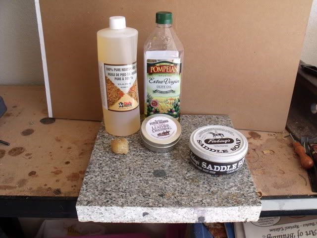

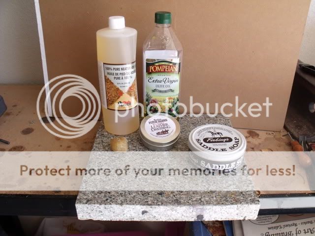

Finishes- There are many different kinds of finishes available for leather. I prefer natural finishes. Neatsfoot oil and or vegetable oils, such as olive, canola, etc, are used both to replace oils in leather and to darken leather. You can darken natural leather by oiling it and placing it in the sun. Leather will turn darker just like your skin.
For top finishes I prefer bees wax based finishes such as Montana Pitch Blend or Obenauf's LP. These finishes are god for the leather, natural, and they smell good. These type of finishes provide good water repellency while still allowing the leather to breathe.
Saddle soap is used in the edge burnishing process.

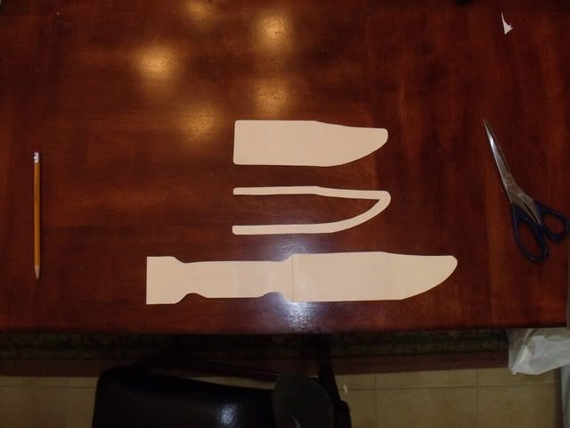

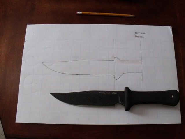

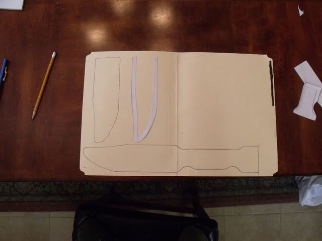

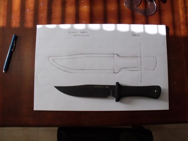

The first thing I do is trace the outline of the knife on a large piece of graph paper. Once this is done I decide the dimensions and design of the sheath.
Once I have laid out the sheath, I cut the pattern out in stages and transfer the pattern to a suitable stiff media. Poster board, manila folders, old cereal boxes, or pretty much any thin type of cardboard will work.
Then I cut out my patterns and trace them on my leather. When tracing your parts there are a couple of things to keep in mind. One, I always lay everything out on the back side of the leather. Two, be sure that you pattern is oriented with the proper side facing up. Having your pattern upside down is a surefire way to make a left handed sheath when you were trying to make a right handed one.
Once the parts are laid out I cut them out using my utility knife.

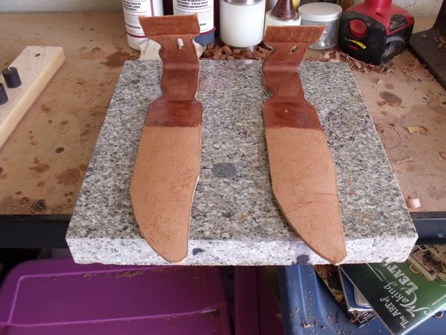

The pieces, from top to bottom are
Back piece, which will be folded over to form the belt loop.
Spacer/Front piece, which gives the guard of the knife a place to rest, keeps the sheath nice and flat, and make for a sturdier sheath IMO. The spacer piece is the exact same shape as the front piece.
Welt, the welt is sewn into the sheath to protect the stitching form the edge of the blade.
Now begins the construction.
The first thin I do is take the back piece and form the belt loop. In order to form leather you must first wet it. If you do not wet the leather it will not form well and is prone to cracking.
When wet forming leather there are several things to keep in mind. Wet leather is really easy to mark. The slightest thing can make a permanent impression so you must work in a clean area, on smooth surface, and ensure that your fingernails are trimmed. You can even transfer fingerprints into the leather if you press too hard.
For folding the belt loop on a sheath like this I run the leather under the faucet until the entire piece is wet. I wet the entire piece so that the whole thing will be the same color. If you only wet the part you want to bend you may end up with a different color where the water was.
Then I take and press the pieces under two pieces of wood lined with leather (two strops I made that are now used for this purpose) and weigh them down with a piece of railroad rail. I leave the pieces there for an hour or so them take them out and let them dry.

The next step is to glue the welt to the spacer.
Since the grain or smooth side of the leather is on the inside of the sheath and the welt gets glued on both sides I have to rough up the leather. If you do not rough up the leather may not get good adhesion. I use 80 grit sand paper for this. Before I sand the leather I mark where the welt will be glued so I only sand the portion that needs it .
When gluing leather together be sure to follow the manufacturers directions.
Once the pieces are put together I go around the area that was glued and tap it with a smooth faced cobbler's hammer. (Sorry I forgot to add the cobbler's hammer to the pic of all the tools) If you use a regular hammer or mallet you will end up with some ugly marks.

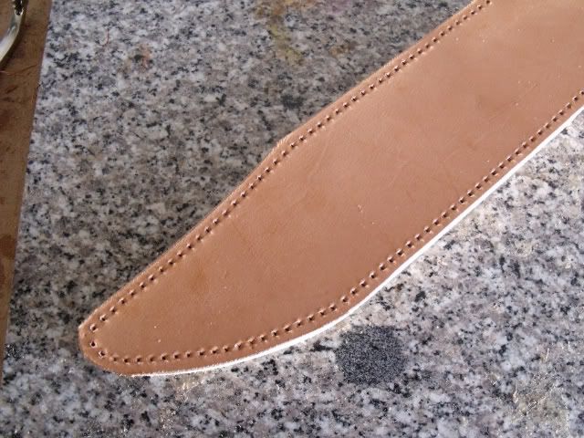

First I dampen the leather and then run the edger lightly around the upper edge to knock of the "feather edge" of leather that forms when using the belt sander. Then I use the stitch groover to cut the groove where the stitch line will be.
I then lightly dampen the leather again and run the overstitch wheel along the groove to mark my stitches. Are sized according to how many stitches per inch they lay out. I mostly use #5 and #6. For this sheath I will use 6 stitches per inch.
Next I chuck up a sharpened brass lacing needle in my drill press to make the holes for sewing. A drill bit cuts and removes material(which is bad) but a sharp smooth bit like this makes a hole and burnished the inside of the hole at the same time and no material is removed.
Once I make all the holes I go around and lightly tap the whole front side with the cobbler's hammer and this is what you end up with.

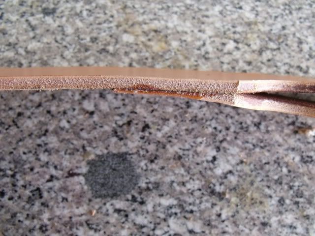

Now I have to skive down the portion that will be folded to form the belt loop. If you do not skive this down the layers of the sheath will not lay right.
After dampening the leather I skive it down to a real thin edge. Since all of the strength in the leather is in the grain or smooth side you can take it down pretty thin. In this case since since this portion is going to be part of a laminated sewn piece skiving this thin works great.

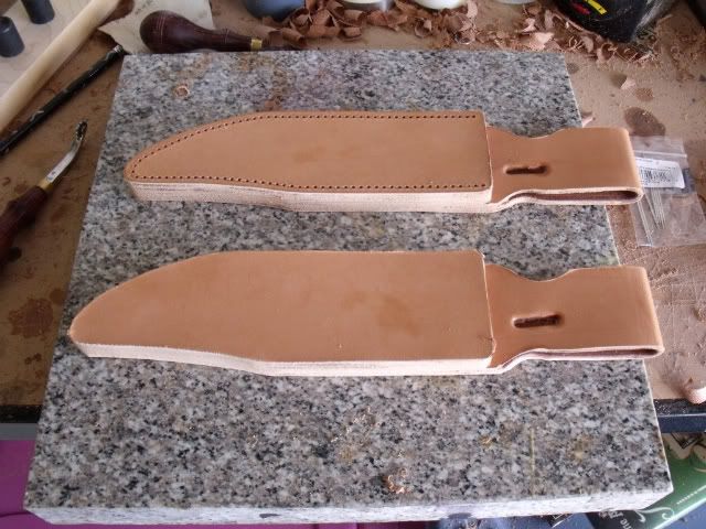

Inside the belt loops have been edged and I applied some finish. Glue is drying and waiting to be assembled.

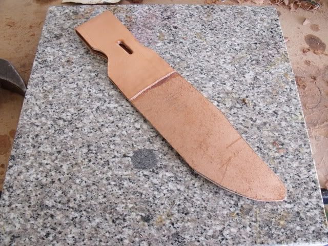

After assembly and a few taps with the cobbler's hammer, the back piece is ready to mated with the rest of the sheath.
Alright, now it's time to everything assembled.
For the sheath I will be sewing on my sewing machine All I have to do is glue the two parts together and true the edges up.
For the sheath that is being sewn by hand a little more work is needed. First I have to glue the two parts together. Then comes a trip to the belt sander and the sanding drum to get the edges trued up.

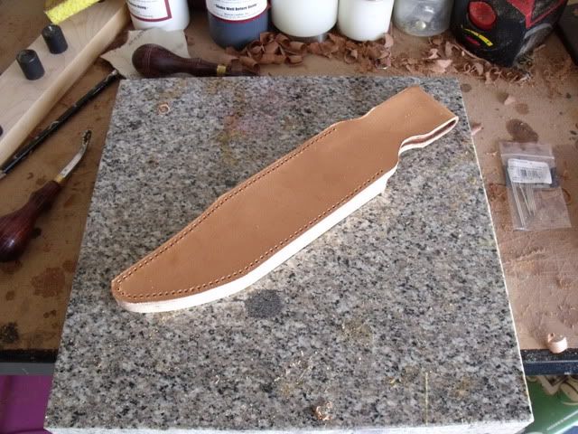

Here is half of the sheath I am hand stitching sewn. When I am sewing a project by hand many times I will break each line of stitching up and do it in sections. By breaking up the stitch line in two I have a shorter line to complete at any given time. Also by doing this I am working with a shorter length of thread. The shorter your thread the less likely hood of it getting tangles while you sew.
Here is a close up of the stitches.
Before I sew a sheath on my machine I take a pair of wing dividers and very lightly make a line so that I have a reference to follow as I stitch. I have a roller guide on my sewing machine but around tight curves I take it slow and use the guide line.
Here is a pic of the machine sewn sheath. The loose thread ends you see will be snipped close and I will met the ends of the thread with a lighter. I have one of those wood burning irons somewhere but I can't find it so a lighter will have to do.
Here are closeups of the machine stitching front and back. Tapping the stitching front and back with my trusty cobbler's hammer will flatten things out and make them look cleaner.
Two sheaths all sewn up next to each other.

Next I apply light coat of neatsfoot oil and let it dry.

First I cut the straps and use a point punch on he end and punch a hole for the snap.
Then using my drill press with the snap die chucked into it I install the snap.
Next I install the keeper strap and determine where the corresponding snap goes.
