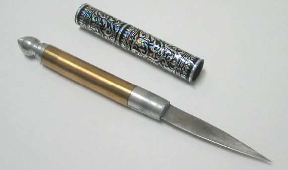

As a Chef I do a TON of garnish and I especially like to do fairly intricate melon carvings to hone my knife skills and grab peoples attention. I would LOVE a new melon carving knife. Here is what I currently use, made in Thailand.
2.5" blade, super thin and razor sharp. I like it but I would much prefer a 3" blade that runs up to a small bird beak in the last 1/4" so I can do super precision work.

ok, so what are you looking to change from this design?
small recurve at the end?
are we doing the same kind of handle?
I think the handle could be improved to be honest...it is used much like a scalpel.
Yes a small re-curve at the end...given the use and how the knife is typically held (scalpel) do you have any thoughts on improving the tubular handle?
if thats all you use it for I dont think it can be improved much, other than some nice wood.
how thin is the blade?
I don't have a micrometer but the spine is roughly the thickness of the cardboard they used on my storm proof matches.
Pretty thin. I would imagine that will be a challenge to achieve...but then again my grinding skills are to knife making what cancer is to comedy.
