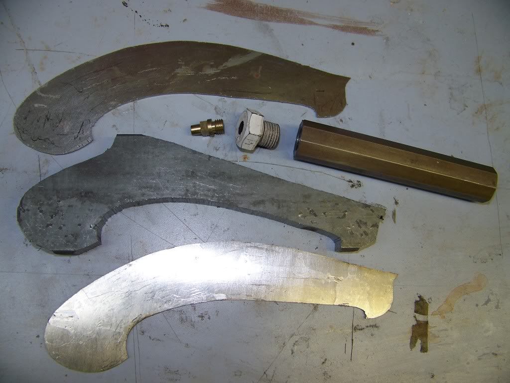

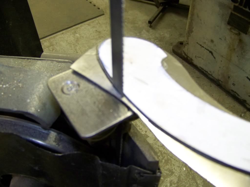

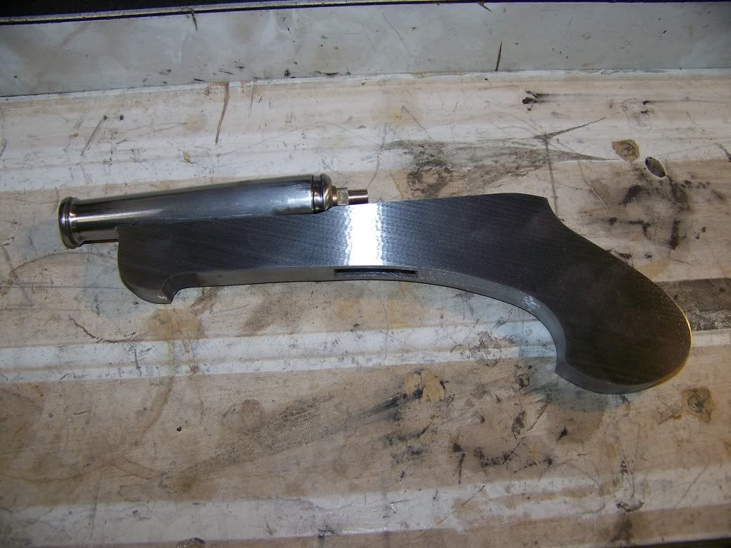

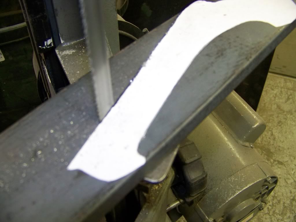

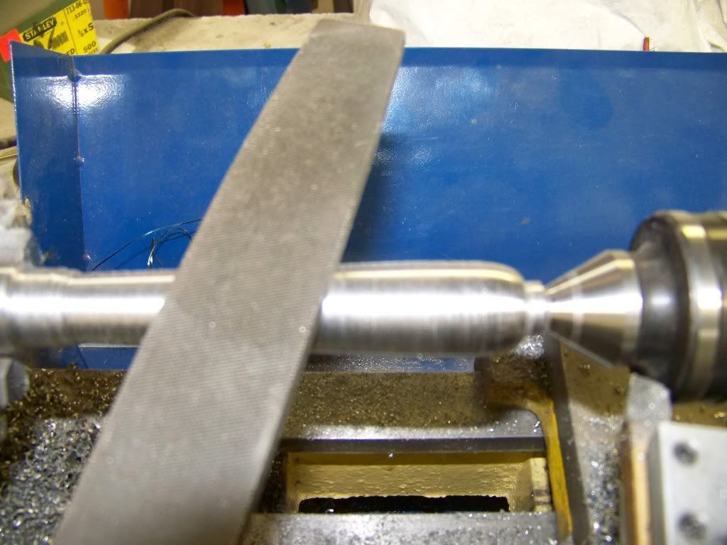

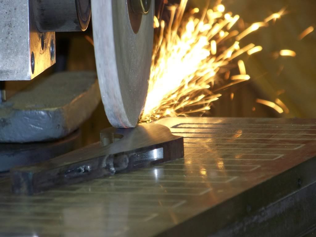

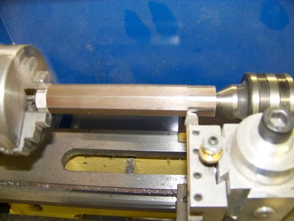

Here is one I've been working on. The barrel is from a .45 caliber muzzleloading rifle. I shortened it and drilled and tapped it for the breech plug. It will use a muskett nipple.
I already have 112 images so far but I think I will only show a small portion of them here. This will take a couple months to complete as I also have other projects at the same time.

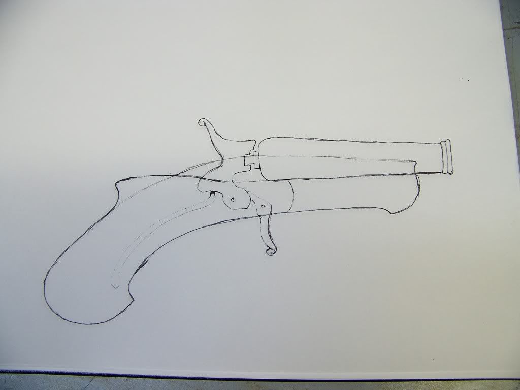

The drawing is my only blueprint and it doesnt look like much now but the finished gun should look pretty nice I hope.
BTW this is the biggest bore I have made so far.

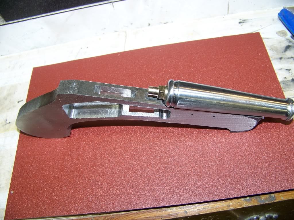

Here is as far as I am right now. The hammer and trigger are next. Stay tuned for next weeks episode. Thanks for looking.

The knife is a 6" feather pattern persian style folding blade to match the curved profile of the handle. It will have an assisted opener torsion spring and thumb stud. The knife will be mounted on the left side and the gun on the right side.

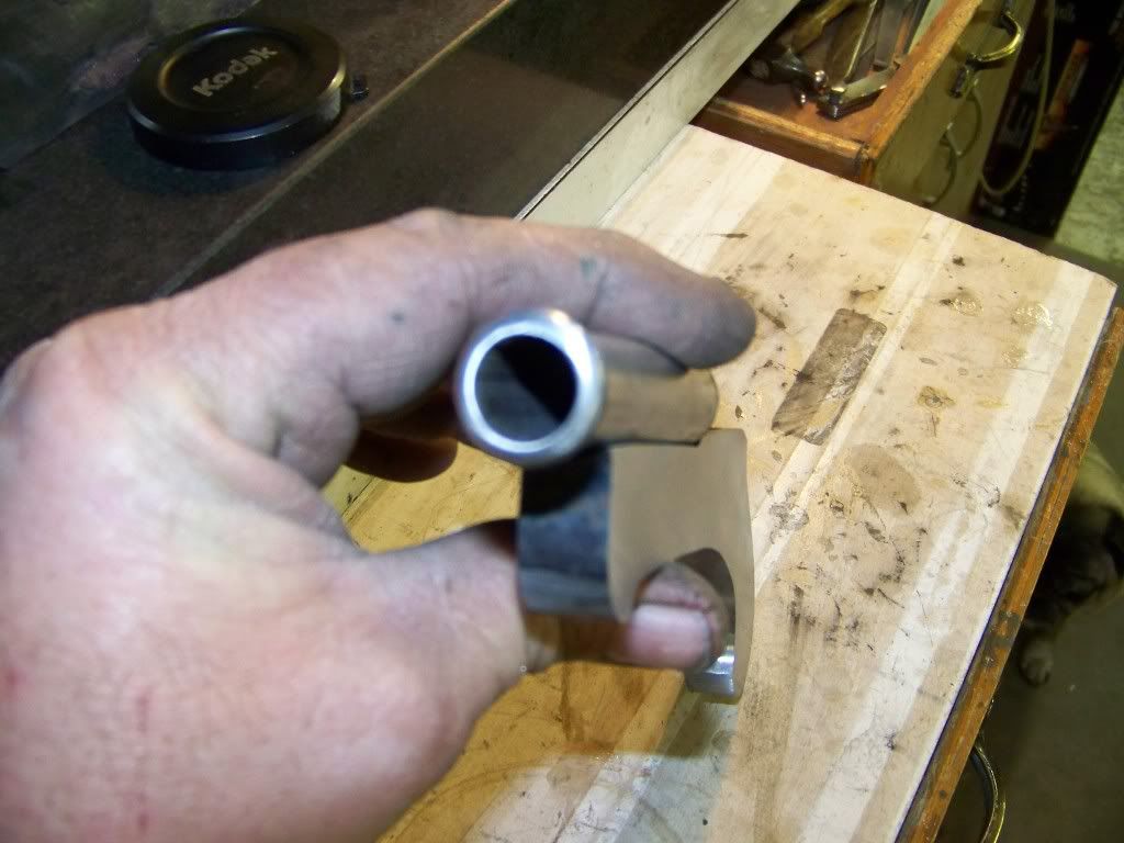

Its easy enough on a metal lathe. The breech plug on mine is a grade 5 bolt that is shortened and annealed. I used the lathe to bore and tap one end of the barrel for it, simply tighten it on the barrel and turn both as one piece. It is non-removable now. In case of misfire the musket nipple is removable.

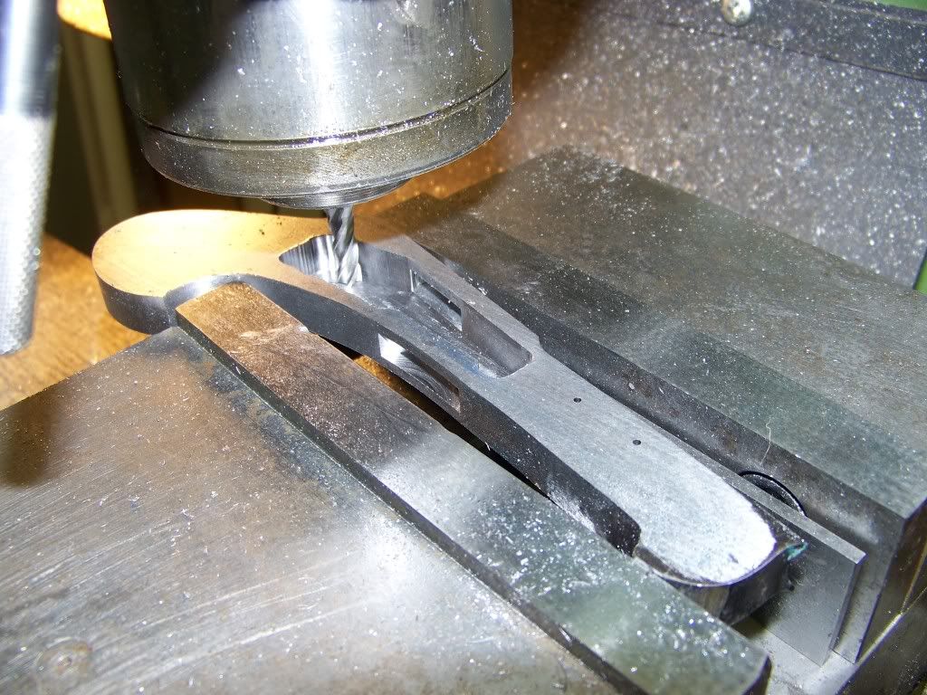

Actually making the barrel is easy, mounting it is the problem. Mine has a slot milled out on the underside and has a mounting tab soldered into the slot. The frame of the pistol has a matching slot to accept bolts.
Wow, I wouldn't have thought that soldering would provide enough strength to hold it in. Very sweet, bet you beat your last record of Post Views :D
