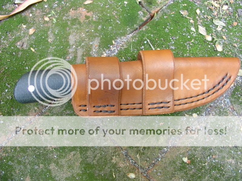

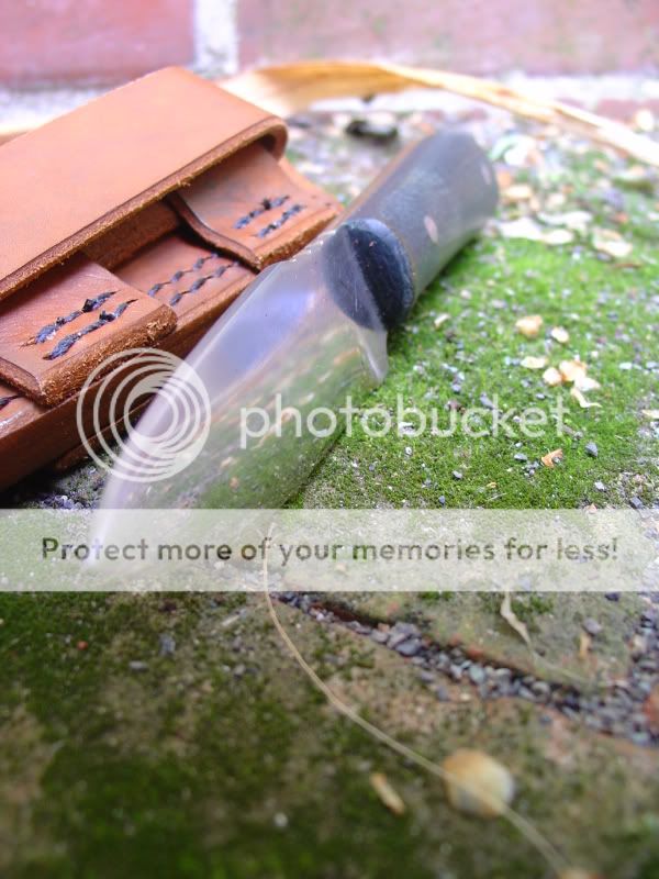

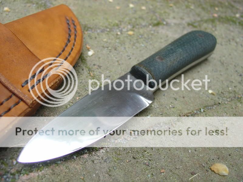

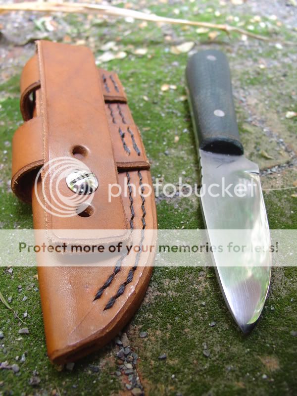

This is the one I put up for sale recently:
OAL: 6.5 inches
Blade:2.75 inches. Blade is made from 1/8 1080 steel, differentially tempered and ground with a full convex, which also provides a moderate distal taper on the forward half of the blade.
Handle scales are by fod- shadetree phenolics. This is the deep green burlap phenolic, and has a nice and subtle pattern. Pins are 316 stainless stock.
Sheath is an expedition style, with removable or reversible belt hanger that can be set up for RH or LH carry. (RH carry in the photographs). A little extra room have been left in the horizontal straps for making it easier to mount to a pack strap or belt.
