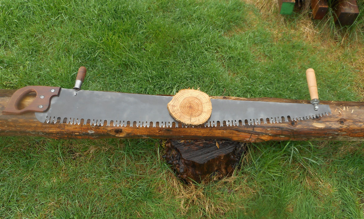

One last post to finish the story on this saw. After I finished setting the teeth and re-assembled the saw I took it out for some test cuts. I found it pulled very easily but didn't cut nearly as aggressively as my 48" taper ground saw. I wasn't sure if it was because of my filing, the wide set (.018") or the weight of the saw - this saw is about 200 grams lighter than my same length taper ground saw. I started by messing with the weight because that was easiest. I added a heavy (400g) homemade auxiliary handle gave it another test cut. World of difference! It cut much better. Here's the saw with that extra handle.
But I still wanted better so I took it back in the shop and reset the cutters to .015" of set. I finally got to test that today. It really cuts well for a small saw now. I took some video (3 minutes), see below.

I'm in a top bind because the log is elevated. So I set some wedges to keep the kerf from closing on my saw.

Here's a picture of a few noodles from the cut I made. Not huge but not bad for a little saw with small gullets in dry wood.
And here's a nice clean finished cut with an old dog looking on. Note that part of the log had been cut during previous testing.

Thanks. I did. It actually wasn't that bad taking it from .018" down to .015". And I did find I'd had a little bit of spring-back after wrenching the set originally. It varied from 0 to .003". It was all hammer and anvil work this time.
