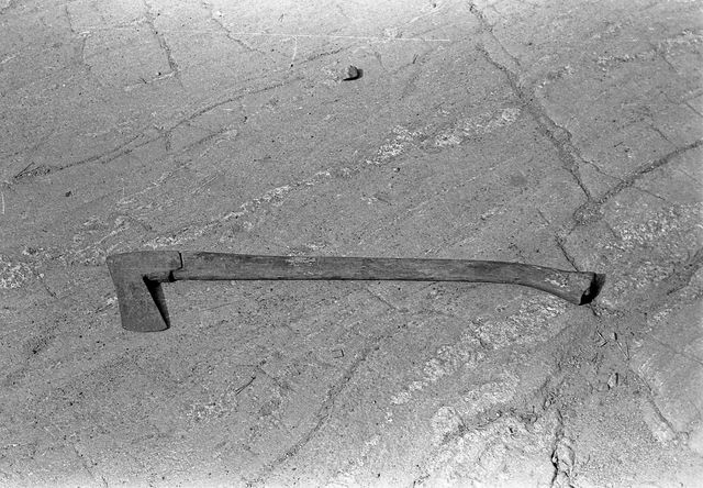

The №2 photo is really what I imagine as the archetypical Finnish axe form of all time, seems to have some distinction also from the Swedish, like you say.
I hear what you are saying Ernest. Where would you guess (or know) your axe is from, locale made, or influenced by? Finland or Sweden maybe?
The axe is Swedish, a unique version of a certain category of carving axe, probably could even be nailed down regionally by the one sufficiently clued in. I say unique because of the similar axes I ever stumbled across all are individually made and not series produced on any kind of significant scale. It is a real fun axe to use even though I'm kind of embraced by it.

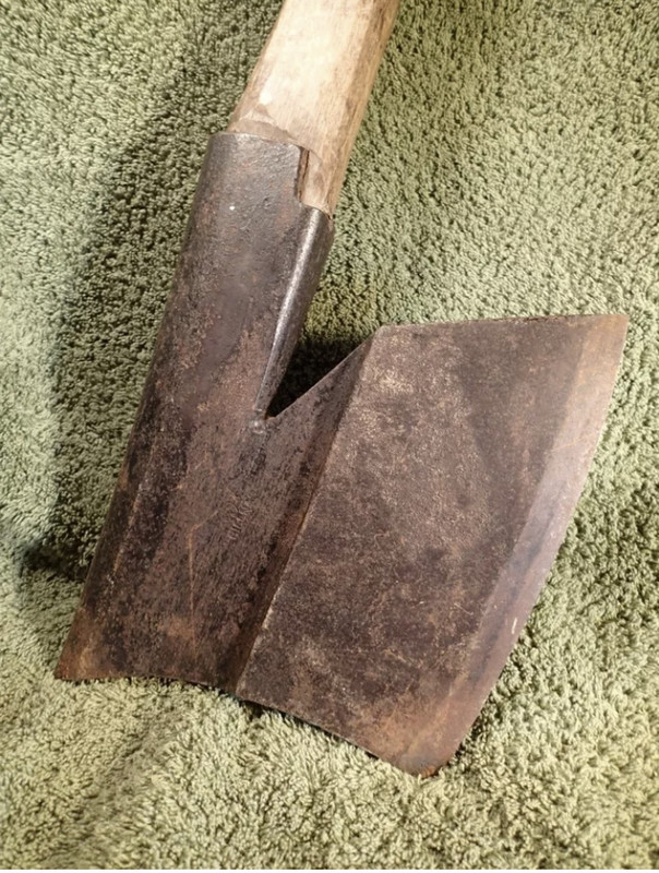

I finally receive my axe the other week I’ve only hade time to clean the rust off the head,oil and sand the Handel my only gripe is that someone has welded it up at some time in its life apart from that ime happy i just need to sharpen and get a sheath made for it

Here is one of your photos F Farmerjoe97 - Please don't think less of me but I am a bit jealous lol!
Billnas 25/3 or 25/4
