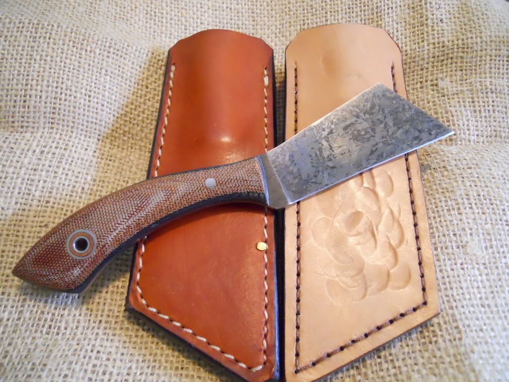

Every now and again nature forces your hand..... then you have to force the patina. I never have any luck with O1 and end up having to force a patina. It just keeps that "pin-prick", pitting kind of rust at bay.
Here is a Fiddleback BLBK in O1 with Mustard Patina I did recently:
