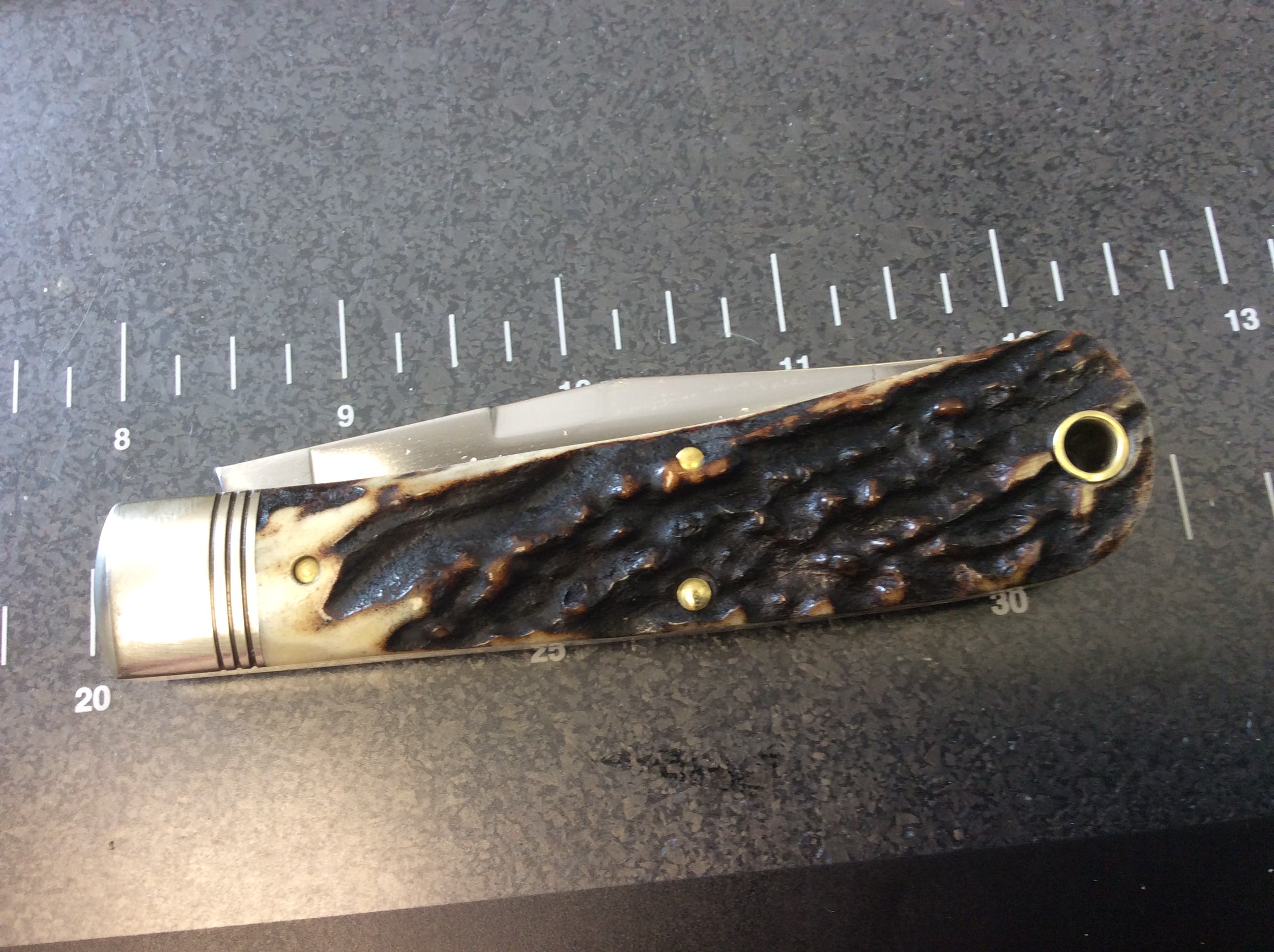

So I did this, and it smooths the action out a little bit, but it still feels gritty and I can see the rough unfinished metal on the back side of the tang and I’m pretty sure it’s the source of the rough action.
As I said before, I’m a new knife collector so maybe my expectations aren’t calibrated yet — but I feel a little let down by my first GEC experience. $80 isn’t pocket change to me and I was hoping for something more refined than my old sod buster that I carry every day haha.
It's not the unfinished metal on the end of the tang, the tang corners may be sharp or rough.
I think the last thing I would do is fill a carbon steel knife with salt. Salt is corrosive and could cause more trouble than benefits.
Flush the joint with wd-40 once, then give it a heavy oiling with 3 in 1 oil. Use enough oil to get into the pivot and spring and work it a bit more.
Over time it will smooth out as the corners wear in.
You could also put a very small radius on the tang corners to speed up the break in. A fine jewelers file or Gesswein stone works good. Tape off the liners and go slow.
The tang corner on the right is rounded and it smoothed out the queen barlow nicely.
Edited to add that more than likely the knife will smooth out with use. My 43 was a little sluggish closing at first but after a week or two of use it is much better now.

GECs, like any manufacturer, have some variation from knife to knife in a given series. What you must also include when thinking of GEC is that the knives are hand finished. With that, there is quite a bit of variation from one knife to the next. I wouldn't say to expect issues, but they do occur. With regard to your knife, some require a little break in period. Why not try drowning it in oil over the sink, open and close a few dozen times, dry off with a cloth. The open and close will smooth things over, the oil will wash the filings out.
So this is more or less what I ended up doing, and after a days worth of fussing with it the action has smoothed out substantially. It feels really crisp and snappy now. So I think you’re right, it just needed to break in a bit!
Regarding the fraying canvas micarta, I hit it with some superfine steel wool and now it’s perfect. I also rubbed a little beeswax impregnated with flax oil (I make it for my kitchen utensils) over the whole knife and now it feels just incredible in hand.
Thanks everyone on this thread for your input, I’m really glad I didn’t give up on this knife — here’s what I love about it:
The factory edge is nutty sharp
The pull is perfect to me, I have strong hands from rock climbing and I’m just able to pinch the blade open without using the nick — so probably a 6?
The fit and finish around the whole knife is excellent, everything is perfectly flush and the blade centering is perfect.
It looks so cool. The clip on these #43s is even sexier than the Buck 110.
So yeah, thanks again everyone!
