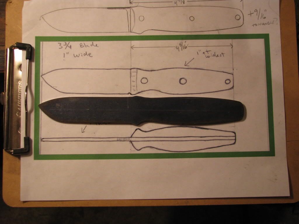

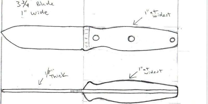

I just printed off a copy of your drawing and I am headed out to the shop to get started on this. I'll try to post progress pictures in this thread so you can keep up with how it is going.
Thanks,
SDS
Here are a few pictures of the process getting started.
First I printed off a copy of the drawing that you posted Tony.
Next I cut out a paper template.
That was then converted to a plexiglass template so I can hold the pattern in my hand to see how it feels.
Next the pattern was transferred to steel.
Before I do any more work to the handle I wanted to make sure you wanted the handle the length you had drawn. It seemed a little bit short to me so I when I cut it out I lengthened it just a bit. I can shorten it back if you'd prefer.
If you aren't sure I would recommend that you get some thick cardboard and cut out the pattern with the handle the length you drew and another one the length I drew. Decide which feels best to you and let me know.
Here is a picture of the two lengths drawn side by side.
It's very cool seeing the process of getting sketch to steel. Your knife is looking good Tony
very cool Shawn...:thumbup: i'm sure that knife is going to turn out great... Tony did a great job with the design...:) looking forward to seeing more progress pics...
Oh wow, I didn't know you had started this allready. It looks great. Disregard my last pm..
I will cut out a cardboard template and check the handle length now. Thanks!
I'll be right back!
I like the longer length!
Thank you for taking that into consideration Shawn!!!

Well tonight I got a bit more done than last night. As per our conversation in PM's Tony, here is another profile that I think more accurately matches what you were wanting.
The new one is the top one in these pictures.
Let me know which you prefer.
SDS
Oh hell I don't know. They both look great.
Yeah the blade shape is spot on, but the other one is really growing on me.
Can I say both ?
If I had to choose one, I'd go with which ever one has the wider blade and handle.
Damn, this is a tuff choice.
oohh.. both of those look great Shawn...:thumbup: i think you should make them both and i'm sure "somebody" will buy the other one....:D :cool:
How about I make them both and Tony can get first choice. I can either put the other one up for sale here or I have a show coming up that I still need to finish some knives for.
