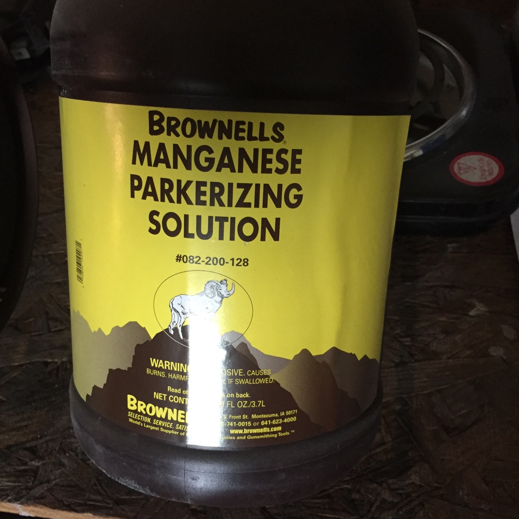

I finally broke down and ordered a gallon of manganese phosphate parkerizing liquid. I am SO ready to go to parkerizing, the sometimes fickle nature of other methods at keeping dark black in damascus (especially in bold patterns) can be so frustrating. Particularly I am looking forward to not having to actively boil/simmer or wait a long time for best results.

Very nice! Are they selling it in liquid form? I tought it was a powder to be mixed with water and then conditioned/aged with iron before first time use.

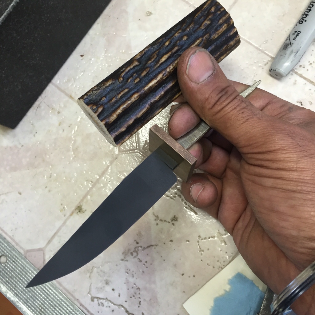

What I bought and the first parkerized knife I did

It's fantastic for corrosion with just about any rust preventative on it. I blasted and parked a small blade this June, wiped it down with WD40 and it's sat out exposed in my shop (no temp control) to now, without a spec of rust starting. While a satin finished blade would have spotted up by now, especially as humid as it's been.

What led you guys to choose the Manganese Phosphate over the Zinc?
I wanted the darker color. Zinc tends towards grey and ages to a greenish patina. Since I'm using it for knife and gun parts, I wanted black. I think it's a thicker conversion than zinc as well.

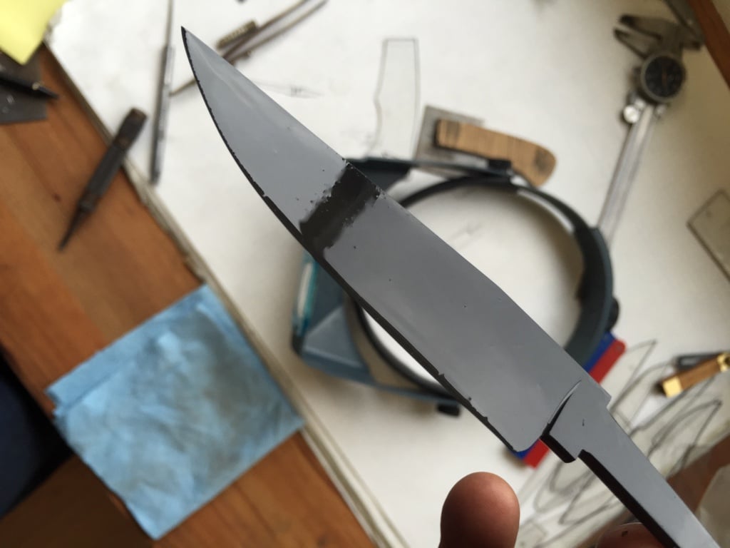

The 1095 blades I've done to date come out black as night. Even in bright sunlight, they are black. Not charcoal grey. Which is exactly what I wanted.
For example, this is blasted with 40 grit AO and manganese parkerized (my first one actually):

How long will the finish last ?
Depending on what you're asking - how long will it last on a surface? Forever as long as it's given some oil/lube/RP. How long on a knife blade in use? I don't know. It will wear like any other surface conversion or coating, but it seems durable so far. The blade I mentioned earlier that's been sitting in my shop all summer, it's in a too tight fitting kydex sheath, and I pop it in and out every time I go out there to see if it's starting to streak/scratch, and it hasn't yet.
But the hardest use I've put one through is a kukri I've cleared some brush for game cameras with. It hasn't worn yet, but it hasn't seen daily use either.
It's more durable than bluing, by far. It's not as durable as nitriding. I think it's on par or slightly better than the various epoxy paints - Duracoat, Cerakote, etc.
