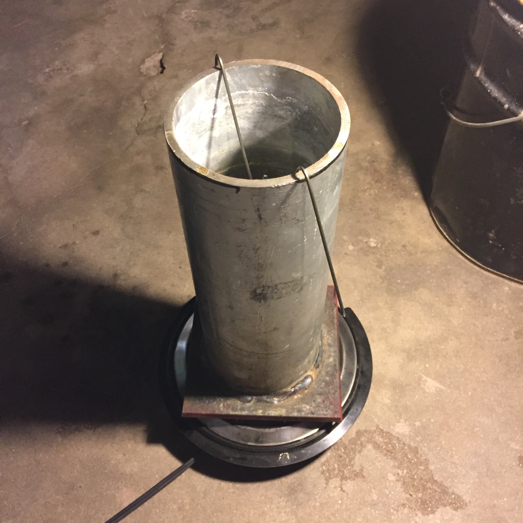

what sort of hold times (in the solution) have you used? I used 30 mins on this one
Ten to fifteen has been sufficient for me. I wonder how evenly your solution was heated? My tank is horizontal on a two burner hot plate, and I have it at temp for 30 min before my part goes in.
Did you activate it with some steel wool?
I believe it is evenly heated and I do have it up to temperature for 15 minutes or so before hand. Yes I did activate it with steel wool. I think the sandblasting is the trick. I hadn't been advised that 20 minutes immersion was sufficient
As far as time in the solution I'm really just looking at the blade in 10-15 minutes to see what color it is, because I can get a good look at it the way my tank is laid out. I don't think there's any additional benefit to increased time submersed once you hit the color you're going for. It isn't (to my knowledge) going to build any deeper of a surface conversion past a certain point. You can pull your blade and look if you're careful to not let it dry off, which happens rather quickly at 180F, but if you just pop it out and look then drop it back in, it won't interrupt anything.
I ran two blades last night, 20 minutes apiece. They were both hand sanded to 400 grit first. Etched the pattern, then parked at 190f. They both came out nice and evenly black.
I think the etching is a critical step if not blasting, in order to get dark black. Like previously discussed (this thread or another I can't recall) about the "pre-dip" Lauer sells for getting dark black, FC probably does the same thing.
The only other thing I can think of is whether the blade was cleaned/degreased prior to dipping and if the Park solution was mixed at the proper ratio to water.

Decided to sandblast and redo. Top one is the sandblasted redo I just competed
Of course, Nick!
Paul, those pics are from Photobucket, and so are these. Try using a different browser? Here's some pics of black blades from last night:
And from later last night, and this morning, cleaned up:
I reached out to Adam DesRosiers, who is kind enough to share advice with me now and then, and he told me a couple things he learned from Rodrigo Sfreddo that are quite helpful.
Etch deep, and after depth is achieved, sand the surface of the highs shiny with 2000-2500 paper before park. The polish on the high layers helps the park not stick to them or pit them, which as I can attest, gives a MUCH better result.
The other thing, wet sand after the parkerizing, at least until the end. This saves a lot of paper and floats the debris away from the sanding zone, having less of an effect of washing out the low layers. Again, I tried this, and it super helps.
I'm going to 2500 paper briefly after etch, light all over while wet with water, then right into the park at 190f. Twenty minutes, and it's done fizzing. Nail polish on everything I don't want etched or parked. Then air dry out of park, let cool. Acetone strip any areas with nail polish masking. Start in finish sanding with water and 1200 paper. Do the very last sanding dry with 1200. Buff lightly along with handle. Heat lightly over hot plate and rub in coconut oil (kitchen knives, turbine oil for non-food prep.)
