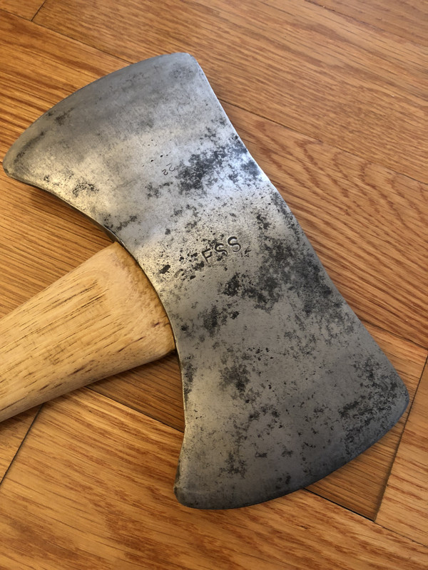

My girlfriend and I just got back from a new antique store in the area. The one booth that had things I really wanted was WAY overpriced. But i did grab a couple things from different booths. I think i got a swedish head. Hoping one of you may recognize the blue color and the weight stampings. Both kilogram and pound 20190330_131036.jpg 20190330_131102.jpg 20190330_151046.jpg 20190330_151054.jpg 20190330_151305.jpg
Weight is spot on! It is butter soft though...

Really?Kinda`surprising...Doesn't look like it's been exposed to high heat;paint still on,and it doesn't look ground to death...
It's a fairly intact,complete profile.Maybe it has never been properly ground past Decarb.You may want to pick at the edge area deeper.

Oh it's bad... fills the file right up. Almost like it's wet. It's on par with the softest I've ever come across. I don't know this but I feel if I keep filing I'll just lose more bit. I'll try a little though as you suggested to make sure. Do you guys find that hatchets in general seem to be softer? I've found that to be the case especially with any newer hatchet. Like 70's forward.

Looks like a Hults Bruk.
Run your file on the steel around the eye, poll and 1 inch away from the edge (temper line area). Different tones should give you better idea what you are dealing with. Maybe the edge has been overheated by grinding or whole axe was in the fire.

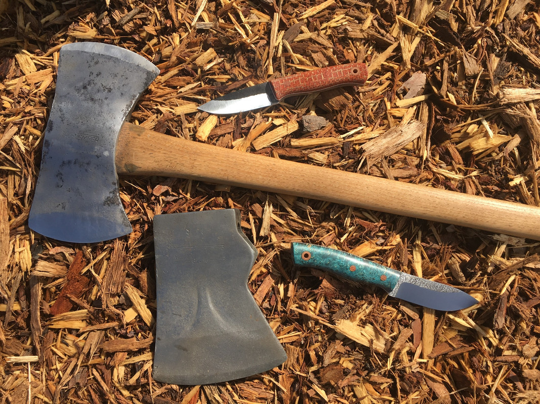

A source brought all this back from a property that is going to be scrapped. I got a Stihl MS210 that needs some parts along with the bar and chain, a no-name quality peavey, an Atha (edit: straight) pein, a Klein Logan 8lb sledge, a W. Germany hatchet, some M splitting mauls, a 12lb M sledge, an oil can, a usable vintage double bit haft, and a factory Ford brush guard for my Highboy project. Now I have to decide, winch bumper or Ford bumper + guard?
Ps. The electrical tape is a temporary fix, just till I can afford to throw money at something other than my highboy.
Good score,A17,you can be pretty busy with looking after all this stuff:)
That Atha job is actually a straight pein...It's a scary tool,took a lot of guts to use it day in and day out...Something like this was necessary to pein a wagon tire,which needs to be is a section of a cone vs cylinder,and this is what you used to accomplish it...It built plenty character!:)
For a Highboy stick to the guard, a winch bumper won't fit the classic aesthetic, imo :D
Whatever you do for tires make sure they're OWL!

If that's a Hults Bruk, the maker's stamp is on the other side of the weight stamp. Pre 1988 they were cold stamped, so they aren't very deep, or legible for that matter. The weight stamp is kilo/pounds, that would suggest Swedish , German or Austrian. If it's Swedish, by the '60s there were three production axe manufacturers, Hulks Bruk, Wetterling and Gransfor Bruk, (not the current Gransfor Bruk) There you've gone and used up all my knowledge. Being a rust hunter, I like tracking down tools.
In pre-88 HB’s, the stamp sometimes gets obscured by wear. I purchased a double bit that I didn’t even suspect was an HB until I got it home and took a closer look. All I found was a piece of the circle and the bottom half of the B. The shape, weight and colour on that head make me think its an HB.
