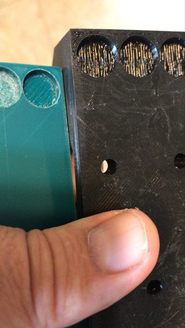

June 3, 2021
UPDATE regarding magnet holes:
I printed and updated base and noticed the the holes are a little bit deeper :thumbsup: . The designer confirmed with me that they have been updated.
Picture of the new black base compared to an older print ( green )
