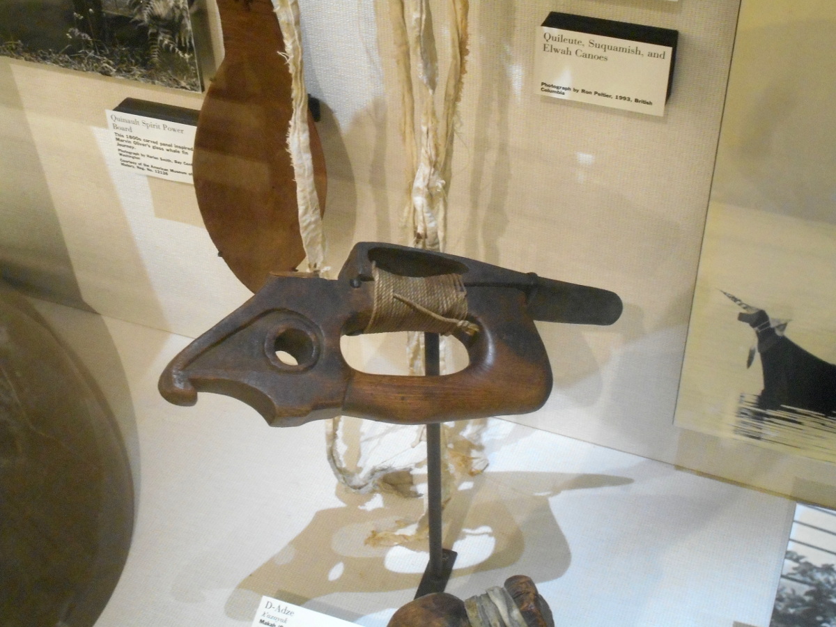

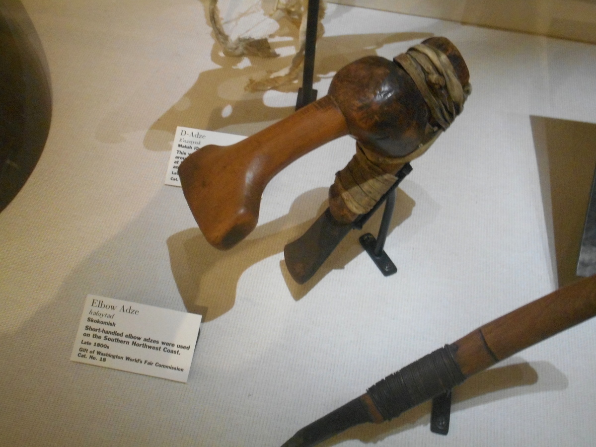

The Pacific Northwest First People traditionally adzed all their wood work. That was the tool they had. At first with jadeite blades and later with iron or steel blades. In the early 1980's I worked an archeological site where a jadeite adze blade in good condition was recovered (circa 1100 AD). A structure was unearthed that had been built of interlocking wood beams and posts. Charring in fire preserved some of the joinery which was quite good.
Traditional wood works show an adzed scalloped surface. Large cedar homes and totems were not considered finished until they had been adzed over their entire surface.
I am currently reading the book 'Cedar' by Hilary Stewart. It documents many of the carpentry traditions of the PNW First People. Many traditional tools are housed in the Burke Museum on the University of Washington campus where I used to work. Two main styles of adzes were in use, the elbow adze and the D-handle adze. It's well documented that these tools have mostly had iron blades for the past +/-500 years. Iron was salvaged from Asian shipwrecks and barrel loops that washed ashore. Iron tipped tools were common at the Ozette site that was buried in a landslide over 200 years ago.
Here is one such adze I photographed at the Burke Museum.
A D-handle adze which has been re-steeled with an old axe (just to stay on topic).
Demonstrating use.
Thanks,Square_peg,beautiful tools,great info...Couple years ago i had a chance conversation with a couple Tlingit canoe-carvers in Sitka,and got to see the tools themselves(forged by one of the carvers),and the technique...Fantastic stuff.
