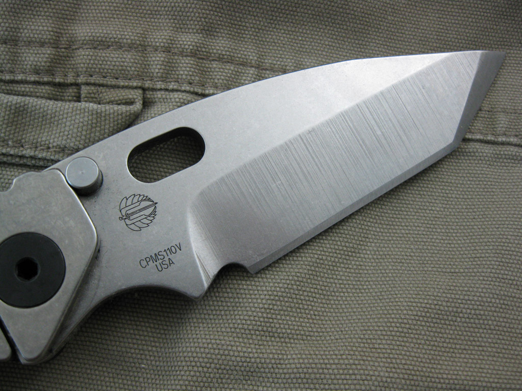

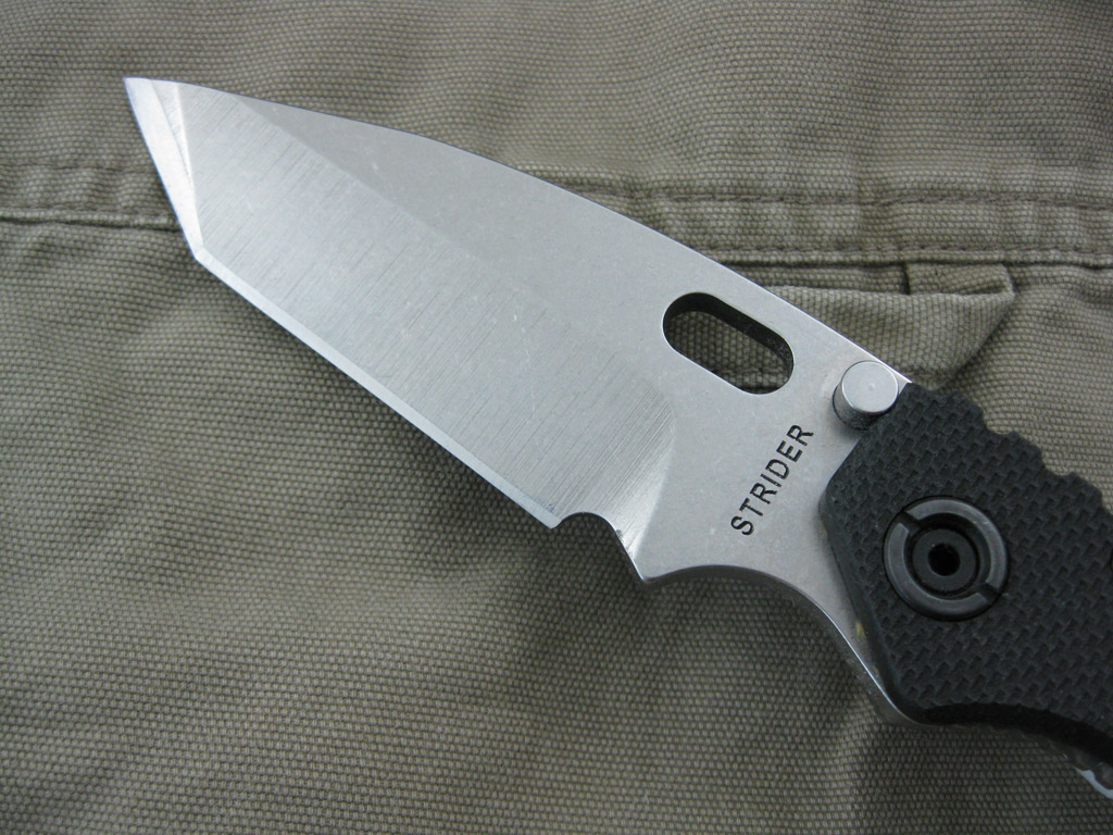

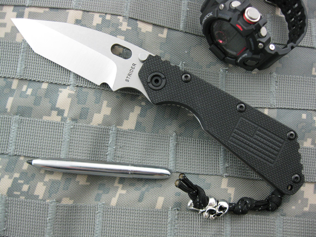

Strider SMF Slicer?!
I could never do this before!!
Thanks brother, your talent and dedication to making whatever you do perfect is second to none.....
Thanks Alex! I hope that thing serves you well ;) looking forward to future projects!
