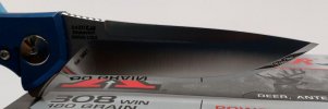

As a recent customer of Josh's, I can attest to his skill at reprofiling and mirroring. Just got back my 0450 and literally could not be more pleased with the consistency, appearance and performance. Truly perfection, and makes it a way better slicer than before! :thumbup: (Pic below, taken by Josh)
