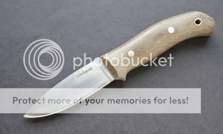

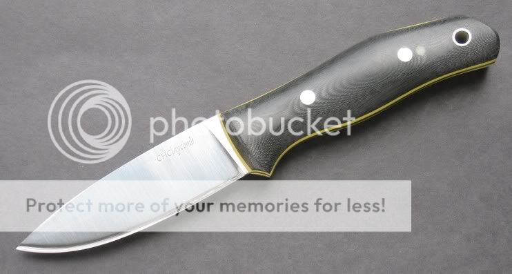

I have been doing some sketches and modelling of blade shapes and geometries to go with the existing Bushcraft handle. I have made a bunch of knives that are variations on the theme of a flat ground blade on a Bushcraft style handle, but now that I am really thinking about the design I am starting to wonder whether the knife that I want to carry is the same one that you want to carry. ;):D
Recapping the basic premise: Design a knife the same size and thickness as the Bushcraft, same handle, but a full flat blade ground from a high performance stainless steel.
When the NASA Bushcraft was first discussed it sounded like just the kind of lighter weight, general purpose knife I and my friends would want to take on canoe trips, expedition to jungles or deserts and generally anywhere a wood handled, carbon bladed, bushcraft knife would get destroyed. However, the jobs it would be put to would be very similar; carving wood, light baton cutting and splitting, food slicing, shaving fire wood, and occasional small game prep. Not much slicing of really abrasive material like rope, cardboard, or bear skin!
For a long time the steel has been quoted as S90V, although I am not sure where this selection was first made. S90V is tough to sharpen, expensive, very corrosion resistant, and likes a fairly aggressive edge.
These characteristics are not exactly what I would have chosen for my own use. I like RWL34 / CPM154, BG42, 12C27 and D2 in about that order. I like to use my knives outdoors rather than cosset them at home, or work them in the urban environment, and I haven't played with any of the Mules that Sal has made available, so my perspective has limitations!
The jobs that I do, and the steels I like to use support a longish, shallow convex bevel. This longer bevel helps for wood work, but a high carbide content will make sharpening such a blade something of a pain. I also like a slightly beefier tip to stand up to boring holes.
  • What do you guys envisage you would do with such a knife?
  • Is S90V right? There have been a bunch of Mules since the NASA concept was first raised.
  • What kind of edge and blade geometry have you been imagining when the discussion of the NASA Bushcraft has come up?
Oh, and just to make this a little more fun...

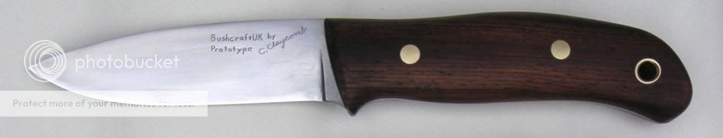

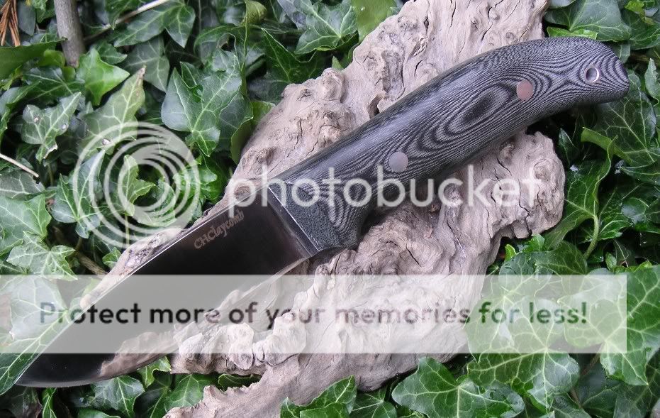

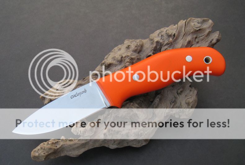

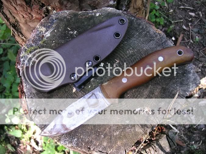

Here are pictures of those "variations on a theme" mentioned above. Most have ended up a bit deeper than the original design, and have a slightly higher point, although they share very similar point geometry.
The Original prototype.
