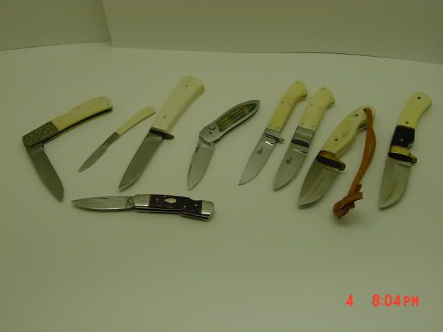

I was thinking about the lightbox, when I realized that the interior of my Colman cooler is white and all the corners are soft. I set it on the counter, propped open the lid at a 45ish degree angle & took some shots. Most were less than fantastic but a few came out decent. Works in a pinch for simple displays if you needed to take a photo in a hurry and have a big cooler sitting nearby! :D
Canon EOS 20D, EFS 17-85 mm lens, 420EX flash, Colman cooler... As good as SharpByCoop's work? :eek: Well... I wouldn't go THAT far!!! Maybe on his worst day, with a bad hangover and without half of his equipment working...! Maybe not? :foot: :)
I will have to tweak this a bit to lose the shadow more. It'll work until I put together my own $75.00 lightbox! :)

Another quick and cheap concept! Light up that butt end and then you can start charging money for those shots.... ;) Anything that surrounds the knife with some diffused light works. (your flashed light was bouncing all over in there adding to the mix.)
