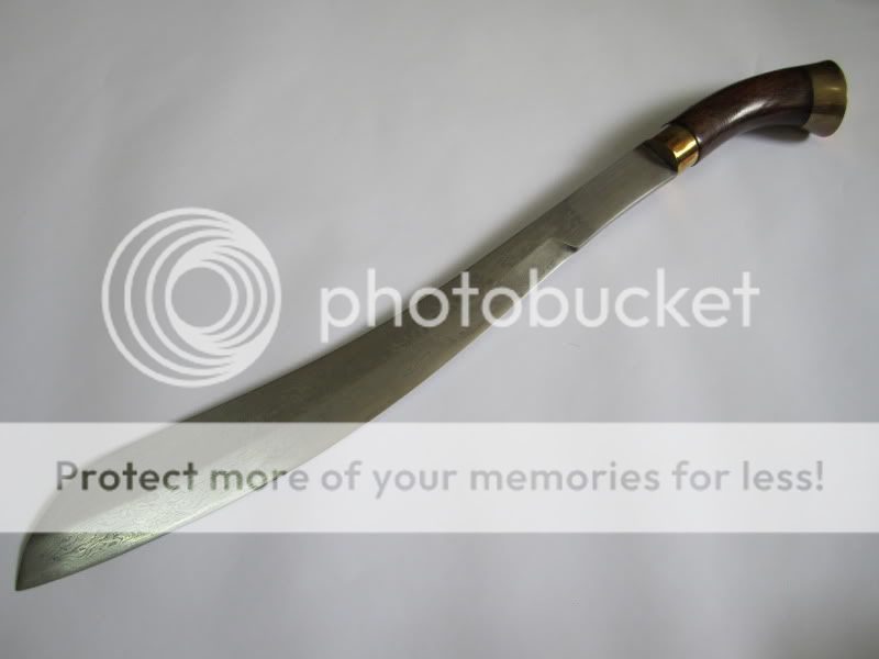

Here is the picture of my Parang Lading made by Mang Ako from Tasikmalaya, Indonesia.
The exact name for this sort of Parang Lading is 'Parang Lading Betina Tanggung'. Anyhow it can always be referred as 'Parang Lading Betina' or as 'Parang Lading Tanggung' or just as 'Parang Lading' or as 'Parang Tanggung' or simply as 'Lading' or generically as 'Parang'.

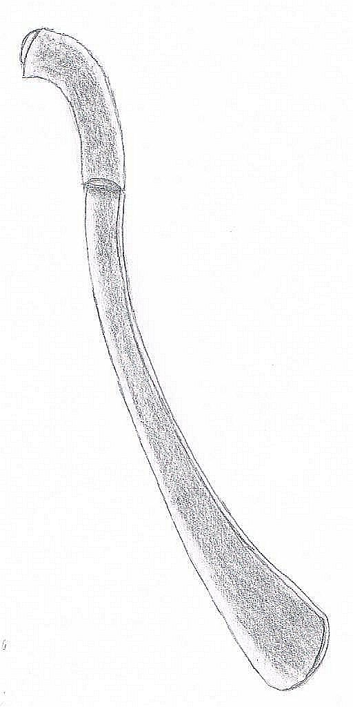

After a short discussion via Fb and emails in between of Harun, O'Katz and I then O'Katz show his interpretation of Parang Lading which was drawn base on my design .

IMVHO the Parang Lading has a nice lazy 's' flow in the design itself.
The traditional Parang Lading is normally built with a rat tail tang embedded about half way of the handle. The one made by Mang Ako was built with a rat tail tang which was peened to the pommel. Anyhow this time we were planning from the very beginning to come out with a Parang Lading that has a full tang with few pins and a lanyard tube on it .

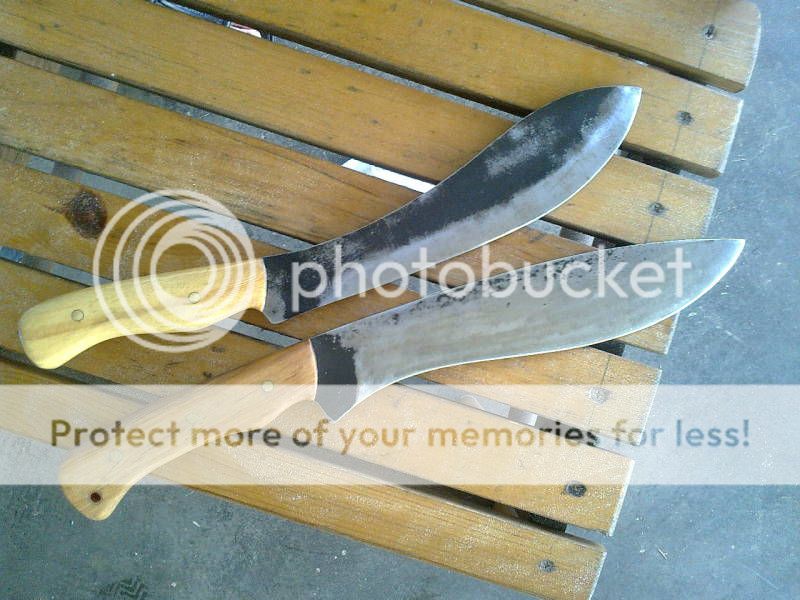

BTW, I remember that I got confuse of the sort of knife that practically suit your working environment.
It shouldn't be too heavy because you'll be carrying it for a long time in your jungle travel.
And I remember that you don'f fond of a knife that has a handle heavier that the blade.
So I just hope that the large Nessmuk with a rather thin blade might function right for you!
