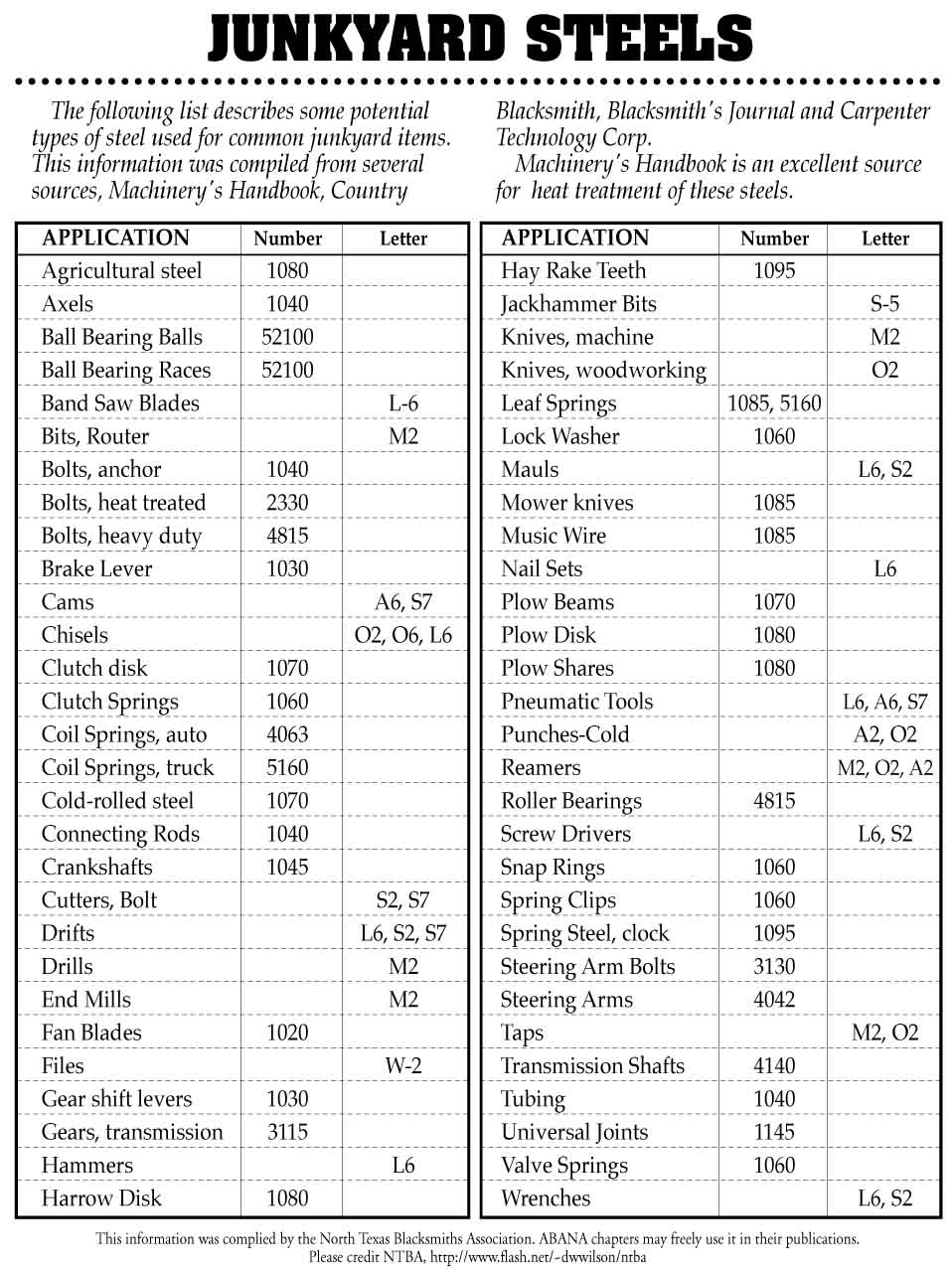

I suppose you have charts like these but some of the other forum members may find them interesting.
These charts can give you an idea which types of objects found in a junkyard you might wish to test to see if they are suitable for your purposes.
