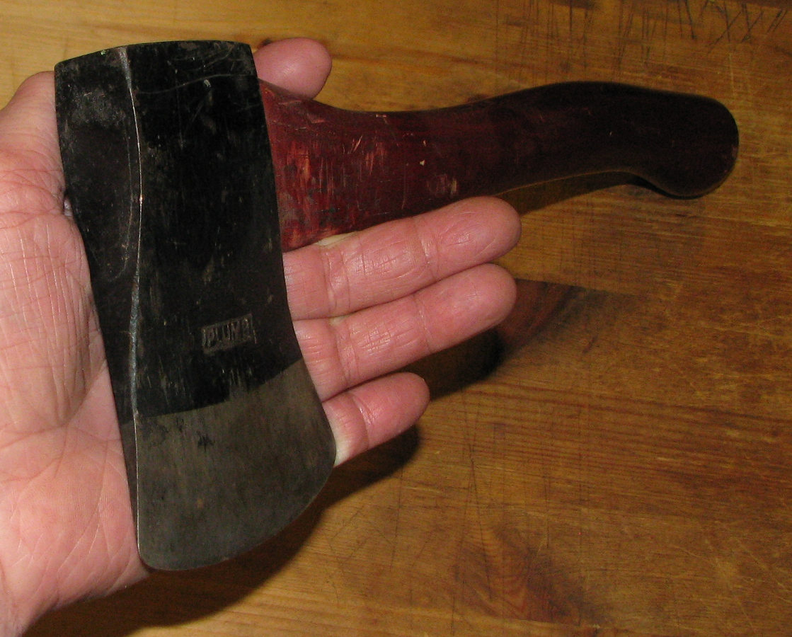

Plumbs are typically stamped. Do you suppose there is a stamp under that decal because otherwise first time out this hatchet would have become a 'no name' implement. Even more so when the wood was re-newed.
Your post got me thinking - maybe the OP can rub his finger across the decal and see if it is the stamp/impression we are all familiar with but is detailed with color? It's the right shape, size, and location for the most part.

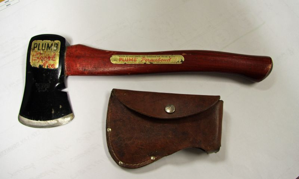

The foil label! The unstamped handle! Late US production agreement on that one. The OP hatchet has a stamped round knob handle.

Then there's this - Permabond but no stamp just the sticker.
And finally, sticker plus stamp and Permabond.

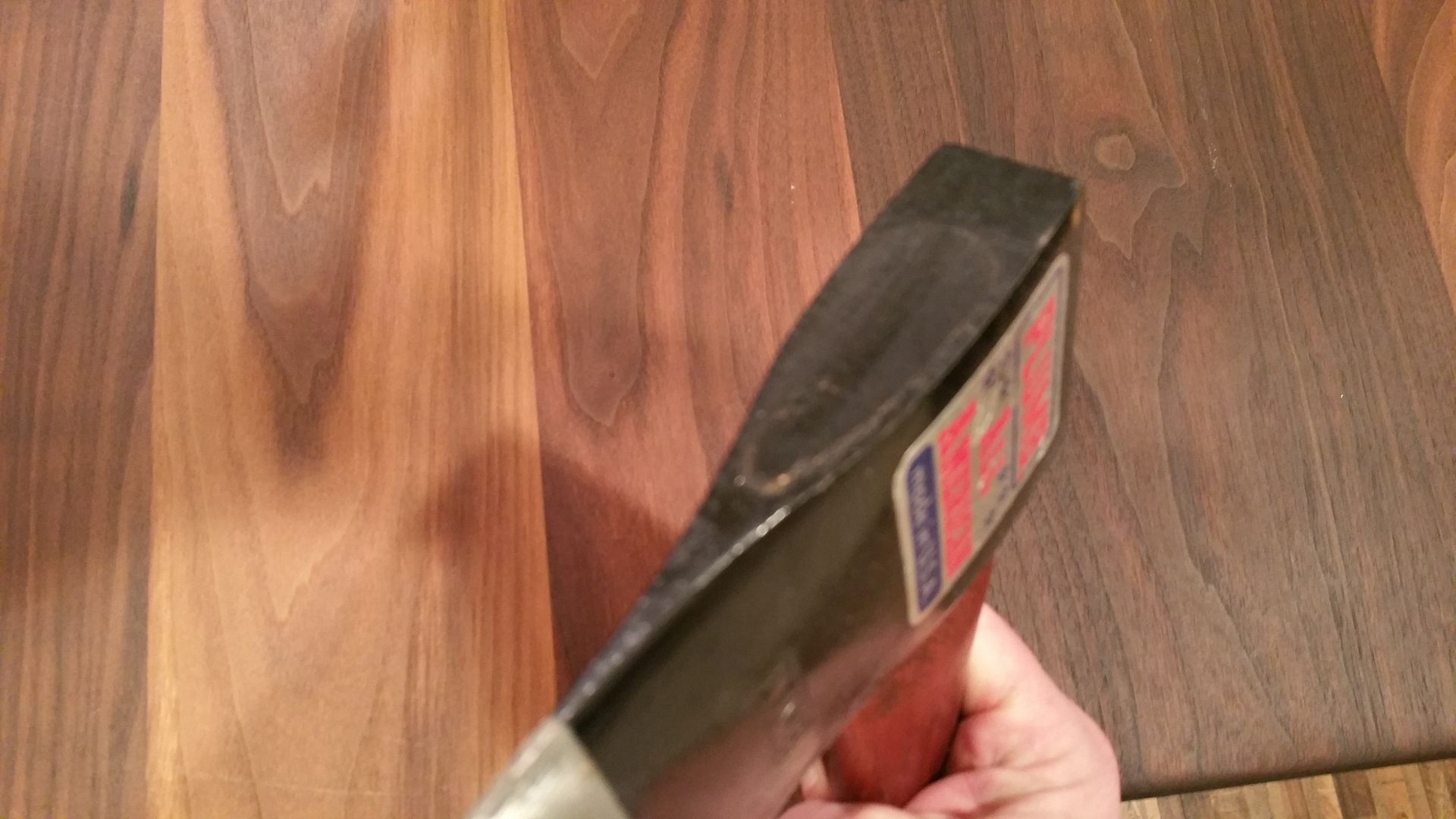

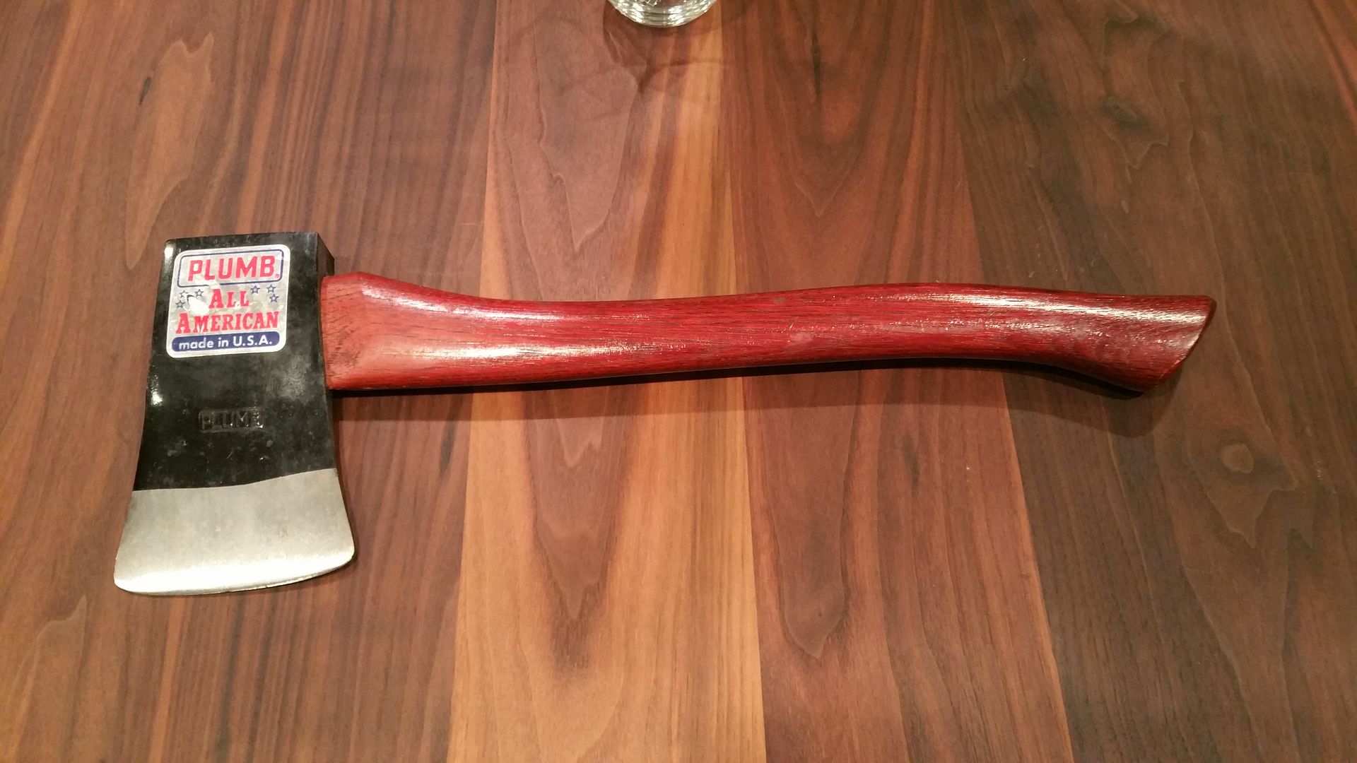

1978, purchased by my father. No permabond. Imagine that.
Not trying to in flame you at all, remember, we are here to learn. But here is the question. Why did your father buy that axe in 78', and never use it? You are the only one who could possibly answer the question.
Maybe it was a NOS Plumb, that Ames, or Cooper just stuck a sticker on to liquidate stock on hand? Who knows, maybe you can shed some light? I have personally never seen a Plumb axe that was wedged with a sticker. Nor have I seen a high center line Cooper group Plumb axe. There is a remarkable difference in bit geometry between the older stamped Plumbs, and the newer ones after the company was acquired by Cooper.
Certainly the sticker on Operator's supposedly 1978 axe is a dead ringer with the second from upper left sticker/decal rendition of a post-1981 Cooper Tools axe as shown in post #36 by rjdankert. I'm not a young guy either and my memory is not infallible anymore; some things I could have sworn I was gifted or bought in the mid to late 60s actually turn out to be from years later. I know this because I've been cleaning out my filing cabinet of old receipts, manuals, notes and gift cards.
Somebody is gonna take a shine to this but it's unlikely you'll get beyond what a new Swede boutique jobbie costs today. No Boy Scout or any other distinctive stamps on this. As halfaxe says it's a pre-Permabond hang (ie before 1956) and post- steel take-up wedge (early to mid 1940s). Impressive that a tool, that somebody specifically bought, wound up remaining unused for 65-70 years.

The other option is: Yesteryear tools information may also be out by a few years. Perhaps Cooper Tools was on the Plumb scene already in 1978 and not beginning in 1981 as is stated. This much I know; Operator knows his stuff and it's highly unlikely he's joshing us.
