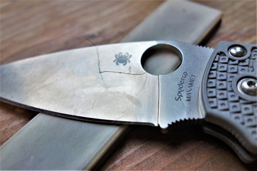

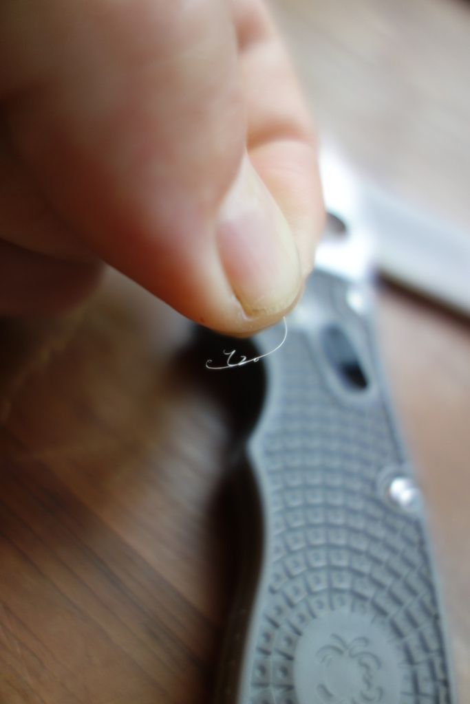

I did some experimenting and shaved metal fragments off of the spine of my Swiss Army Knife nail file.
Video excerpt: https://www.flickr.com/gp/alwaystomboy/TES413
And close up photo afterwards of metal shavings on the nail file and Maxamet blade. The blurry fuzz on the tip of the file and the black specks on the blade are metal fragments.
Tried the same with S110V and couldn't get any shavings. No video, but I could hear and feel a definite difference. S110V didn't want to bite into the nail file like Maxamet did. It just kind of slid across.
Here's an after photo of that but there's not much to see. I couldn't get any metal off of the file with S110V.
