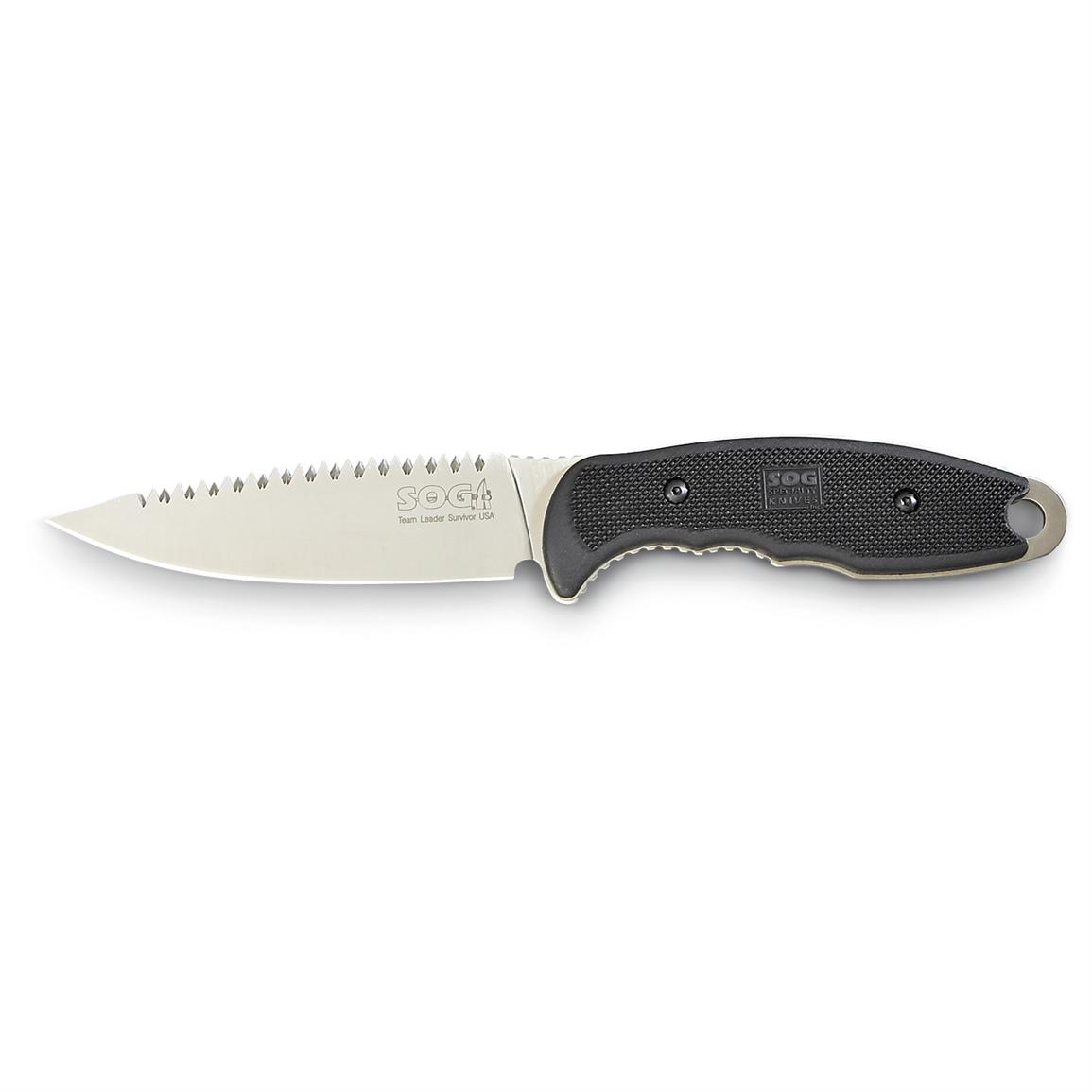

SOG Team leader, saw
Definitely , no saw.
Even with really well done teeth, the length of a knife blade is just too short.

I would grant you that, but that comes at a real cost:
1) the teeth hamper the performance of the edge. They snag on what you are cutting.
2) The teeth snag on the sheath as well creating additional wear.
3). The teeth are potential stress risers. They significantly increase the chances that your one survival tool breaks.
4) The teeth tend to quickly clog with wood residue.
5) The teeth impair your ability to baton
6) The teeth limit your ability to use the spine of the knife as a ferro rod striker.
